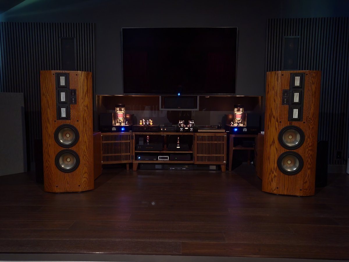

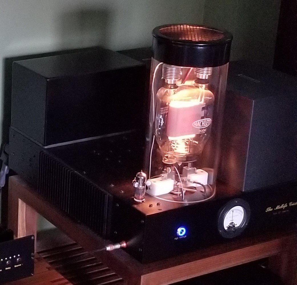

stuart Posted April 17 Report Posted April 17 7 minutes ago, Magz said: It's just my way of doing things. When I needed an amplifier for my stereo I could have bought a powerful, modern, reliable solid state unit, but instead I built a pair of transmitter valve amplifiers that run at 2.3kV on the output tube anode and terrify my wife. But the sound and looks are glorious! Im with you on the valve amps, so much warmer sound. Stuart. Quote
RobH Posted April 17 Report Posted April 17 8 minutes ago, stuart said: valve amps, so much warmer sound That's all the even-harmonic distortion. Quote
RogerH Posted April 17 Report Posted April 17 What we need now is a decent valve with an inbuilt LED instead of the overly hot heater. That way you get the glow but not the degrees C' temperature.. Great Idea. Roger Quote
RobH Posted April 17 Report Posted April 17 (edited) 20 minutes ago, RogerH said: What we need now is a decent valve with an inbuilt LED instead of the overly hot heater. Theres nowt new under the sun. Cold-cathode devices were common once Roger, but not much good for amplifiers. They were mainly switching devices (e.g. thyratron) or displays like neons or nixie tubes. Edited April 17 by RobH Quote

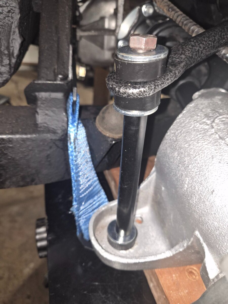

Magz Posted April 18 Author Report Posted April 18 I received the adjustable limit strap and it was really cumbersome to use for such a short length (too much material in too short a space) so I cut it and had my wife sew it up with fishing line (never knew you could put that through a sewing machine!) to make a 9" strap for test purposes. It seems to do the job effectively (see picture), so I ordered a pair of 9" PRP straps as the permanent solution. Quote

Z320 Posted April 18 Report Posted April 18 3 hours ago, Magz said: Sorry me Robert, with your attitude, and the way you present yourself, a textile strap is not your serious soltution? I would make a „cup“ from aluminium to lift or lower the upper or lower end of the shock absorber. Ciao, Marco Quote
Magz Posted April 18 Author Report Posted April 18 2 hours ago, Z320 said: Sorry me Robert, with your attitude, and the way you present yourself, a textile strap is not your serious soltution? I would make a „cup“ from aluminium to lift or lower the upper or lower end of the shock absorber. Ciao, Marco "Textile" straps made of nylon are the standard for limit straps, used extensively on many different vehicle types, especially for rugged off-road use. They can certainly handle the requirements for protection during maintenance on a lift. As a side benefit, they have a small bit of stretch to them, so they help avoid the sudden jolt of a hard stop fixture. I ordered black ones for the permanent installation in case the blue color bothers you... Quote
john.r.davies Posted April 19 Report Posted April 19 "Suspension limiting" or "Droop control" is an arcane feature of some competition cars' suspension. It's difficult to impossible to find any text that could allow you to design it, or tune it. What did you base your design on, and do you have a way to tune it? I've fitted it to the front suspension of my race Vitesse, using steel cable, but chose dimensions almost arbitrarily. I think it helps but would love to know better how it works! John Quote
Magz Posted April 19 Author Report Posted April 19 2 hours ago, john.r.davies said: "Suspension limiting" or "Droop control" is an arcane feature of some competition cars' suspension. It's difficult to impossible to find any text that could allow you to design it, or tune it. What did you base your design on, and do you have a way to tune it? I've fitted it to the front suspension of my race Vitesse, using steel cable, but chose dimensions almost arbitrarily. I think it helps but would love to know better how it works! John Not much of a "design", really. It just needs to prevent the CV axles from drooping to more than 28 degrees below the horizontal (Goodparts spec) while allowing full movement to the upper bump stop. I used the lower bolt hole from the old lever shock mounts and the bolt at the bottom of the rear sway bar end link as convenient, existing attachment points. Since I won't be off-roading the TR6, it's mainly meant to protect the CV joints from overextension when I have the car on my 2-post lift. I suppose I could "tune" it by varying the strap length or material, but I don't really see the point for my application. Quote

john.r.davies Posted April 19 Report Posted April 19 Ah! Less tweaking performance, more avoiding excess angulation. I suppose this would be a higher maitenance component than most, but that's no criticism. John Quote

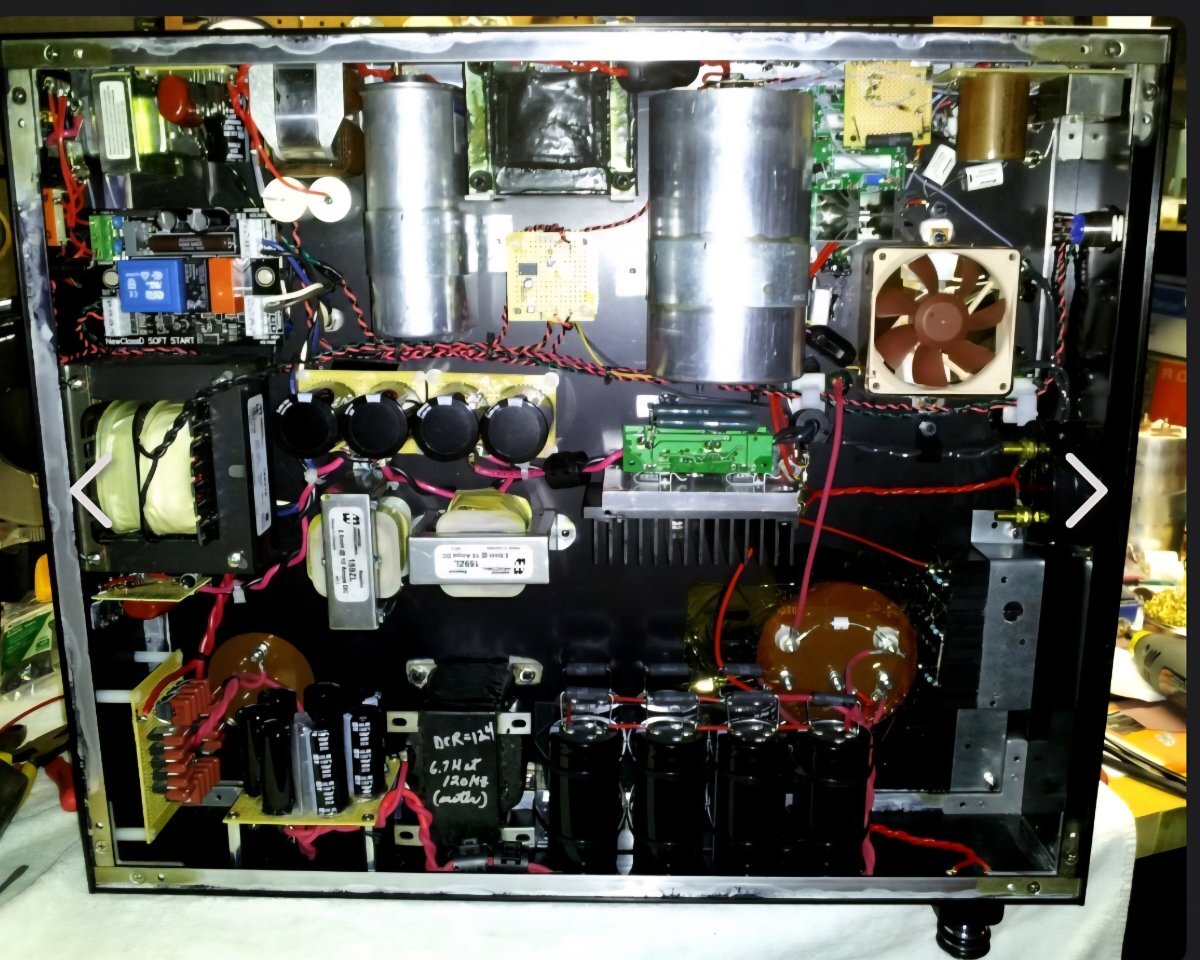

Magz Posted April 20 Author Report Posted April 20 16 minutes ago, harrytr5 said: Many, many years ago I built an amplifier from a set of plans and it never worked. My brother in law had a top secret job at the time in electronics and I asked him to have a look at it. I also built speakers from Kef kit 3s. He gave it to his apprentices and they found a few dry joints that I had made. Rookie error and never to be repeated so I am full of admiration with your Valve amps and speakers Thanks. Yeah, there was a lot of soldering to do, and tons of iron to mount! The amps weigh ~150lbs each, with each output transformer weighing in at 62lbs. Here's a shot of the underside of one amp. Quote

Andy Moltu Posted April 21 Report Posted April 21 If it's just to stop over extension on the 2 post ramp = why not but the lift arms (on the rear) beneath the trailing arms? Quote
