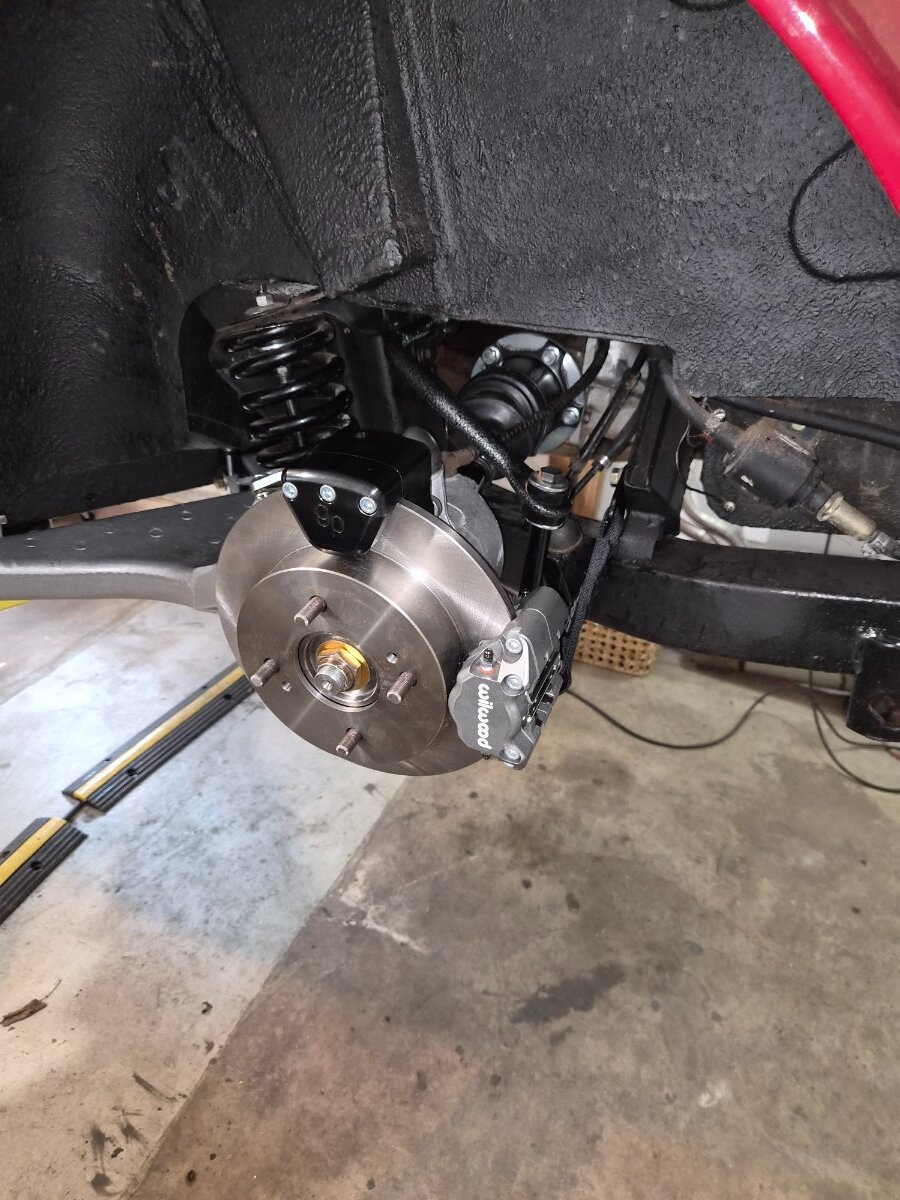

I appreciate you sharing your experiences. The lift issue is part of the story, but the other is that hitting a several inch deep pothole will slam the CV joints well past the recommended maximum angle, potentially damaging them. With the coilover conversion, there is nothing to stop them, other than the limit strap.

I have the Goodparts rear disc conversion on the race TR6 and have been very pleased with it.
Just finished up mine today. All I need to do is bleed them and put the exhaust system back on and I'm on the road again, with a completely revamped rear drivetrain and suspension!
Later in the year I'll start on the other end of the drivetrain with a supercharger and all the work associated with that!
