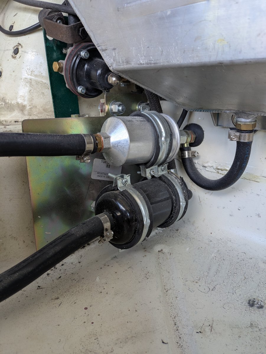

michaeldavis39 Posted April 24 Report Posted April 24 Most Bosch petrol fuel filters are 8-10 microns. Last year I was having similar problems to this gentleman until I replaced the Bosch filter for a Sytec bullet filter with a metal 100 micron fuel filter- was always number 3 injector too!. Anyway my injectors behaved after this change so I highly recommend doing this. Quote
zzzzdave Posted April 24 Author Report Posted April 24 Looked in tank, its spotless , air vent good and so is 12v feed to pump, need to check flow rate tomorrow. Just been out for 45 mins drive, stood in many traffic queues getting warm never flackered . just found this on google search "Placement: Fine filters (like 10-micron units) are almost always placed after the fuel pump because they require pressure to push fuel through the dense media. Coarser filters (e.g., 100-micron) are used before the pump as "pre-filters" to protect the pump itself without restricting gravity-fed flow. " Michaeldavis39 this stacks up with what your saying , ill keep at it over the weekend, then i think ill change filter arrangement , with sytec bullet pre pump, and high pressure bosch filter after pump and see if that gives me consistency Quote
Waldi Posted April 24 Report Posted April 24 (edited) Dave, Opinions about the best filter set-up differ. I use a large Sytec suction filter with fine paper element inside. No discharge filter. Note the original PRV and the MU both have a coarse inlet strainer. I preventively replaced the filter after approx. 5 years in operation, not because I had issues. The number is Sytec SSF2012. I prefer to protect my pump, a course filter will give less protection. Others use a discharge filter or a combination of both and happy with that. Succes, Waldi Edited April 24 by Waldi Quote
michaeldavis39 Posted April 24 Report Posted April 24 I forgot to mention- Bosch pump will usually have its own built in filter which many dont realise. Quote
stuart Posted April 24 Report Posted April 24 I always fit the really big Sytec filter pre pump and that’s it Stuart Quote
Chris Hale Posted April 25 Report Posted April 25 9 hours ago, stuart said: I always fit the really big Sytec filter pre pump and that’s it My set up has been like that for over thirty years with no issues Quote

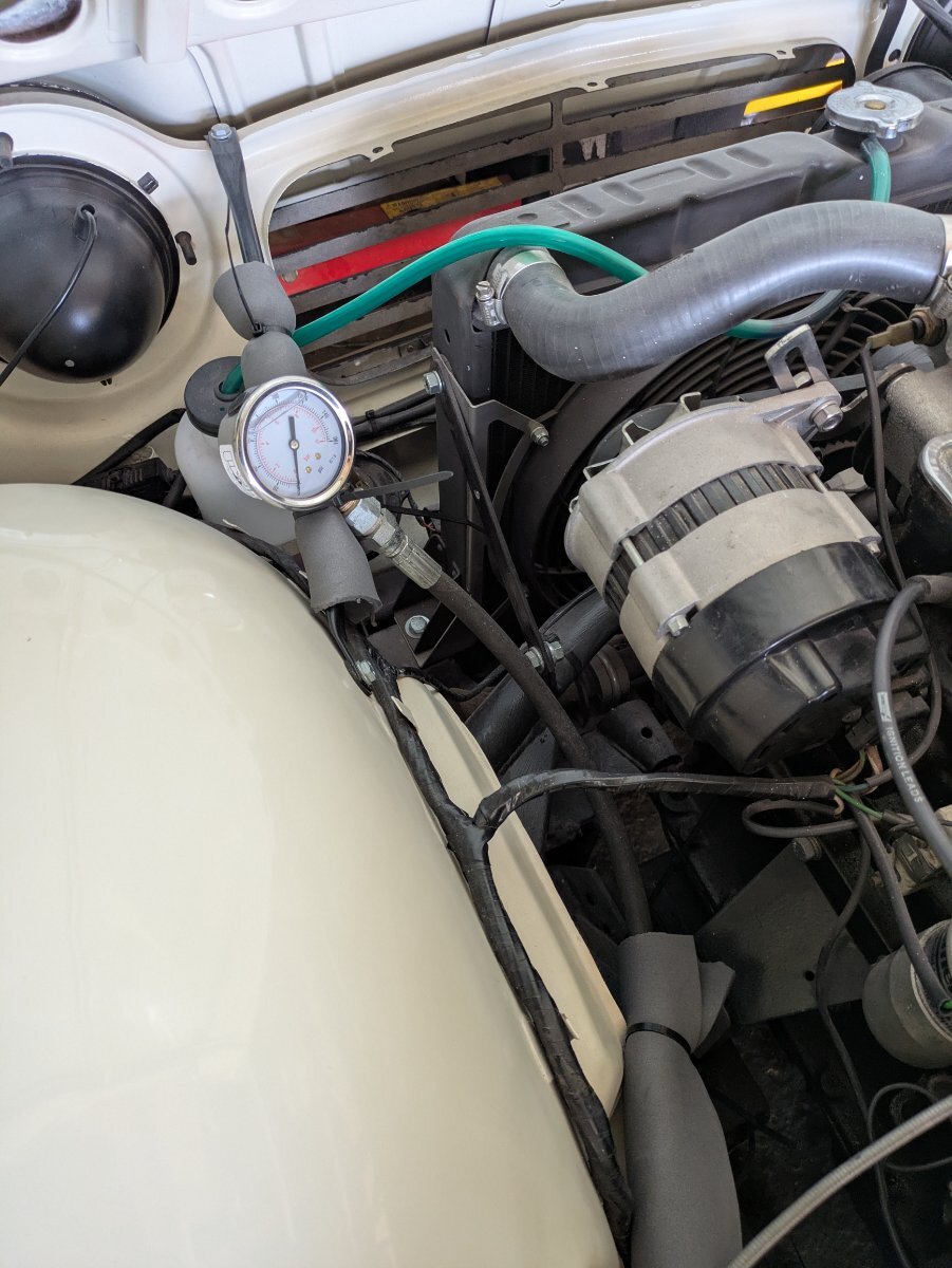

zzzzdave Posted April 25 Author Report Posted April 25 So just been out for a run, not lost any cylinders , but the fuel pressure is not rock steady as it should be Hopefully these links work, the top one is TRTrader reel showing rock steady fuel pressure, the bottom link is video of my fuel pressure after a run, wavering pressure https://www.facebook.com/reel/1116593658443881 https://photos.app.goo.gl/3pMXtV4LWWjGbBKe7 Its either pump or PRV , My thinking is the pump is on its way out , PRV is 18 months old so assumption is it should be ok Thoughts Quote
Waldi Posted April 25 Report Posted April 25 Looking at the 2nd video I think this is related to not optimal electrical supply to the pump. With idle rpm there is almost no fuel consumption, but the pump will react immediately on a lower voltage. This can cause the variations in pressure. I suggest measuring the voltage over the pump connections, and compare with battery voltage. Are you still on the (low rated) original Lucas alternator? Also, poor contacts (spades or nuts not firm, corrosion) can cause a voltage drop. The electrical current to the Bosch pump is high (approx. 9-12 A depensing on pump type) so any poor connection should be avoided. Waldi Quote

zzzzdave Posted April 27 Author Report Posted April 27 volts is good to the pump, no issue with relay , earths are good, have ordered a new Sytec pump see if that resolves it, Dave Quote
PodOne Posted April 27 Report Posted April 27 4 hours ago, zzzzdave said: volts is good to the pump, no issue with relay , earths are good, have ordered a new Sytec pump see if that resolves it, Dave Agree with Waldi I would run a 12v supply and earth direct to the pump to rule the wiring out and go from there. PRV although newish may still be sticky or as you say the pump may be on the way out. Quote
