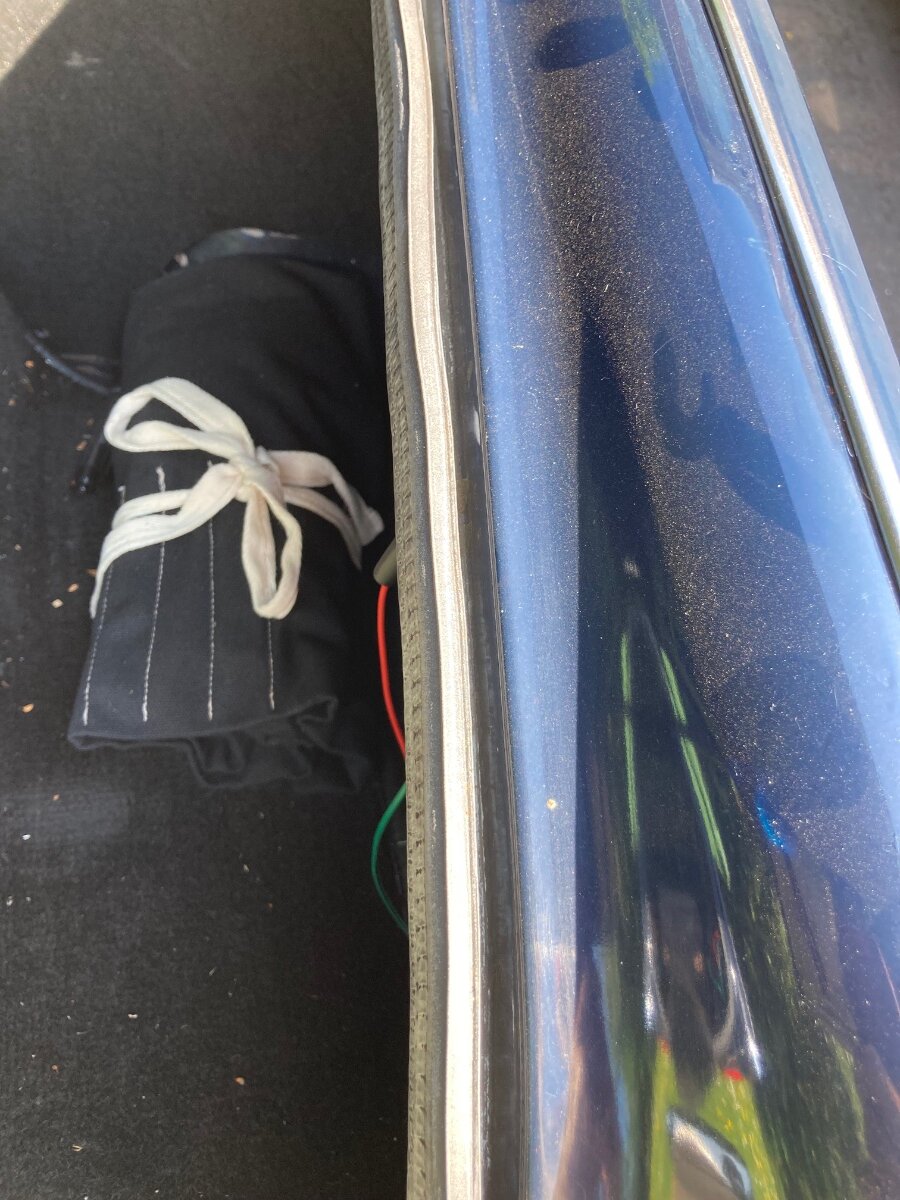

stuart Posted May 25 Report Posted May 25 1 minute ago, Philsy said: I’ve just bought and fitted the Rimmer seal to my TR5 and now the boot won’t close. Any advice, please? Throw it in the bin and buy the one I recommended further up this thread. .https://www.woolies-trim.co.uk/p-1928-small-boot-seal. Stuart. Quote
Philsy Posted May 25 Report Posted May 25 5 minutes ago, stuart said: Throw it in the bin and buy the one I recommended further up this thread. .https://www.woolies-trim.co.uk/p-1928-small-boot-seal. Stuart. OK, thanks. Interestingly, the Rimmer one seems to have the same profile as the one Iook off, which looked ancient, so I assumed the new one was correct. Quote
stuart Posted May 25 Report Posted May 25 7 minutes ago, Philsy said: OK, thanks. Interestingly, the Rimmer one seems to have the same profile as the one Iook off, which looked ancient, so I assumed the new one was correct. Oh it will have but it wont be made to the same spec of material. Also you would find even if you could close the boot after not a very long time it would roll off the lip along the bottom and hang out of the shut. Stuart. Quote
Rob Salisbury Posted May 25 Report Posted May 25 Hi , Read my post from May 2nd in this thread, ... it will eventually allow the boot to close and you need to glue the bottom section in place, .... just give it time ...... about a year or so!! Cheers Rob Quote
Philsy Posted May 26 Report Posted May 26 On 5/25/2026 at 2:32 PM, Rob Salisbury said: Hi , Read my post from May 2nd in this thread, ... it will eventually allow the boot to close and you need to glue the bottom section in place, .... just give it time ...... about a year or so!! Cheers Rob Thanks, I’ll try weighing it down. Problem is, I want to get out driving while it’s good weather! 😎 Quote
Peter V W Posted May 27 Report Posted May 27 As stated above, put in the bin. use a slimmer rubber. Quote
Rob Salisbury Posted May 27 Report Posted May 27 If it's any consolation back in the early 70's I had a genuine Triumph one (in a Jaguar/Rover/Triumph plastic bag) over the counter at Lancasters in Kingston and that gave exactly the same problem!!, it did last along time though. Cheers Rob Quote
boxofbits Posted May 28 Report Posted May 28 Hi all This one solved my problem of the boot staying proud and not closing. I think RogerH also bought one and as far as I know it sorted out his similar issue. By I’m doing the London to Brighton run on Sunday (is anyone else) so trying to solve a long term exhaust leak between from pipe and steel 4 into 2 manifold. By the way, is Holts Firegum still the best exhaust assembly paste? https://phoenixtrim.co.uk/02-draught-excluder-br-self-grip-br-dx-87-n-br-price-per-metre-423-p.asp Quote
RogerH Posted May 28 Report Posted May 28 Hi Kev, good luck on your repairs and run on Sunday. Yes, that seal sorted my boot lid issues. Roger Quote
boxofbits Posted May 28 Report Posted May 28 1 hour ago, RogerH said: Hi Kev, good luck on your repairs and run on Sunday. Yes, that seal sorted my boot lid issues. Roger Thanks mate should be a fun drive. A visit to Chiddington Castle is an official stop en-route, before Madeira Drive in Btn.👍 Quote
