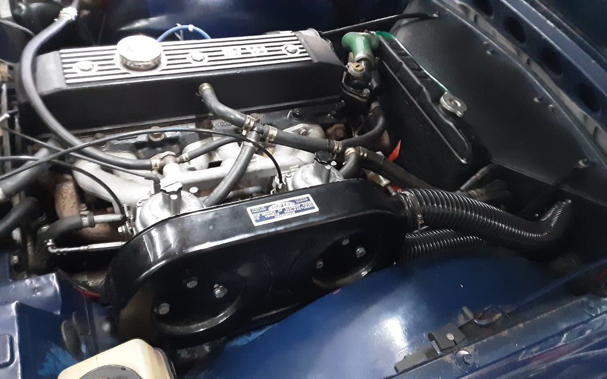

harlequin Posted April 28 Report Posted April 28 On 4/25/2026 at 12:48 PM, stuart said: TBH if you already have a full shield then just a duct to the carbs would be ideal. Stuart. This is what I have on my TR6 which has a TR250 air box George Quote

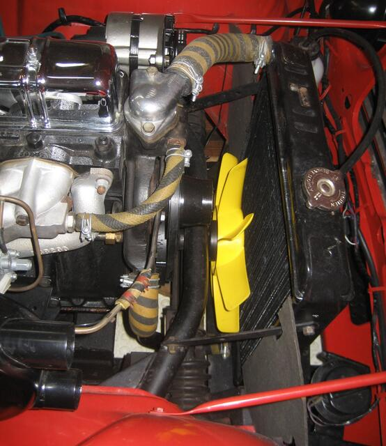

trchris Posted April 28 Author Report Posted April 28 Hi George yes l still need to fit hoses as you have ( hoses on shelve ) l have seen that the side shields are extremely cheap so may get and try and maybe use as template for a pair of stainless ones l will still fit the air box hoses. HI Tom nice under bonnet ( hood to you guys ) are your shields metal ? Chris Quote
harlequin Posted April 28 Report Posted April 28 10 minutes ago, trchris said: Hi George yes l still need to fit hoses as you have ( hoses on shelve ) l have seen that the side shields are extremely cheap so may get and try and maybe use as template for a pair of stainless ones l will still fit the air box hoses. HI Tom nice under bonnet ( hood to you guys ) are your shields metal ? Chris I was told that Triumph used fibreboard for the shields to prevent the radiator being damaged in a low speed front end shunt. Ofcourse also being cheap helped with the decision. George Quote

Tom Fremont Posted April 29 Report Posted April 29 21 hours ago, trchris said: HI Tom nice under bonnet ( hood to you guys ) are your shields metal ? Chris Hi Chris, No, they're fibreboard as per original supposedly. Truth be told neither this one nor my driver see much rain which would likely distort these deflectors in short order - probably why I never saw an original set! They sit comfortably albeit loosely against the wheel arches while clipped to the radiator. I suppose TRIUMPH wanted something soft against the painted arches; otherwise a stiffer phenolic or other plastic might have been used. Quote
