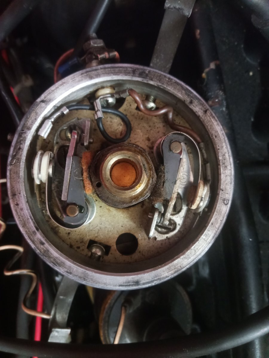

earckens Posted May 23 Author Report Posted May 23 (edited) 25 minutes ago, trchris said: Well I’m confused about two sets of points ? However you only need to loosen the retaining screw slightly so the points cannot move until using a screw driver, adjust to desired gap and do up the screw checking gap afterwards Chris The distributor has two sets of points, opposite the rotator. I have forgotten what its purpose is, I may find out by tracing the wiring. But I now did set the points at 0.016" (two spacers, 0.013" and 0.00315" conbined). They were too close (I guess, like 0.012"), but I have driven the car like that for several years; I guess it will now run even better :). Edited May 23 by earckens spelling Quote

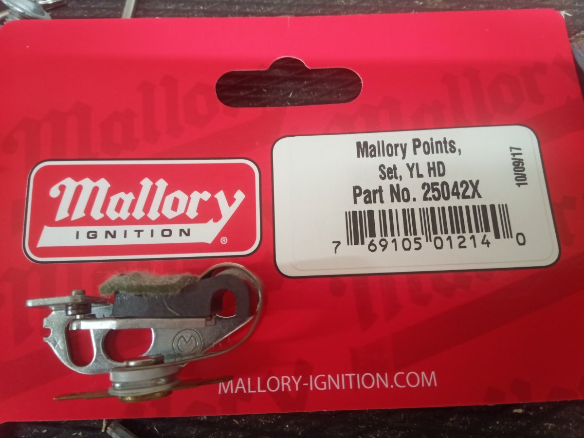

RobH Posted May 23 Report Posted May 23 (edited) The gap you quoted is for a Lucas distributor and suits the shape of the cam used by Lucas. Is your dizzy a Mallory? If so the cam is a different shape and I have seen a figure of .022 - .024 inches quoted for those and the setting process is rather more complicated: https://www.jalopyjournal.com/forum/threads/ignition-tech-proper-method-to-set-gap-on-a-dual-point-distributor.459917/ https://www.mgexp.com/forum/mgb-and-gt-forum.1/mallory-dual-point-dwell-and-gap.1577952/ Edited May 23 by RobH Quote
earckens Posted May 23 Author Report Posted May 23 @RobH well I am not sure, tomorrow I post a picture of my distributor. But in any case the setting for this dual point distributor is more complicated than I imagined. Thank you RobH. I am sorry to all of you here for not having been unambiguous in my OP. Quote

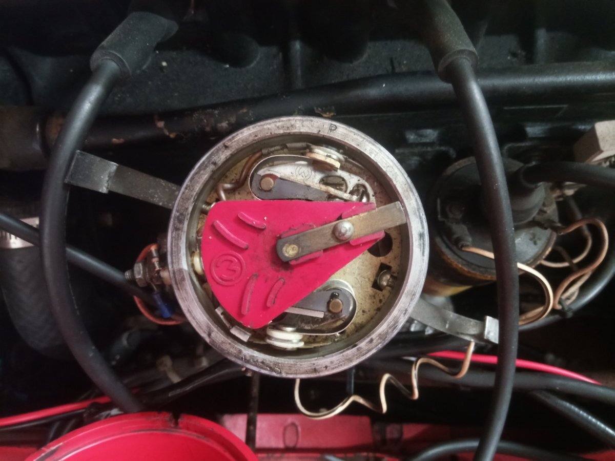

earckens Posted May 23 Author Report Posted May 23 Why wait for tomorrow? It is a Mallory distributor. Stupid question: does the distributor turn clockwise or anticlockwise. Quote
RogerH Posted May 23 Report Posted May 23 Hi Erik why oh why have you got a mallory dizzy??? Roger Quote
RobH Posted May 23 Report Posted May 23 (edited) The direction is set by the drive gear so it is anti-clockwise the same as the Lucas ones. Mallory have a reputation for very good quality and the dual-points should give very long service between adjustments. You can see from that photo that the cam is rather different shape from the Lucas one - more of a circle with flats on it. Edited May 23 by RobH Quote
