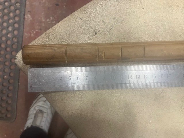

I did this some time ago, when I was fitting a new tank.
First 5 litres measures................ 45 mm
Second 5 Litres measures...............35mm
Third and all subsequent 5 litres add 27/28mm.
Just be careful plunging a dipstick into the tank, make sure to miss the sender arm or
you can inadvertantly bend it.
