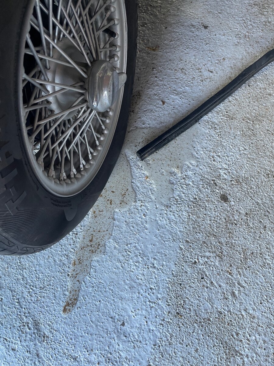

A car that spits in your ear must be a little disconcerting!!! 🤣

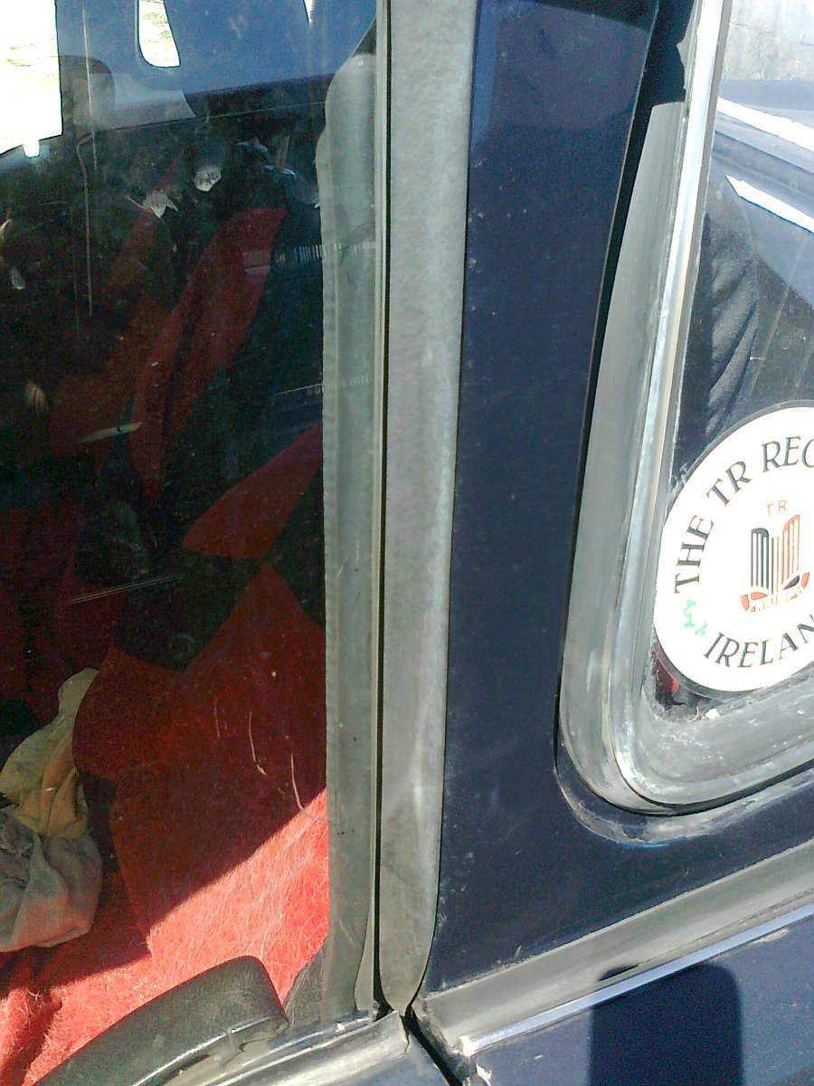

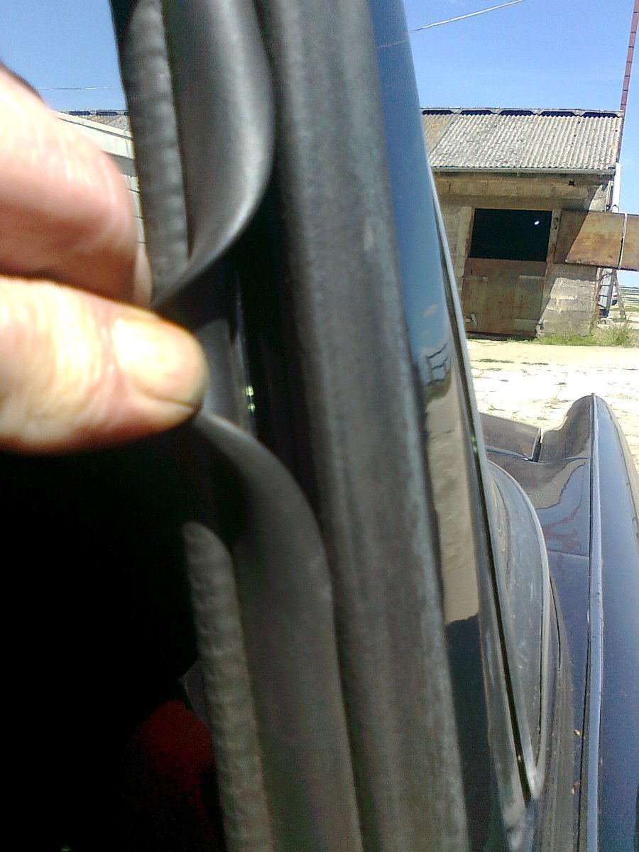

Thats a good advert for using the flap seal rather than the tube type, then any water drains down behind the flap.
Sounds like a good plan. Where do you get yours from Stuart?
From here https://www.woolies-trim.co.uk/p-1285-door-seal
Though you will notice that I also use the original Surrey frame side seal in the channel as well, this helps to give a better seal against the rear of the window. Items 2 and 4 here https://www.moss-europe.co.uk/en-gb/surrey-top-fittings-tr4-4a-1961-67-tr24--26--03--02
