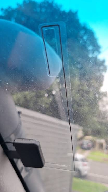

PriceLes Posted April 25 Report Posted April 25 56 minutes ago, RogerH said: Under the dash is not the best place as it will be surrunded by metal so the reception may be awful. Can DAB use the windscreen tape style aerials. Roger The Pioneer CarPlay unit I installed in my GTI has the DAB aerial on the inside of the windscreen, perhaps on a smaller car like the TR it could be placed on the rear window. ( It is a wire loop on a clear decal so not to intrusive visually) Quote
PriceLes Posted April 25 Report Posted April 25 Not exactly retro looking but something like this. (Internet picture) Quote

PodOne Posted April 25 Report Posted April 25 I have a stick on DAB Ariel fitted to the screen behind the rear view mirror. Very unobtrusive the wire can be hidden behind the windscreen rubber and then down the pillar trim. Works very well but a waste of time as the radio is not worth listening to with the top down! Andy Quote

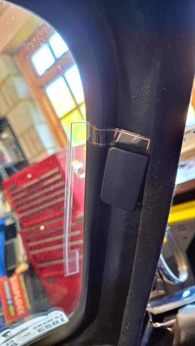

Sixeighter Posted April 26 Author Report Posted April 26 Thanks for all the comments. I went with a windscreen mounted antenna. Problem in a TR6 is finding a ground for the ground plane as the A pillar is covered in vinyl. I made a small plate for the ground plane to stick to them soldered a cable to the plate and connected to a ground. Works well but antenna on windscreen is not entirely unobtrusive. Quote

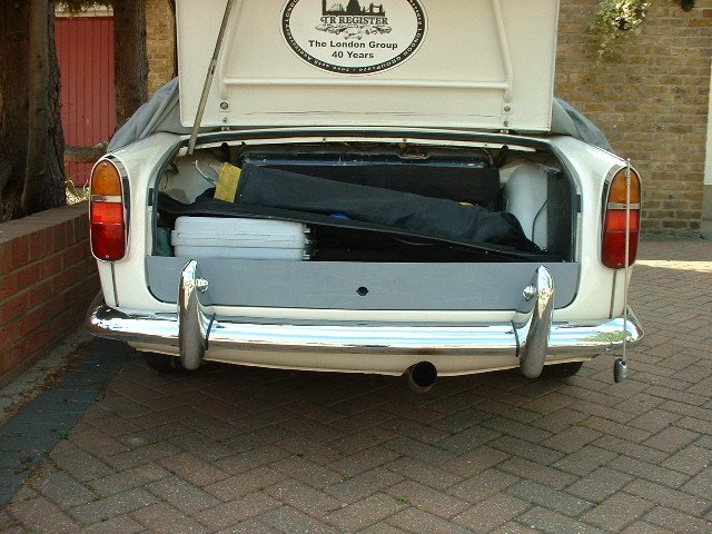

RogerH Posted April 29 Report Posted April 29 I had the same decision to make and decided I also didn't want a hole in the bodywork. So I positioned the aerial on the rear bumper. The little plastic support that comes with the aerial fits into the top light cluster screw hole. The aerial is a VW camper vam 'A' post fitment Roger Quote
wheeler Posted May 1 Report Posted May 1 I have a Pioneer CA-AN-DAB.001 DAB aerial mounted on the windscreen only about 6 inches long. Aerial connected to a Pioneer DEH-S730 DAB radio. I get pretty good DAB reception only rarely is the signal lost. Bill Quote

CK's TR6 Posted May 2 Report Posted May 2 My aerial was a ground plate then a single wire stick on thing to the windscreen. I mounted the ground plate to the body up behind the dash, cut the single wire and soldered on a very thin wire that was insulated. Ran that wire out to the door seal, up the inside of the doorseal and back down inside the A post outer seal. Here in the states we have digital FM (aka HD radio). aerial works great. can't be seen unless you look directly down inside the A post outer seal. Quote
