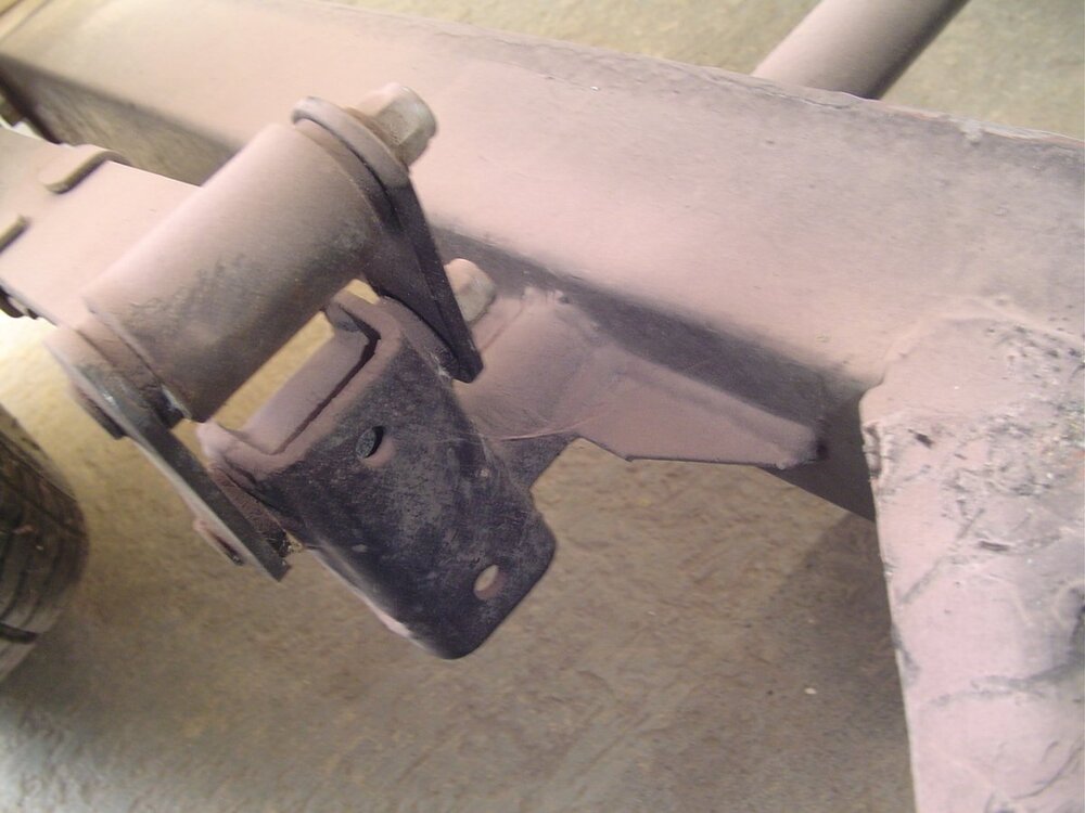

SLongley Posted April 26 Report Posted April 26 I've had a failure that looks like fatigue to the rear cross member that holds the rear leaf spring shackles to the chassis. N/S has snapped and ripped right off the chassis. Anyone had experience of repairing this area? Can it be sleeved internally and welded back on safely or does the whole crossmember need to be replaced? Thanks Quote
Lebro Posted April 27 Report Posted April 27 Yep, a common thing to do to re-enforce that tube, best done prior to fracture ! Bob Quote

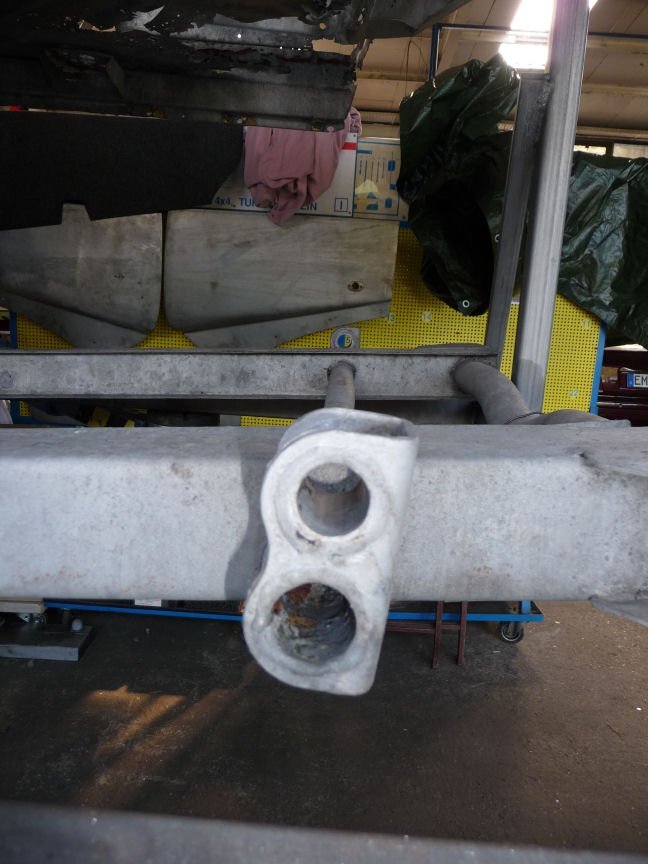

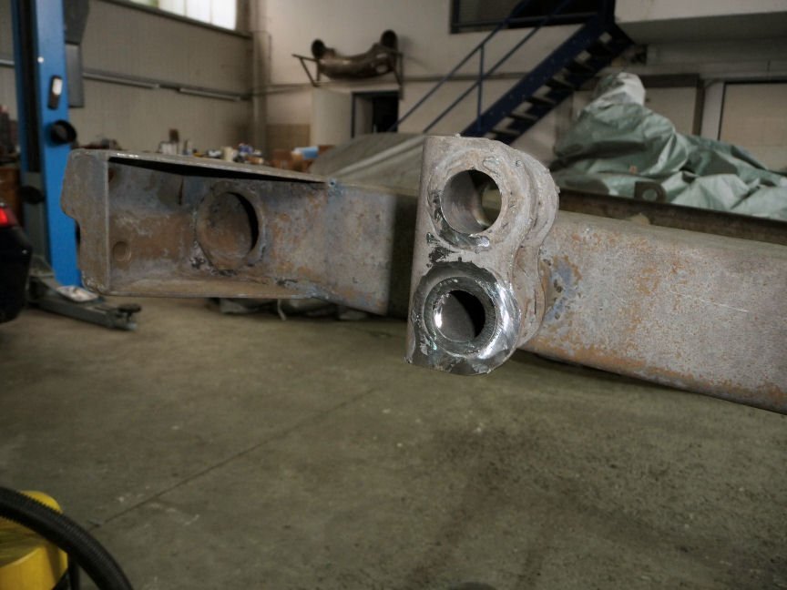

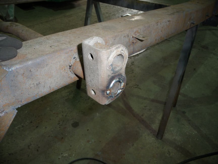

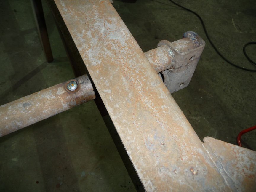

Black Forest TR3A Posted April 27 Report Posted April 27 I have to admit that mine "only" was bent out of position on the left side... Quote
iain Posted April 27 Report Posted April 27 All too common a weakness and a nice demonstration of how to strengthen/ repair. Quote

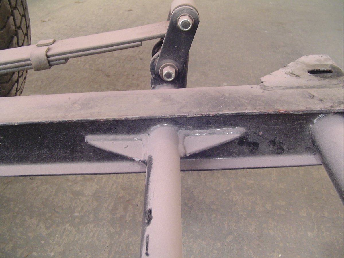

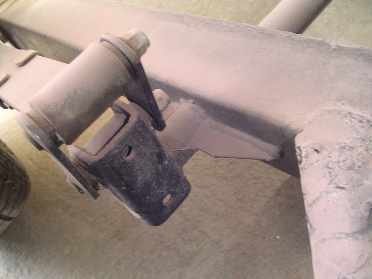

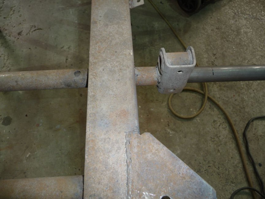

stuart Posted April 27 Report Posted April 27 Its always been a recommended mod also its good to fit a couple of triangles as well one each side to further prevent twisting. Stuart. Quote

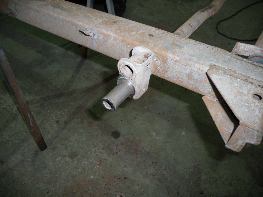

Dic Doretti Posted April 27 Report Posted April 27 I used the handle of an old trolley jack to strengthen the chassis tube, it was a nice tight fit. I like the idea of triangulating the tube, never thought of that. Cheers Richard Quote
Black Forest TR3A Posted April 27 Report Posted April 27 6 hours ago, stuart said: ... also its good to fit a couple of triangles as well one each side to further prevent twisting. Looks very nice and neat, Stuart! Wish I had known that - but I hope I get away with just the tube... 😇 Quote
John Morrison Posted April 28 Report Posted April 28 Repaired this on My TR4 after one side failed, simple, obvious repair thats laste at least 15 years now. John. Quote
Ian Vincent Posted April 28 Report Posted April 28 The triangular fillets is a reinforcement recommended by Revington. Easy enough to do. Rgds Ian Quote
BlueTR3A-5EKT Posted April 28 Report Posted April 28 My first TR2 had a broom handle pushed in on one side. It worked fine for a couple of years. Quote

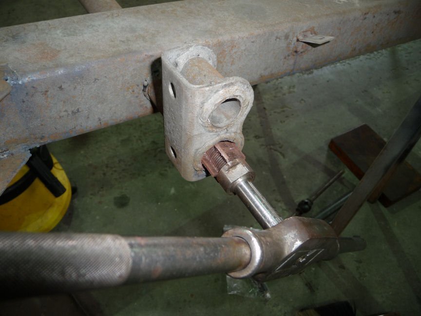

BlueTR3A-5EKT Posted April 28 Report Posted April 28 On 4/27/2026 at 8:25 AM, Black Forest TR3A said: A story in pictures... 😎 You needed a water based machining and cutting lubricant on that reamer. I use Anchor Lube. ‘Does what is says on the tin’ https://anchorlube.com/product/anchorlube/ Quote
