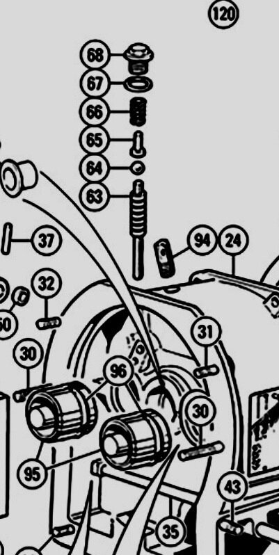

BlueTR3A-5EKT Posted April 27 Report Posted April 27 I don’t think the issue is the filler plug. could be wrong….. I read in order to clean/replace operating valve just removed transmission cover on my TR4 to get at the operating valve plug. The 7/16 plug was rounded and I've made it worse. Tried mole grips and ( careful) heat which is the limit of my engineering skill. Thats the steel capped hex plug. Item 68 in this pic. Quote

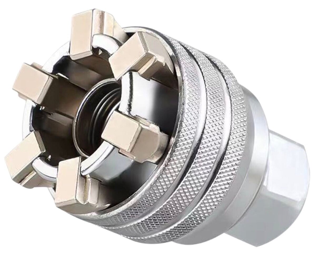

Z320 Posted April 28 Report Posted April 28 (edited) Hi Rich, I don't know how they are called at the UK, at Germany they are called "Linksausdreher Nüsse" Try "extractor nut set", aviable for a nice price. They are made for example for a 1/2" drive but better you buy a set which also have a hex head. So you can also use them with the 1/2" drive and on limited space with a spanner. Ciao, Marco Edited April 28 by Z320 Quote
rcreweread Posted April 28 Report Posted April 28 21 minutes ago, Z320 said: Hi Rich, I don't know how they are called at the UK, at Germany they are called "Linksausdreher Nüsse" Try "extractor nut set", aviable for a nice price. They are made for example for a 1/2" drive but better you buy a set which also have a hex head. So you can also use them with the 1/2" drive and on limited space with a spanner. Ciao, Marco Marco - thanks for the info - I've found some links here in the UK here: https://www.google.com/search?q=Linksausdreher+Nüsse+extractor+nut+set&rlz=1C1VDKB_enGB1145GB1148&oq=Linksausdreh Looks a nice piece of kit Cheers Rich Quote
