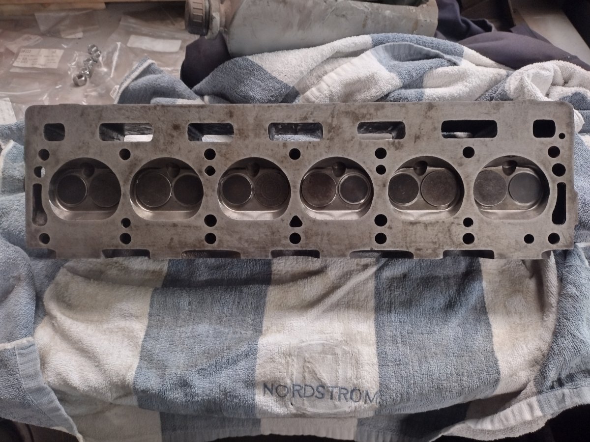

Paul Hig Posted May 1 Report Posted May 1 10 hours ago, Rob Salisbury said: As Mike says if you run with a CP cam then you will be disappointed running carbs, get a fully refurbished Pi system, distributor etc and if it has a TR4A diff (3.7 to 1 ) the car will go like stink!! or put a 3.45 to 1 diff in for a slightly more relaxed drive. If you've got a 4A body then the right hand front inner wheel arch will have to be "adjusted" to accommodate the Pi plenum ( a large hammer and a big round dolly works here!!). Alternative way to go would be Webers but that's a whole different game and you'd have similar costs. Don't forget to fit a fuel cutout switch if using a Pi pump If you really have a 5 or 6 chassis then fitting the 6 pot will not present too many problems. I wouldn't down the engine "upgrades" route (apart from hardened exhaust valve seats), fully refurbished the CP 6 pot will be great. Cheers Rob Not sure you can fit hardened exhaust valve seats to early CP enginges due to the size of the exhaust valves (not enough meat in the head to cut in new seats) Just had my engine rebuilt and hardened seats were not possible, so continuing with lead replacement addative Quote
Rob Salisbury Posted May 1 Report Posted May 1 Chris Witor of the Triumph 2000/2500/2.5Pi Register probably knows just about all there is to know about Triumph 6 pot heads, so he's the guy to ask, but I used to have a '73 2.5Pi saloon (MG series engine number) and had no problem with the fitting of hardened exhaust seats, maybe your head had already had seats fitted and replacing those would be difficult or just unreliable. Quote
jerrytr5 Posted May 1 Report Posted May 1 Don't the valve seats only need doing on inlet or exhaust, not both? Can't remember which, or did I imagine that? A bit of careful crank polishing just to remove casting flash & balancing is worth doing. You might want to do the same with con rods - something you can do with kitchen scales. You'll probably find quite a variation in weights. Port match the head & manifolds & exhaust downpipe if using cast manifold. Jerry Quote
michaeldavis39 Posted May 1 Report Posted May 1 (edited) Hardened seats for exhaust only, had my early new old stock head done no problem. Some machine shops fear doing damage to the head but that doesn't mean it cannot be done if careful. Edited May 1 by michaeldavis39 Quote
DRD Posted May 1 Report Posted May 1 4 hours ago, michaeldavis39 said: Hardened seats for exhaust only, had my early new old stock head done no problem. Some machine shops fear doing damage to the head but that doesn't mean it cannot be done if careful. My CP head was fitted with hardened valve seats, no problem. Quote
Kevo_6 Posted May 2 Report Posted May 2 9 hours ago, DRD said: My CP head was fitted with hardened valve seats, no problem. Same here, no problems. Quote
