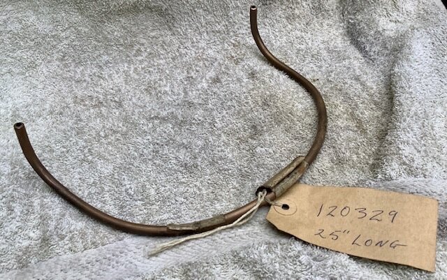

If it is push fit connectors on your H6 carbs then I have a new unused link pipe that goes between the two carbs. Item is pre shaped not the straight bit of pipe the specialists sell.   Pt no 120329    Yours for £20.00 plus postage.
See attached photo of what I have.

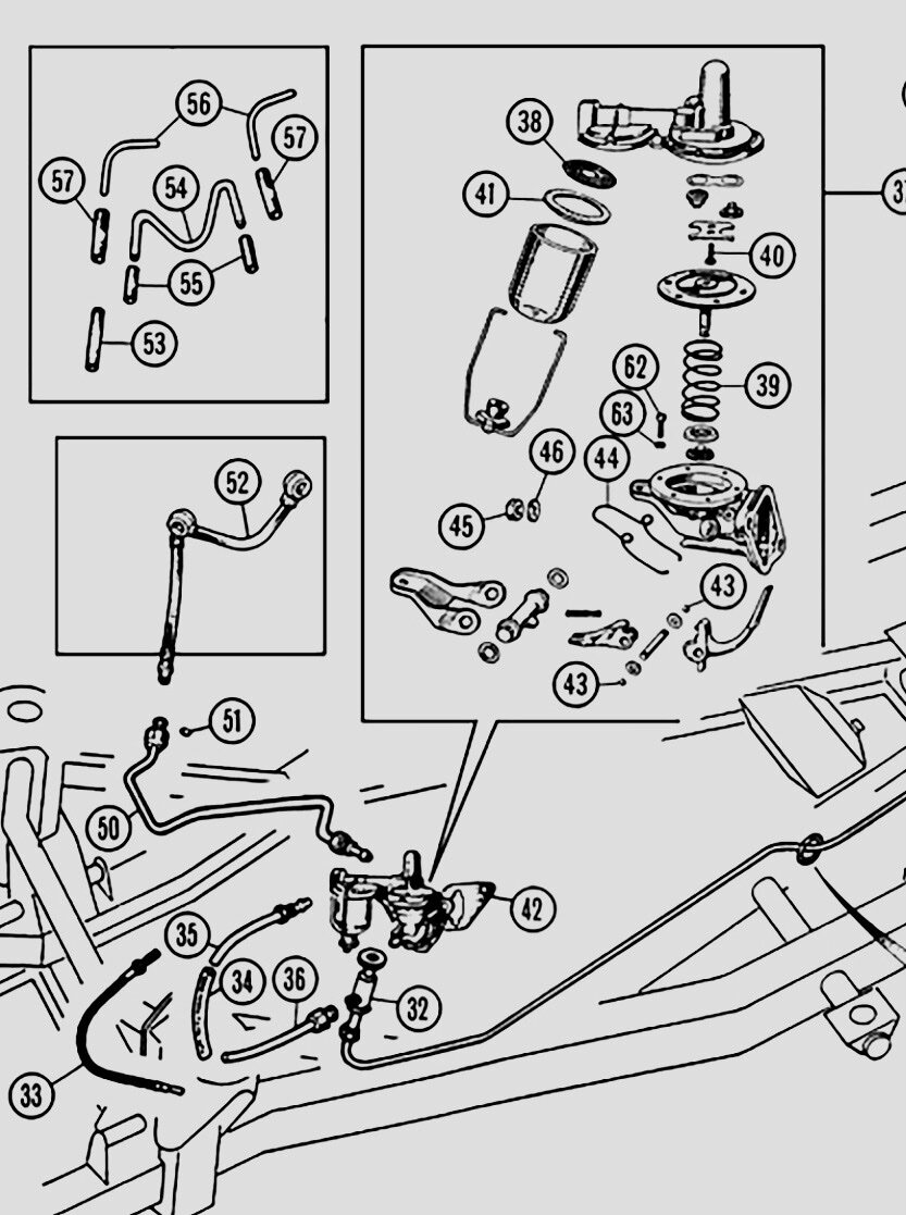

  Item 54 in this pic.
Link.  https://www.moss-europe.co.uk/en-gb/fuel-tank-pipes-pump-tr2-3a-1953-62-tr24--20--08--01

Good shout, takes a while to bend the pipe just right to suit!
