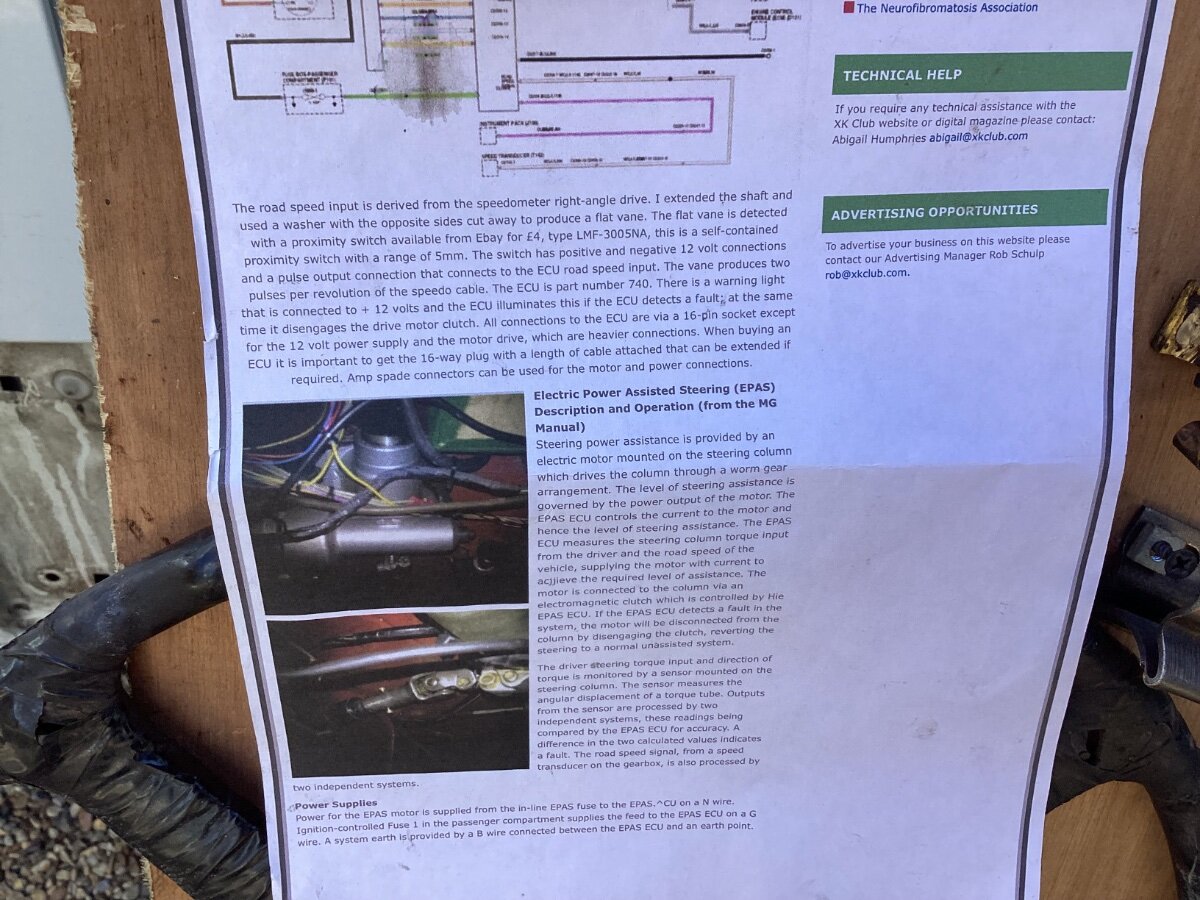

had17462 Posted May 4 Report Posted May 4 Hi ,I have fitted two made up from mgf motor and ecu but they was for xk150 and now helping someone fitting one to a 120 but changing to rack and pinion I am no mechanic but find it nice and easy but had great instructions from jag guru Rod shears who also gave me the wiring diagram etc the bulkhead bracket needs beefing up like it does on the Triumph range but transforms the car for me but like I said that was a much heavier car Nick Quote

Malbaby Posted May 4 Report Posted May 4 (edited) 12 hours ago, had17462 said: Hi ,I have fitted two made up from mgf motor and ecu but they was for xk150 and now helping someone fitting one to a 120 but changing to rack and pinion I am no mechanic but find it nice and easy but had great instructions from jag guru Rod shears who also gave me the wiring diagram etc the bulkhead bracket needs beefing up like it does on the Triumph range but transforms the car for me but like I said that was a much heavier car Nick Hi Nick....I am in the process of modifying an MGF EPAS for my TR4A.....Could you post some more pics [or website] of your instruction sheet re the wiring etc. Edited May 4 by Malbaby Quote
