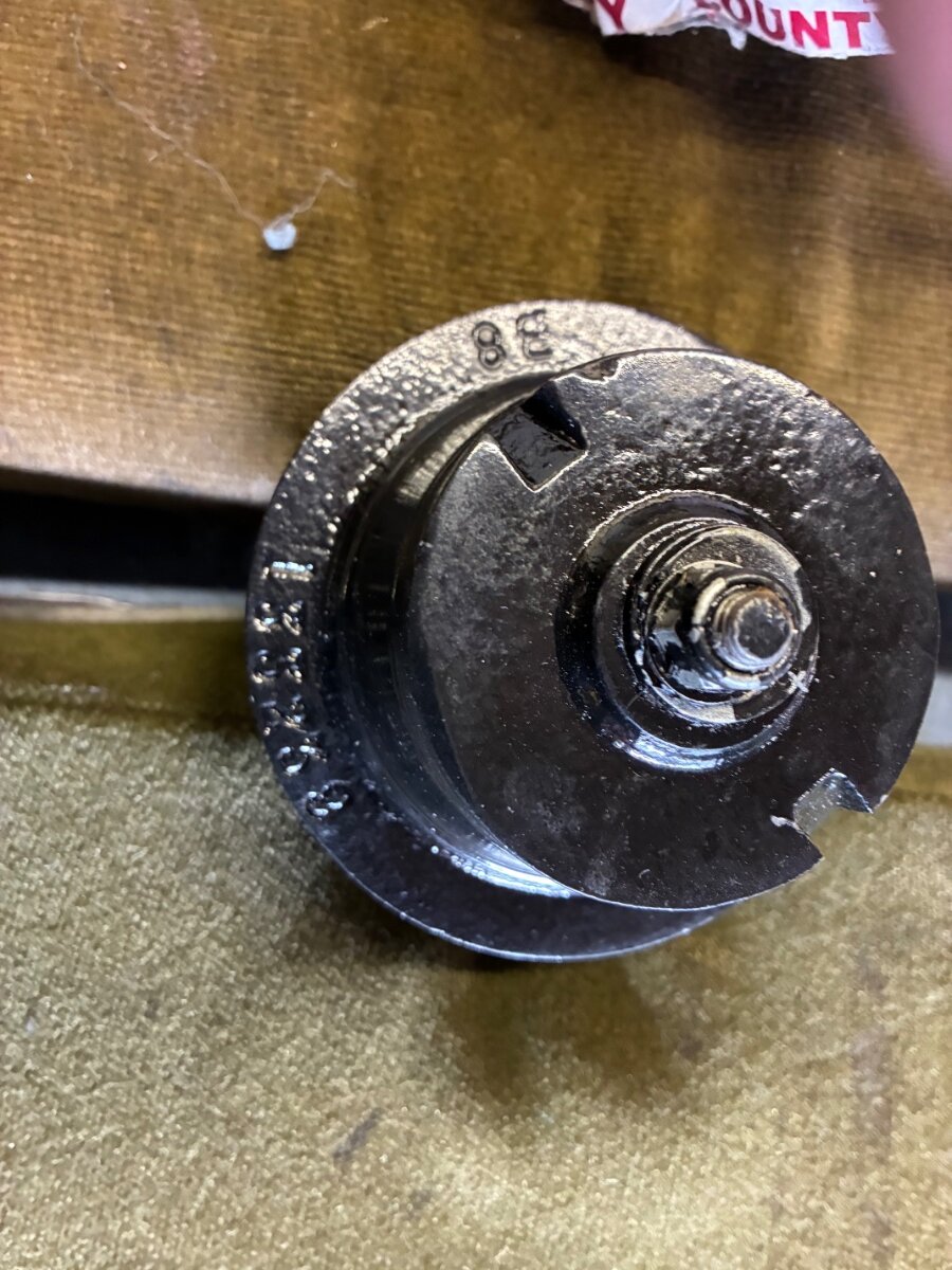

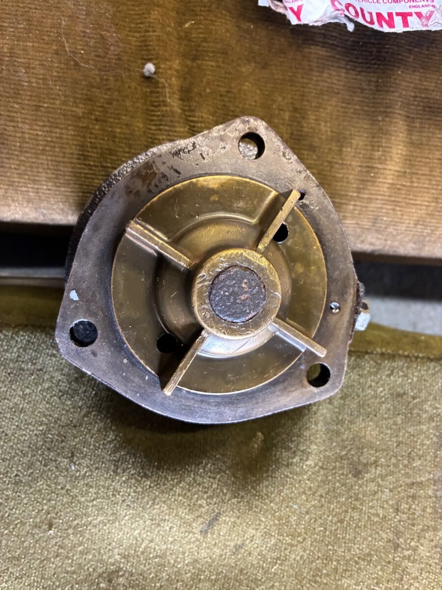

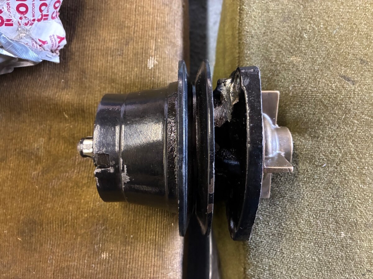

heckler Posted May 4 Report Posted May 4 This is an original 69 6 water pump with bronze impeller. Pics before refurb by EP services 2 weeks ago .Paul is very helpful to deal with .£93 Chris Quote

heckler Posted May 5 Report Posted May 5 You can see the plug for the grease nipple on the right in the impeller end on pic. EP services will recondition non original pumps as well . Chris Quote
