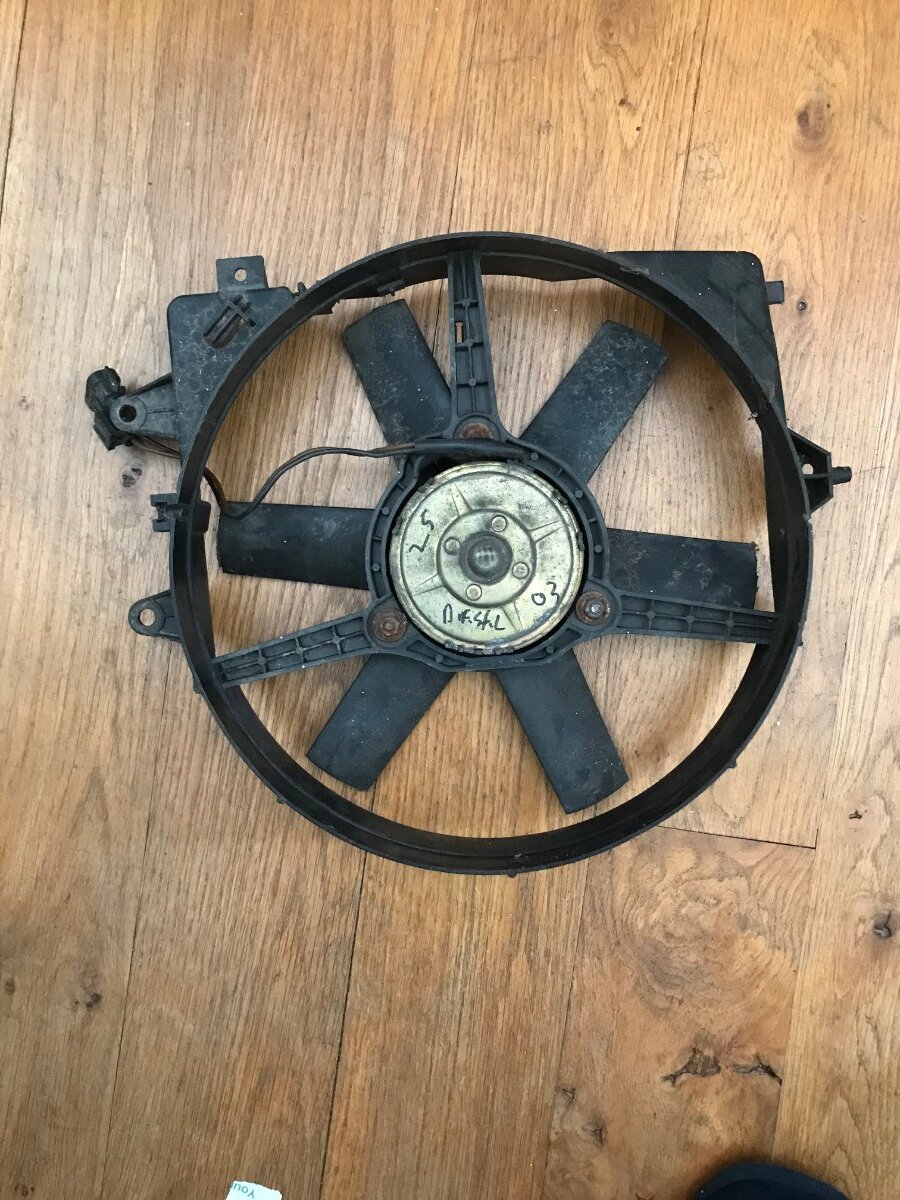

Charlie D Posted Thursday at 10:23 AM Report Posted Thursday at 10:23 AM (edited) On my 3A I made my own pusher system using a second hand fan from Ebay (I believe it was from some Ford 2.5 diesel and cost about £15 or so.) I bolted two bits of 1 1/2" square section wood to each of the radiator side supports ( to space the fan away from the rad.) and put a couple of cross pieces of flat 1/8" x 1" between them. I screwed the fan surround to these cross pieces. Used a thermo switch in the rad hose plus a manual switch (through a relay) on the dash. Nearly 6000 miles with no problems. EDIT: It was actually from a Rover "Fan Cowl & Motor Assembly RH - PGF100760 - MG Rover" I discarded the cowling and attached it using the three motor fixings. Edited Thursday at 02:16 PM by Charlie D Quote
