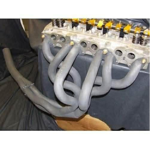

TRTOM2498PI Posted Wednesday at 10:02 AM Report Posted Wednesday at 10:02 AM I think he has problems elsewhere, based on the above. 1. Is it a new engine ? I run this competition exhaust manifold, with zero coating or anything wrapped around the tubes, and have driven in many climates abroad, and has sat in traffic, without any issues whatsoever. Quote

Z320 Posted Wednesday at 01:01 PM Report Posted Wednesday at 01:01 PM Exhaust manifold and exhaust pipes are not made to be wrapped and get hottern than needed. Browse the internet and find examples very easy.... Quote
john.r.davies Posted Wednesday at 01:48 PM Report Posted Wednesday at 01:48 PM Goah, Z320! Mine were not as bad as that, but the blue/black flakes were exactly the same! Distinctly different form.of corrosion on the anoxic wrapped manifold. John Quote
