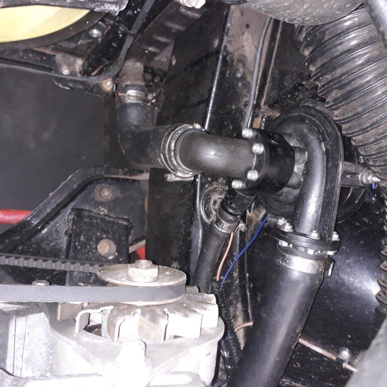

john.r.davies Posted Thursday at 11:03 AM Report Posted Thursday at 11:03 AM This is an earlier iteration of my electric pump project. Two water hose connectors top right. John Quote
Magz Posted Thursday at 03:33 PM Author Report Posted Thursday at 03:33 PM 4 hours ago, john.r.davies said: This is an earlier iteration of my electric pump project. Two water hose connectors top right. John Hmmm...interesting. I was just going to use an altered pump housing as I described so I can keep the thermostat and not get into a completely computer-controlled setup; I understand the advantages but the water pump part of my project is simply a means to an end, to free up space for a supercharger. I expect I could shoot off on a very time-consuming tangent just modifying the cooling system! On the other hand, lots of boost means lots of heat, and an improved cooling system might be warranted. I can see this is going to need a lot of thought... Quote

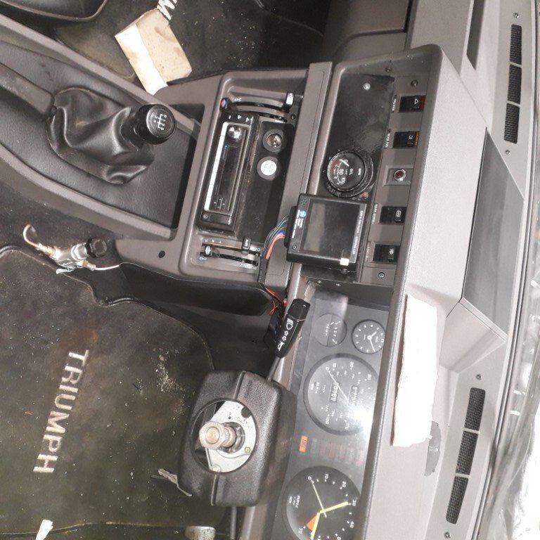

jerrytr5 Posted Friday at 08:13 AM Report Posted Friday at 08:13 AM I run a DaviesCraig EWP on the 7 Sprint. Very efficient & reliable so far. Useful display that tells you what the pump & fan are doing and real temperature which you will need to find space on the dash for. Jerry Quote
Magz Posted Friday at 11:40 AM Author Report Posted Friday at 11:40 AM 3 hours ago, jerrytr5 said: I run a DaviesCraig EWP on the 7 Sprint. Very efficient & reliable so far. Useful display that tells you what the pump & fan are doing and real temperature which you will need to find space on the dash for. Jerry Sounds good. I suppose I could make a little flip-up wood veneer cover for the display so it looks traditional until I need to check it. Any pictures of your setup, especially the display on your dash? Quote

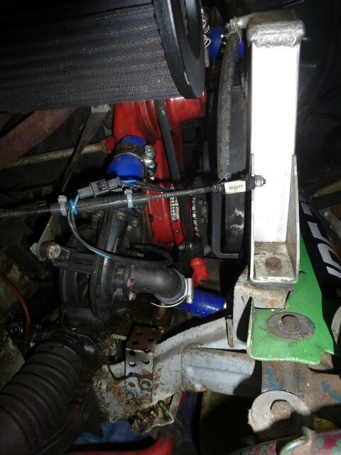

jerrytr5 Posted Friday at 08:07 PM Report Posted Friday at 08:07 PM The EWP display is the black square box. Not too bad in a 7 as it is pretty much a black square box itself. The small bore pipe on the pump is the heater return. Jerry Quote
Magz Posted Friday at 11:12 PM Author Report Posted Friday at 11:12 PM 3 hours ago, jerrytr5 said: The EWP display is the black square box. Not too bad in a 7 as it is pretty much a black square box itself. The small bore pipe on the pump is the heater return. Jerry Thanks for the photos. Very useful to see the various implementations! Quote
