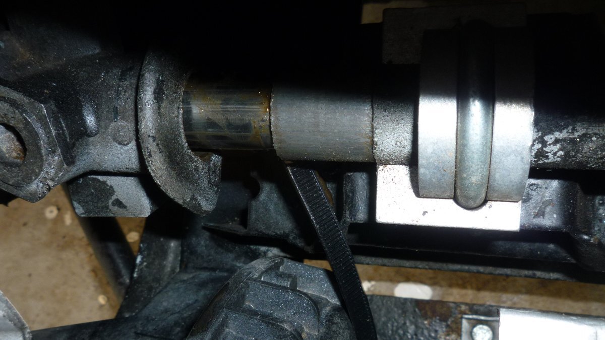

Hi,
today my lovely wife assisted me, she turning strong on the steering wheel, me touching the steering rack and its housing.
And yes, the rack IS TIGHT, but the housing slightly moves / wobbles --> is not tight on the tube anymore!
I finish the clamp, install it and hope it helps for the moment. Very likely scrap the rack next winter.

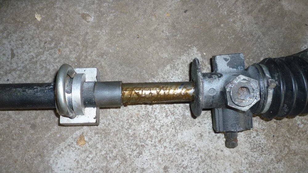

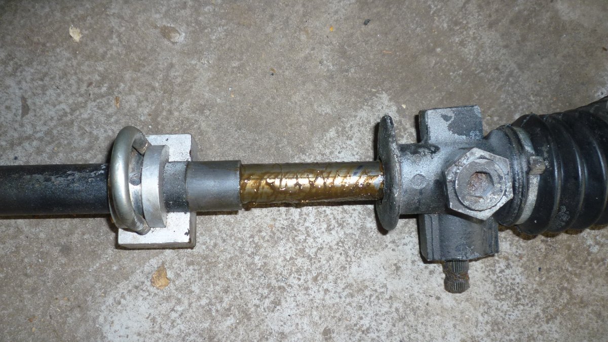

Hi,
the exhaust clamp is in and this is my construction (with a 38 mm dummy).
Both center lines are 33 mm above the steel plate.
AP1GczMB-GHjqSreQJV_nSTXhik2HlBp2N5D5yUh
I fitted it, adjusted the steering new and had a test drive: all OK at the moment.
AP1GczOsDe_eyI-An8lfIXYLDw5L01LNodZGD_BJ
If the problem of the twisted RH / LH steering wheel does not appear anymore, the steering gearbox slack on the tube indeed is the problem.
But how can I be sure to buy and new reliable one? About the problem I write an article for our club magazin with more photos.
Ciao, Marco

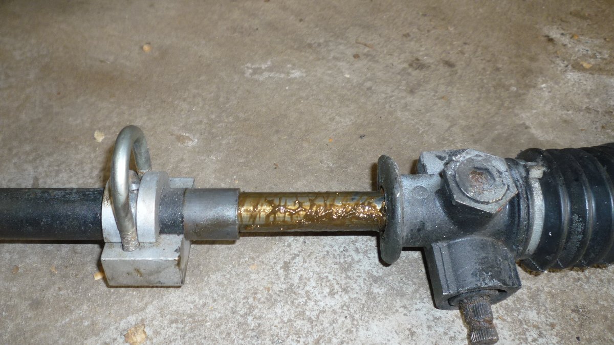

4 minutes ago, roy53 said:
just found the photo's of my failure
Roy
Tube doesnt look to have been pinned in at all. Shocking.

3 hours ago, Z320 said:
Hi Roy,
did you notice anything before, like me the twisted steering wheel?
Hopefully you have not been involved in an car accident and did not hurt?!?
The rack was a repro rack
How is it made? Why is the original safer? Is it indeed safer?
Ciao, Marco
nothing noticed
This is a race car so with sticky tyres .  Yes was an circuit crash but due to safety features no injuries
repro quick rack Revingtons so hopefully good!!!!!
not sure why the originals survive better , but after my original post i was contacted by several competition TR drivers with the same scary tales.  TR Tony for example on a rally in forests.
Because of this is the reason i tried the moss option , but the one they sent didn't fit my standard rack fit . Looked good one piece alloy just didn't fit over the ridge on the rack
