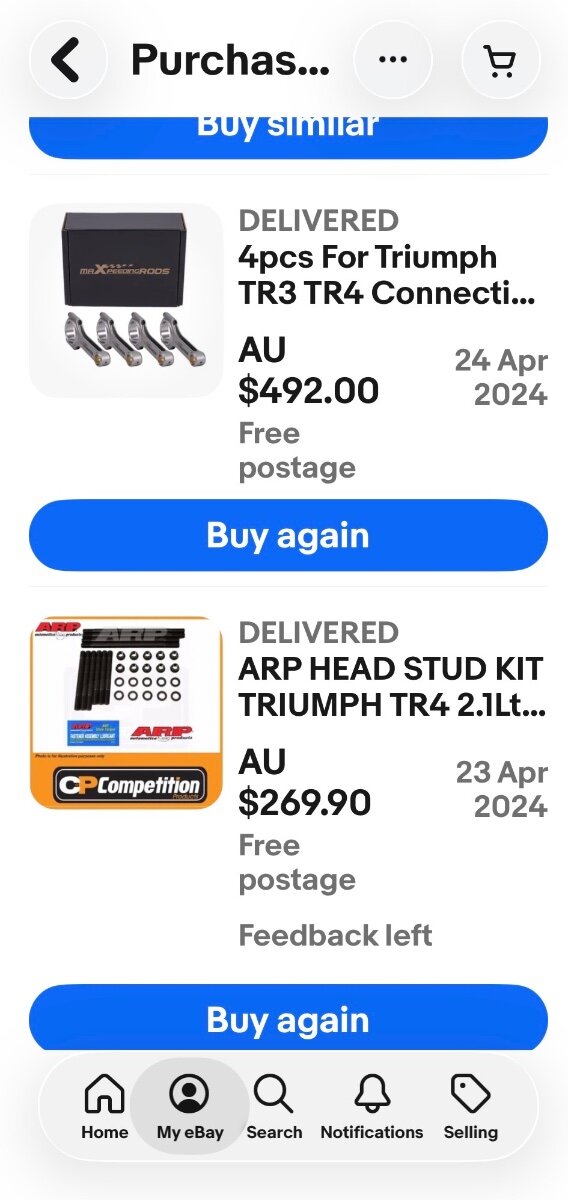

I bought a set via EBay around the same time as the ARP head stud kit Bob.

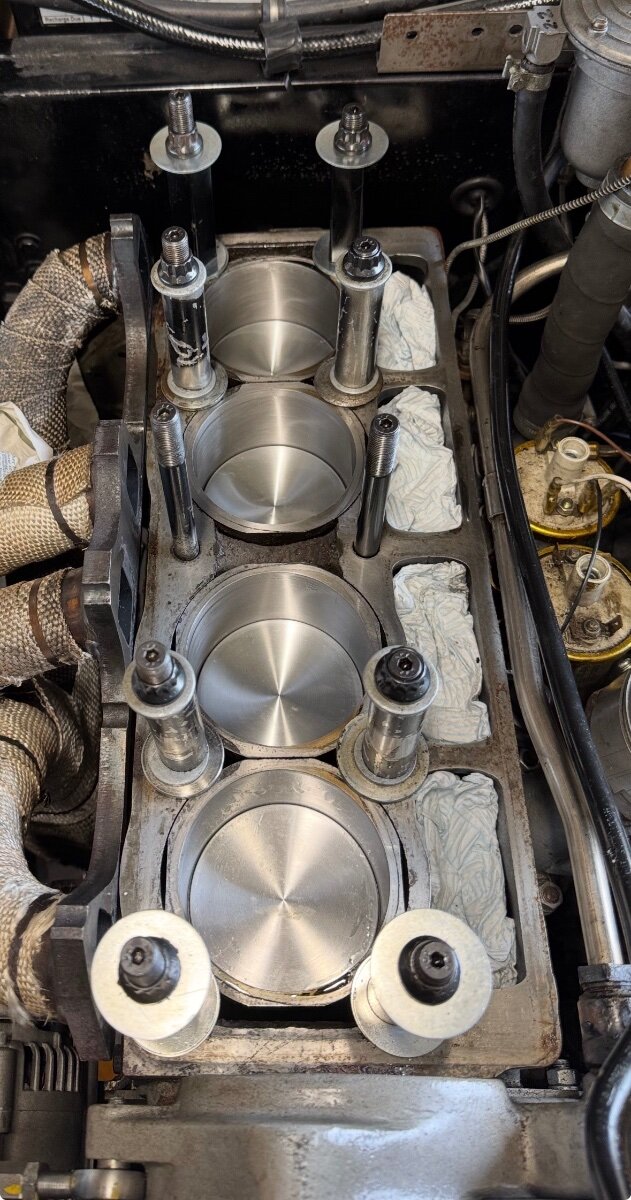

First up this morning from the comfort of the couch was ordering a 'bunch of lathe inserts, I need to make a camshaft bearing installation tool.The engine had new sleeves and pistons (4 ring) which were discarded and new cam and crankshaft bearings which all showed distress so no surprise when I removed the crankshaft plugs to find this.

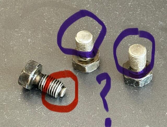

The cam bearings bar one had been installed out of alignment, apparently you just remove the locating pin off the end of the bolt. I have new bearings to fit along with another set of -0.010” rod and main shells, luckily the journals were within 0.0002” at worse so got a light linish only and will polish them later.
The engine was said to be built by a professional shop and 500kms since being rebuilt, I can only assume it was lugged at run in and built at home.
This will be my first wet sleeve engine rebuild so looking forward to it especially the 0.003”/0.005” sleeve projection procedure. I had already bought a ARP head stud kit and contacted ARP regarding a crankshaft main stud set (possibility) after finding the head studs had the same thread for the block but no reply to date.
Thats atrocious to grind the ends off the cam shell bolts! Thats what theyre for to locate the shells so they dont turn!

I've encountered a good number of bodges over the years on the old four pot engines but I've not seen that one before.....classic.

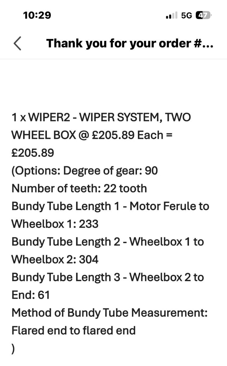

I remember the first time I drove in the rain I had to move my head with the wipers and still couldn’t see much. Given the dash is out and access is easy, now is a good time to place an upgrade order with Stafford Vehicle Components.
Tube lengths were taken off the original parts and retained the stock wheel box tooth count based off posts on the subject.

Les don’t mean to teach you  something you already know as you have some amazing machining skills
don’t forget to lock the liners down so they don’t move and break the fig 8 seals where they fit to the block.
unless you are taking them out anyway of course.
+1 for bobs comment on MaXpeeding rods
I appreciate any advice Hamish. The block looks to be in good condition including the seats for the sleeves having no corrosion, I will machine something to hold them when that time arrives. My first choice for sealant would be WellSeal for the figure of eight’s but it is getting harder to find locally and it is now deemed not to be posted via airmail from the UK. It might end up being Permatex and a maybe will be Hylomar aerosol (30M) on the composite head gasket but not the fire rings. Early days yet.
Oh and TR Shop London will supply you with interior parts at a much better price and quality too.
I included three new bolts in a Rimmers order Stuart.

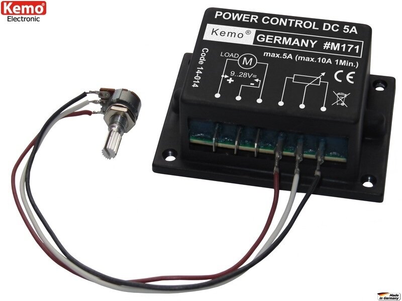

The heater must have the original dash functions/knobs and be an improvement. The original on/off should be ok to power a relay for the same purpose and will get a M171 for variable speed control. It will need a custom separate air distributor as an add on hence wanting a unit with blank side panels. Winter temperatures average around 21c in the daytime but have seen as higher as 39.5c in the cabin in the warmer months. Better placed heat proofing (Dynamat) should improve the later, the heater when it is raining mainly for the windscreen.

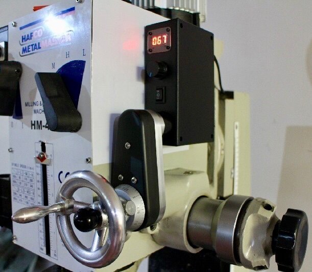

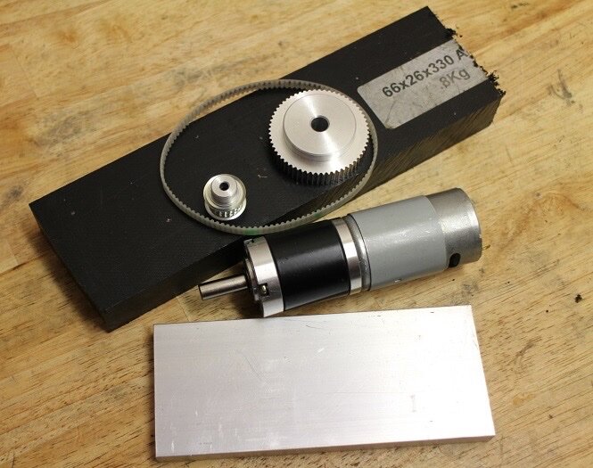

I had used a PWM controller when I built my quill power feed  so the heater should be doable hook up wise even though it is not a strong point.
What about using Rain-X?
Hi Les,
If you are going to rebuild the wiper system then go for the TR6 14W motor. You will eed to fashion a mount for it but that is easy enough.
Keep the same (TR4/4A) wheel boxes.    A 90' gear wheel from SCV.  You will need a short wiring link from the likes of Moss   LINK
item #85
If you want to retain your dash switch and knob (switch needs modifying) then I can either supply a modified switch or give you instruction how to.
Roger
Thanks for the post Roger. I bought the complete kit off SVC, a little bit spendy but should be fit and forget. ( the dash and all under dash components are removed so easy to fit the new wiper boxes, the originals being worst for wear) I did buy the loom plug (only) as I will make my own wiring with a relay for each speed and had enough spare switches to get the needed terminal for the stock push/pull switch modification as per your posts. ( Thanks for putting the information online)

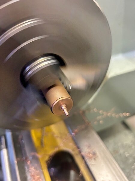

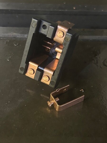

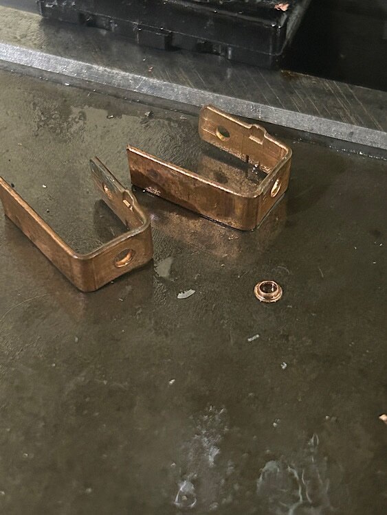

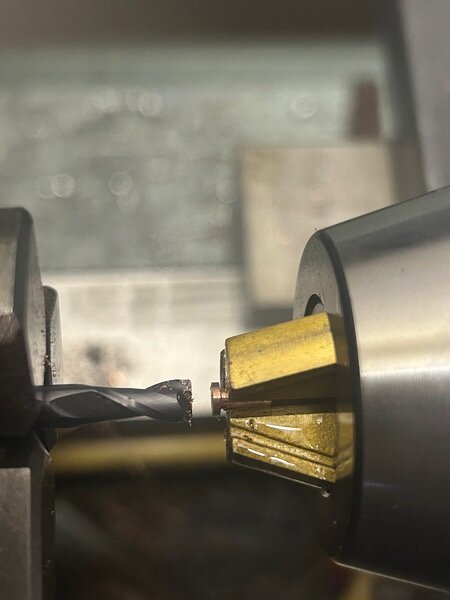

Nothing at hand to attach the new terminal so…
M4 OD head with a 2.5mm shank 6mm long in copper.
The chuck did not close up enough to hold the shank so do it back to front. Spin the end mill, dodgy rivet in the tail stock chuck stationary to reduce and face the head.
Rough and ready to crimp.(somehow tomorrow)

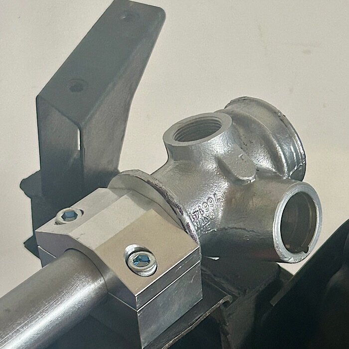

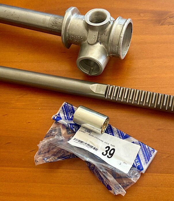

The steering rack has been started on also with a general check over and replace any basic wear parts.
Good heavens Les, you made a rivet for the switch contact. Well done.
I used a pop rivet but you need to be careful. Fitting a washer under the tail stops the expanding body (from the mandrel) bursting the Bakeolite switch body.
Bakeolite is good but useless at the same time.
Roger

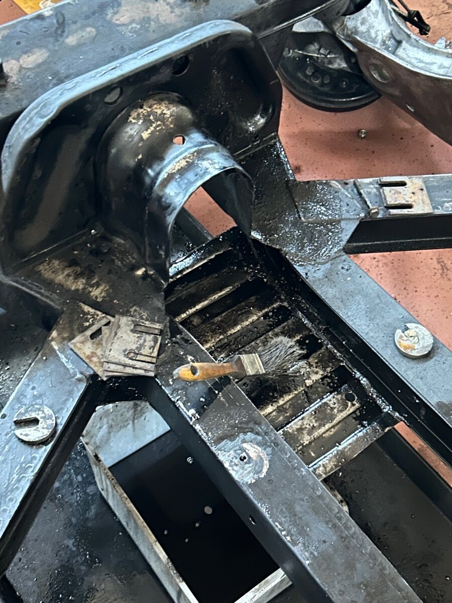

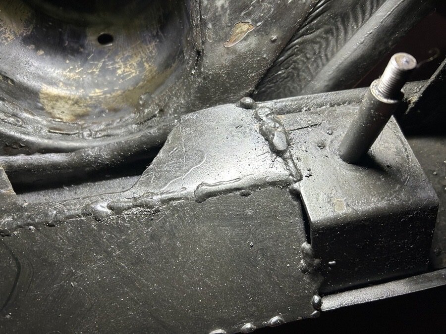

I will work from the front to rear of the chassis which seems straight and rust free but will remove these bits added in a past live.
Eventually it will be painted with KBS products that have been sitting on the shelf for some time along with all the other new parts.

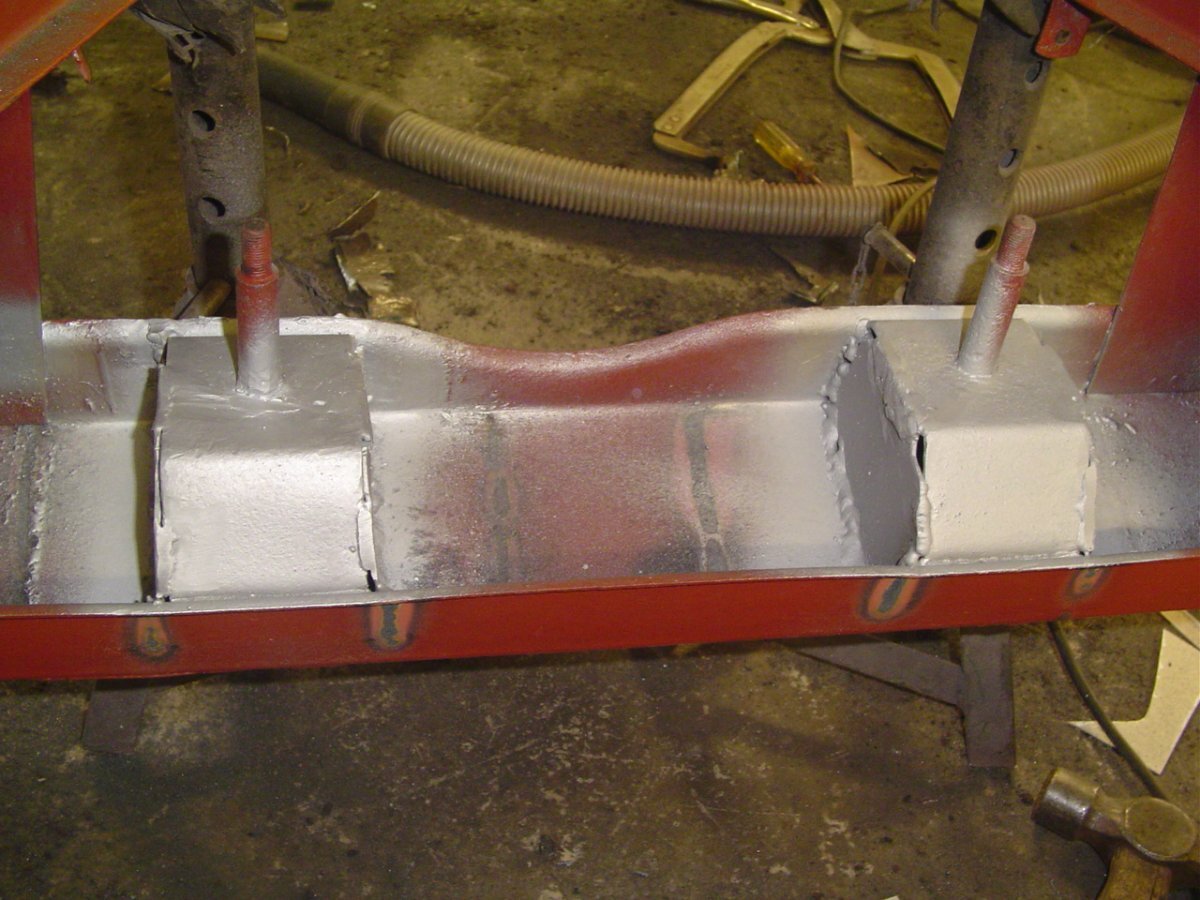

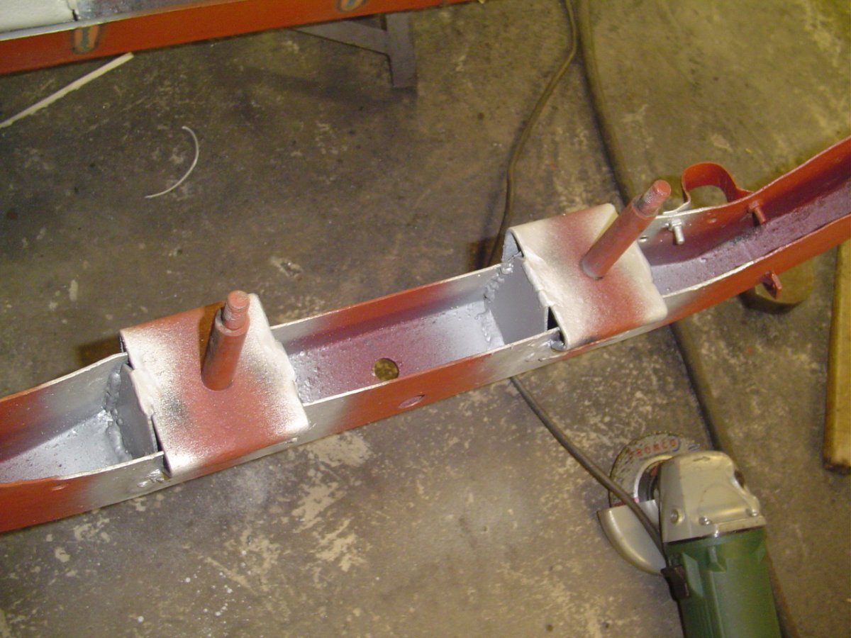

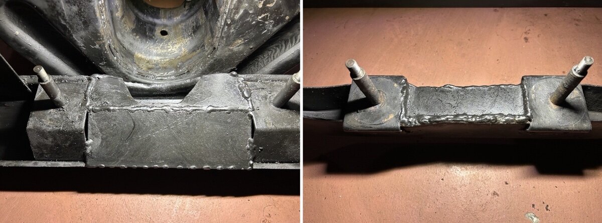

You do really need to re-enforce those pin mountings in some way though. Usually done with 3mm plates on the top surrounding the pins where they come through the top of the brackets and then boxing of the brackets underneath (Leave the lower corners open for stress relief.

It was the easiest option for me  over buying something even though a search showed copper rivets by the 1000 online. This homemade one should do the job once crimped.
Bakelite is not bad to machine but the modern version does not compare to that of yesteryears. (No surprise in this day and age)

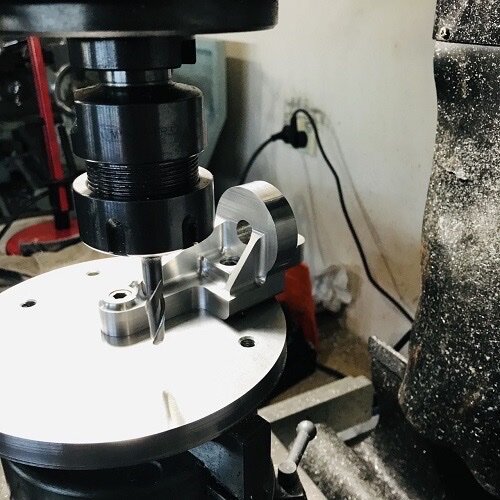

Ready to assemble after some checks and re-work to the main casting. Making some form of connection between the casting and split clamp an option.
