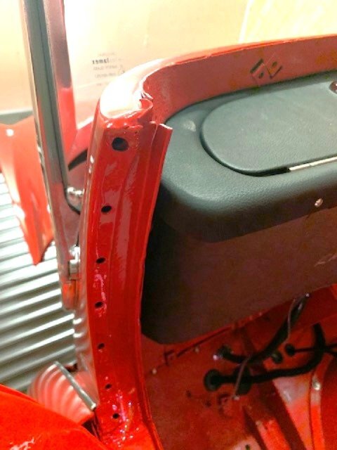

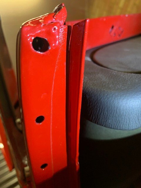

  1.  Am in thr process of finishing my Tr3A rebuild and have  looked at fitting the rubber seals that clip into the holes in the bulkhead,   but on both sides of the car the top hole appears to be too big for for the clips
  2. so my question is, Is the top hole a drain hole and the start of seal  is at the smaller hole not the first large hole hole???

That just looks like someone has tried to use a different clip in the hole and in consequence enlarged the hole, the seal should finish beneath the capping once that’s fitted,
Stuart

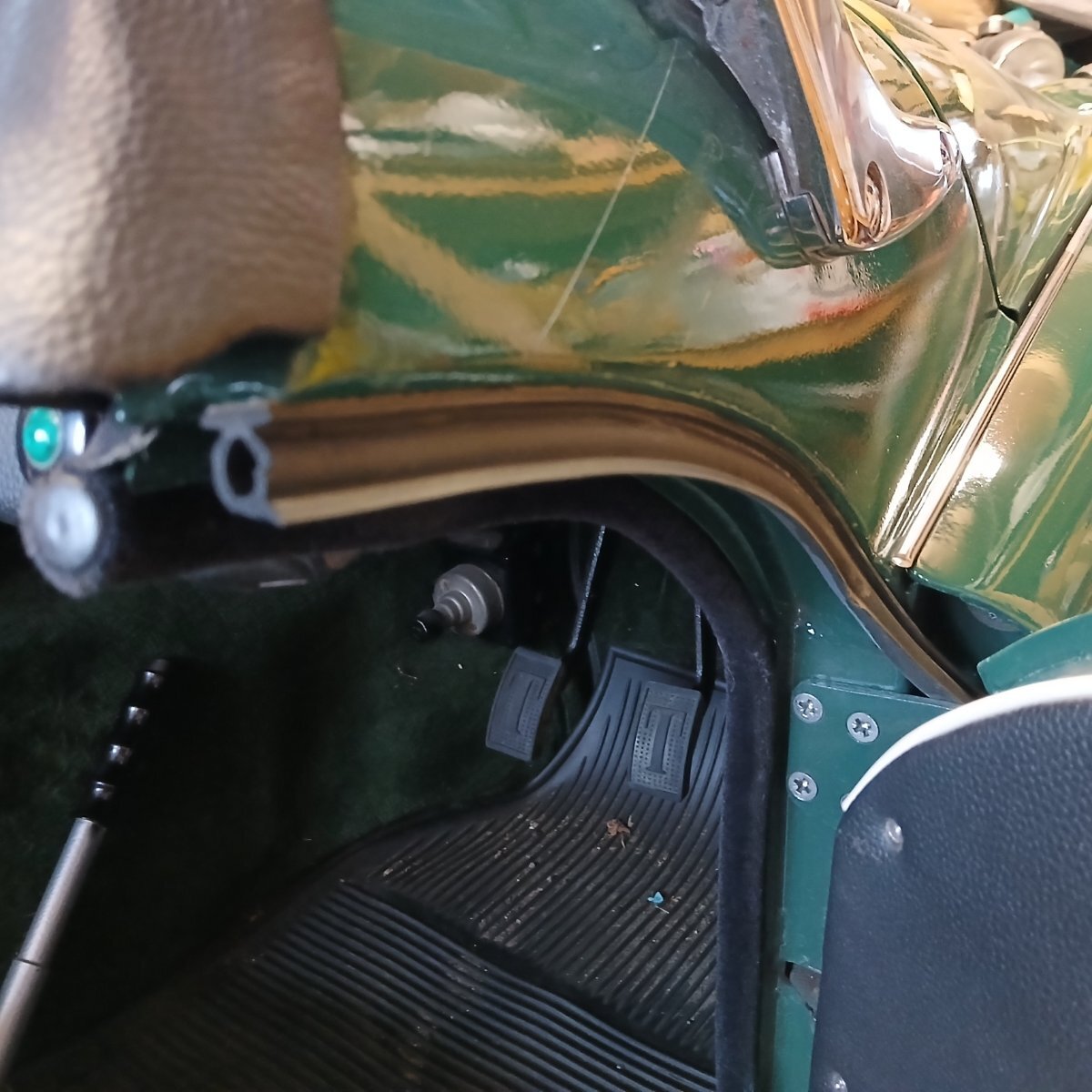

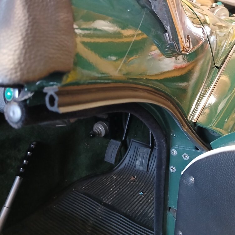

Depends how original you want to be, but I went for a self adhesive seal, now been in place for 7 years and does away with those horrible metal clips that damage the paint.
Ralph

  I like this idea though the ends should be tucked under the dash capping IMHO
MD
It does look that the seal would cover the top hole . i prefer to use the cips  and original seals as the rest of the car is original
cheeer
steve

Correct, same with the draft excluder.
Thx Stuart  i think i may have to use some siicone caulking on the top holes
8 hours ago, Nobbysr said:
…i may have to use some siicone caulking on the top holes
40+ years in polymer science and technology, much of that in coatings, has made the broad class of silicones, including RTV, one of my least favorite polymers.  They get everywhere — especially silicone oils and defoamers — and can foul up adhesion to surfaces
Perhaps a rubber plug or some butyl rubber dum dum as an alternative?
MD
Didn`t know how to finish the draft excluder at the time,  I did try to bend the self adhesive seal up under there but it wouldn`t conform nicely with the acute corner so ended up just fitting as shown.
