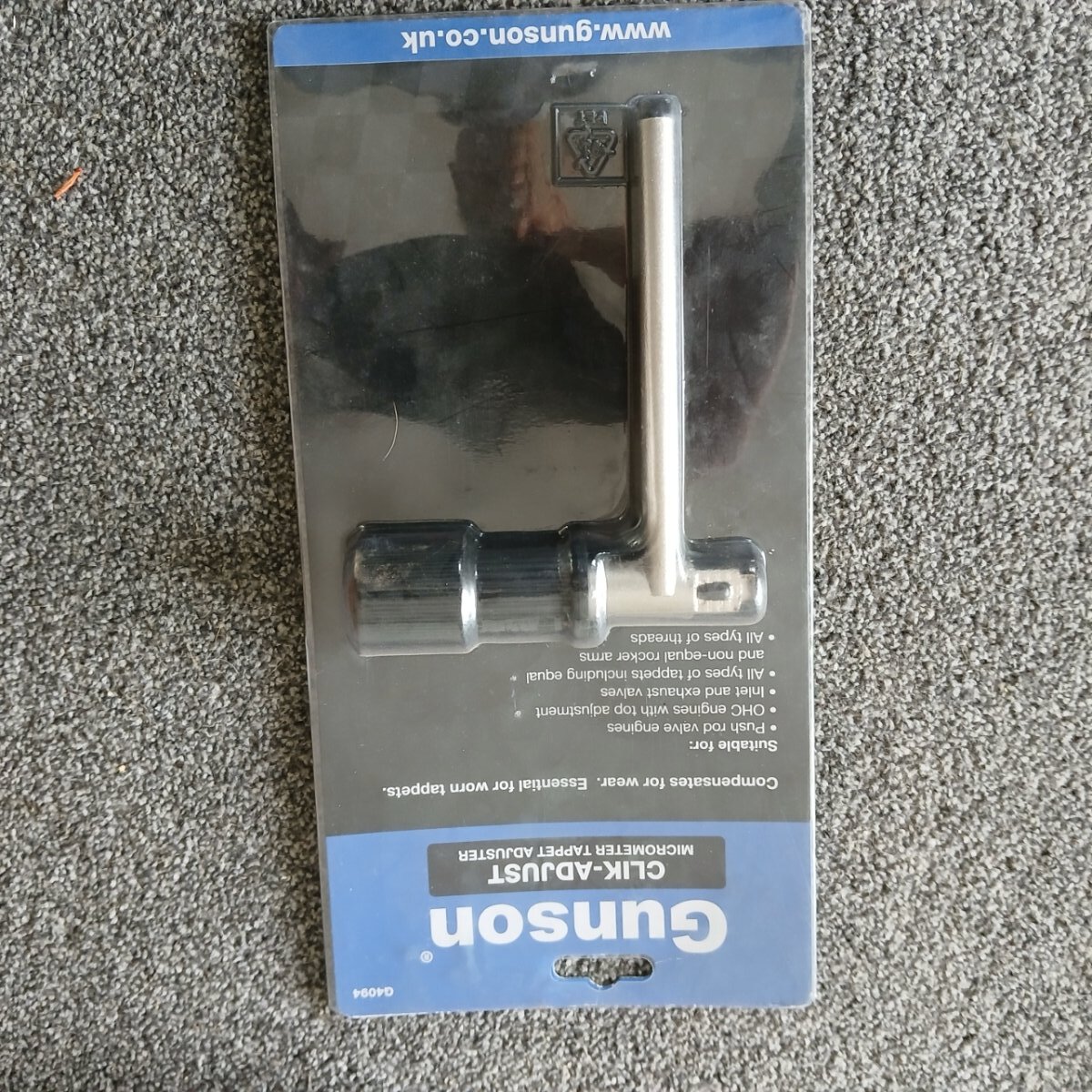

Ralph Whitaker Posted June 5 Report Posted June 5 I have one of those Gunson click adjust tools which takes the guesswork out of the equation as it automatically compensates for wear on the rocker tips. Ralph Quote
james christie Posted June 5 Report Posted June 5 (edited) Do those Gunson click and adjust tools still exist? I recall that they were a subject of much discussion in the early seventies as they were thought to be the bees knees for our worn out Minis, Trs, Rileys, Wolseleys etc but nobody that I knew managed to master them! james Edited June 5 by james christie Quote
RobH Posted June 5 Report Posted June 5 37 minutes ago, james christie said: Do those Gunson click and adjust tools still exist? Still available. https://www.gunson.co.uk/product/G4094/Clikadjust-Tappet-Adjuster Quote
Ralph Whitaker Posted June 5 Report Posted June 5 (edited) 22 hours ago, james christie said: Do those Gunson click and adjust tools still exist? I recall that they were a subject of much discussion in the early seventies as they were thought to be the bees knees for our worn out Minis, Trs, Rileys, Wolseleys etc but nobody that I knew managed to master them! james Yes they are still out there I think, got mine only a couple of years ago. When you first use it a bit of a fiddle, you have to put a 25thou feeler across the worn rocker and adjust the tool down till it just nips it, then if say you want 10 thou tappet clearance you have to slacken the tool, counting the clicks until the 10 thou feeler just slides in on top of the 25 thou one. make a note of the number of clicks. then you can remove the feelers and screw the adjuster down until the rocker makes contact with the valve then back off by the required number of clicks which should leave you with the correct gap. Obviously if you have say 10thou inlet and 15 thou exhaust you have to calibrate the tool again for the exhaust, but once you have worked out and made a note of how many clicks for your particular car you don`t have to calibrate it again The main reason for this initial calibration is that different cars may have different rocker ratios, ie the distance between the pushrod cup , rocker pivot, and valve stem, so the number of clicks on one car for 10thou may not be the same as another model or make, likewise if the adjuster threads are metric or imperial. But once you know how many clicks you need for your car (and have hopefully made a note somewhere) you never have to do it again and subsequent checks are easy. Ralph P.S. Don`t be surprised though if you can still hear the tappets on your TR, they were known not to be quiet from new. Edited June 6 by Ralph Whitaker Quote
Z320 Posted June 5 Report Posted June 5 (edited) I see a problem with the use of this tool on my 4A: no 1/2“ socket fits on the rocker lock nut, because the nut is too narrow to the rocker body. Edited June 5 by Z320 Quote
TR NIALL Posted June 5 Report Posted June 5 3 hours ago, james christie said: Do those Gunson click and adjust tools still exist? I recall that they were a subject of much discussion in the early seventies as they were thought to be the bees knees for our worn out Minis, Trs, Rileys, Wolseleys etc but nobody that I knew managed to master them! james Yes I still have one from the 70s and like others never got the hang of how to use it. Quote
PodOne Posted June 5 Report Posted June 5 4 hours ago, TR NIALL said: Yes I still have one from the 70s and like others never got the hang of how to use it. Same here seems a good idea but a lot of faffing about sits now back in its packet with a collection of other time saving gadgets 😂 Quote
RogerH Posted June 5 Report Posted June 5 You could always close the gap to zero then open the adjuster 60'. This will give you 0.010" Adjust accordingly to give other gap sizes. Roger Quote
Z320 Posted June 5 Report Posted June 5 (edited) My calculation is, - 8 clicks (AI: 30 for a hole turn), are too much, this will be a 0.45 mm gap! How od I calculate? 8/30 of the 24 tpi of the adjusting scwew x the ratio of the rocker levers, about 40/25 mm (valve side/adjuster side) - 60° is much better, this should be a 0.283 mm gap - 53° will be a 0.25 mm gap - all ON A TR 4 CYLINDER, others different Can anybody check and confirm, please Edited June 6 by Z320 Quote
