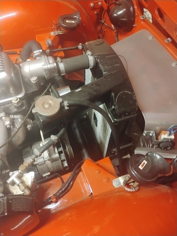

Richmac Posted May 31 Report Posted May 31 Could I also ask please is the TR4 radiator suitable for adding a normal expansion bottle too? Quote
Trumpy3 Posted June 1 Report Posted June 1 Yes. The problem here in Australia is getting a 4PSI recovery radiator cap. Most use a 7PSI cap. A good recovery system overcomes the need to remove the radiator cap to check the coolant, thus removing the stress on the top tank extension when removing the cap. While not that important here, it does greatly reduce the dilution of the anti freeze by continually topping up the coolant. Brian Quote
Don H. Posted June 1 Report Posted June 1 Should be no problem at all. It was an original fitment back in the day. My very late sidescreen TR3B had a TR4-style overflow bottle when I got it in 1981, and I fitted (and continue to use) a new one when I restored the car. Quote
Z320 Posted June 1 Report Posted June 1 (edited) You can fit one, but it is not needed. Just don’t overfill the rad, than you will not loose coolant. On my TR4A (original with overlow bottle) it is always empty Ciao, Marco Edited June 1 by Z320 Quote
stuart Posted June 1 Report Posted June 1 Early TR4 with the neck extension same as the earlier sidescreen cars already have an expansion tank, its the neck thats what its for, if you fill the rad so you can only just see water at the bottom of the neck when looking in the cap hole then thats correct. Stuart. Quote
TR Rob Posted June 1 Report Posted June 1 And if you overfill, it just spits excess water out when hot, usually when parking and the coolant finds its own level….ask me how I know !! Quote
Z320 Posted June 1 Report Posted June 1 I'm convinced they fittet the overflow bottle to get rid of annoying complaints from annoying customers, who have fun with topping up the level and "loose" coolant. Quote

stuart Posted June 1 Report Posted June 1 1 hour ago, Z320 said: I'm convinced they fittet the overflow bottle to get rid of annoying complaints from annoying customers, who have fun with topping up the level and "loose" coolant. Well not quite that, with the later cars from 4a on the rad doesnt have any room for expansion if filled to the neck which was always the thing people were advised to do back then , therefore water has no where to go other than out the overflow hence the introduction of the overflow bottle to allow for expansion and recovery. Stuart. Quote
Z320 Posted June 1 Report Posted June 1 44 minutes ago, stuart said: Well not quite that, with the later cars from 4a on the rad doesnt have any room for expansion if filled to the neck which was always the thing people were advised to do back then , therefore water has no where to go other than out the overflow hence the introduction of the overflow bottle to allow for expansion and recovery. Stuart. It works well on my TR4A with the rad core only a few millimeter covered with coolant. Quote
stuart Posted June 1 Report Posted June 1 3 minutes ago, Z320 said: It works well on my TR4A with the rad core only a few millimeter covered with coolant. Yes because theres room enough for expansion then. People always fill to the neck though. Stuart. Quote
BlueTR3A-5EKT Posted June 1 Report Posted June 1 No flexibility in the top hose between the moving engine and the rigid radiator? Factory top hose drawing calls for more than 10° of available flex in the convoluted top hose. Quote
RogerH Posted June 1 Report Posted June 1 (edited) 22 hours ago, Richmac said: Could I also ask please is the TR4 radiator suitable for adding a normal expansion bottle too? Top hose should be more like this HOSE You are also missing the righthand rad steady Roger Edited June 1 by RogerH Quote
iain Posted June 2 Report Posted June 2 21 hours ago, stuart said: Early TR4 with the neck extension same as the earlier sidescreen cars already have an expansion tank, its the neck thats what its for, if you fill the rad so you can only just see water at the bottom of the neck when looking in the cap hole then thats correct. Stuart. +1. You don’t need an expansion tank for the existing expansion tank……. Quote
Z320 Posted June 2 Report Posted June 2 (edited) I consequently use the therm "overflow bottle" for this bottle on TRs, not "expansion bottle". Because the coolant flows OUT of the locked cooling system, mixes with stored coolant that gets fresh oxygen and is sucked back in the old cast iron boiler. This makes the rather original locked system to an opened system. Sadly Triumph made this a goodness on TR4A-TR6. IMO this is wrong. "Expanion bottle" to me suggests a locked cooling system, which is the issue on modern cars. Just my opinion. Ciao, Marco Edited June 2 by Z320 Quote
