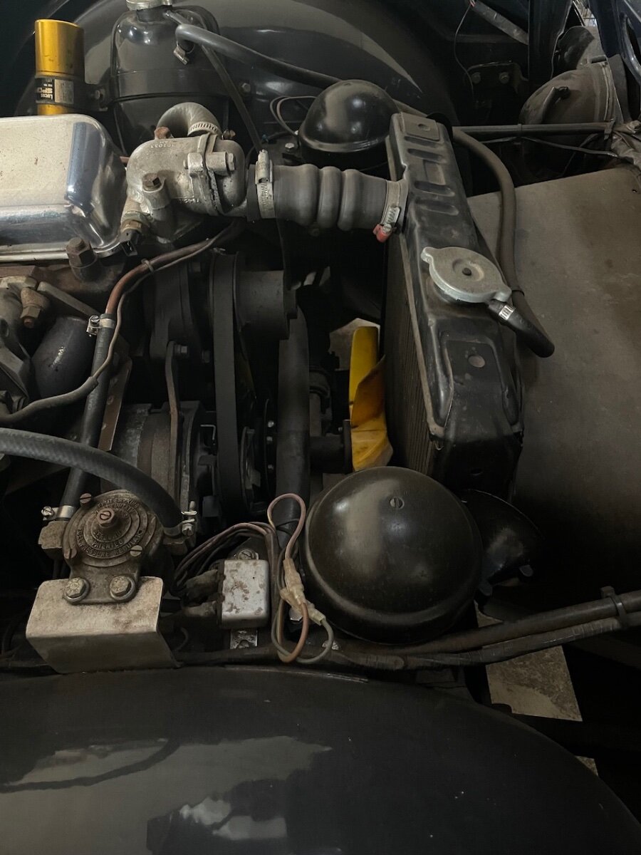

Z320 Posted June 3 Report Posted June 3 Here photos from my TR4A, with the rad correctly filled the thermostat housing is nearly empty, I don't worry this. The rad touched the bonnet frame, it needed some years until I noticed it (now black painted) On the frame the contact was with the rusty part, but it is visible someone used a hammer to get some space for a not suitabel rad. This must have been at the USA, where the car came from in 1992 Ciao, Marco Quote
RogerH Posted June 3 Author Report Posted June 3 Hi Marco many thanks. That explains a great deal. Roger Quote
