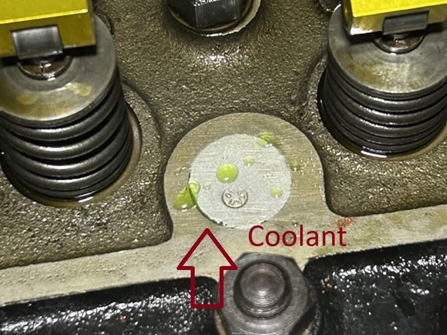

Z320 Posted June 17 Report Posted June 17 4 hours ago, PriceLes said: The weep picture was in the car with the rocker cover removed. Found when checking the valve clearances which were IN 0.005” and EX 0.002” (DPO<) Ok, I expected less coolant really visible Quote

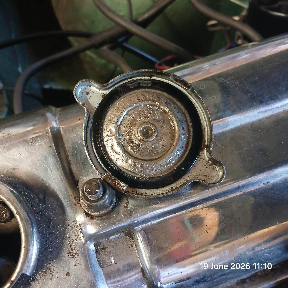

TR4'er Posted June 19 Author Report Posted June 19 On 6/16/2026 at 11:16 PM, TR4'er said: Thanks for all your coments - taken on board. ust back from Hols, so will start tomorrow Wed 17th and will update with any developments. Thx again. Rob. Cleaned out waterways and radiator, replaced cylinder head gasket, using minimal sealant on both sides. Left for a day then started up with no water, to heat up the block. Left for another day and filled with coolant and ran for around 20 minutes - mid range temp, with plenty of water circulation. Cooled down and checked radiator - no oil present, but oil filler cap had condensation on it - as in pic. Any ideas as to the next step - is it cylinder head to be skimmed - if so any suggestions as to who could do this - I live in Aylesbury. Thanks in advance. Rob. Quote
stuart Posted June 19 Report Posted June 19 45 minutes ago, TR4'er said: Cleaned out waterways and radiator, replaced cylinder head gasket, using minimal sealant on both sides. Left for a day then started up with no water, to heat up the block. Left for another day and filled with coolant and ran for around 20 minutes - mid range temp, with plenty of water circulation. Cooled down and checked radiator - no oil present, but oil filler cap had condensation on it - as in pic. Any ideas as to the next step - is it cylinder head to be skimmed - if so any suggestions as to who could do this - I live in Aylesbury. Thanks in advance. Rob. Thats not enough time running to get rid of all the condensation, It needs a much longer run. Stuart. Quote
trchris Posted June 19 Report Posted June 19 Yep agree with Stuart you need to go and give it a good run….. in the glorious sunshine ☀️ Chris Quote
TR4'er Posted June 19 Author Report Posted June 19 1 hour ago, stuart said: Thats not enough time running to get rid of all the condensation, It needs a much longer run. Stuart. Thank you for that ..... good point. Will do. Thx. Rob. Quote

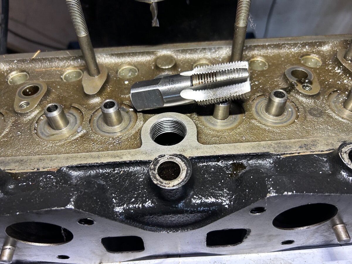

TR4'er Posted June 19 Author Report Posted June 19 On 6/17/2026 at 4:15 AM, PriceLes said: This is the factory plug in the cylinder head, not it applies to your situation based on previous replies. That plug can corrode from the inner side resulting in weeping (as I found) . It can be removed and tapped 3/4 NPT to take a brass hex plug. Thank you for the information. Have checked the "ally plug" and all looks well. Will continue with the process suggested on this thread. Thank you. Rob. Quote

TR4'er Posted July 5 Author Report Posted July 5 On 6/19/2026 at 1:20 PM, trchris said: Yep agree with Stuart you need to go and give it a good run….. in the glorious sunshine ☀️ Chris Have been out for a round trip to Cardiff - 400 miles, and found a wonderfully clear oil filler cap, once everything had cooled down. Hopefully that should be sorted. With regard to re-torqueing the cylinder head, re-torqued the day following fitting the new gasket following a minimal run. Do you think I should re-torque after the long run ... ??? Quote
trchris Posted July 5 Report Posted July 5 l would re-torque after 500 miles so l would think you about ready to Chris Quote
Hamish Posted July 5 Report Posted July 5 I was lead to believe it was more about good heat cycles rather than miles especially if the miles done in one trip. but yes check again now. Quote
Motorsport Mickey Posted July 5 Report Posted July 5 Rob, When you are retorquing the cylinder head make sure to UNDO the head nuts by about 1 flat first to allow the stiction( sticking friction) to be removed from the nuts, I mark the nuts with dab of white paint. Then with the torque wrench at 105 lb ft retorque the head in a smooth sweep action until it clicks off in the appropriate sequence as per workshop manual diagram. Don’t be surprised when the fastenings screw down maybe an extra flat beyond where they were originally, the heat treatment to the gasket allows it to crush tighter upon retorque. I continue retorquing yearly until there is no further movement of the nuts, showing the head gasket is crushed to it’s limit. Mick Richards Quote
TR4'er Posted Thursday at 08:58 PM Author Report Posted Thursday at 08:58 PM On 7/5/2026 at 10:31 PM, Motorsport Mickey said: Rob, When you are retorquing the cylinder head make sure to UNDO the head nuts by about 1 flat first to allow the stiction( sticking friction) to be removed from the nuts, I mark the nuts with dab of white paint. Then with the torque wrench at 105 lb ft retorque the head in a smooth sweep action until it clicks off in the appropriate sequence as per workshop manual diagram. Don’t be surprised when the fastenings screw down maybe an extra flat beyond where they were originally, the heat treatment to the gasket allows it to crush tighter upon retorque. I continue retorquing yearly until there is no further movement of the nuts, showing the head gasket is crushed to it’s limit. Mick Richards Thank you all for your comments in my situation. On return from Cardiff - re-did the head nut torque again - as advised and took it for another long run - Liverpool and back - 500mls. Good to inspect after cooldown and not a drop of condensation to be found. Really comforting to have you all behind me when doing jobs and not too experienced. Thanks again, Rob. Quote
