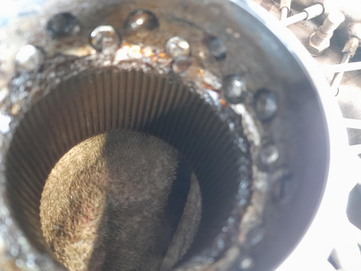

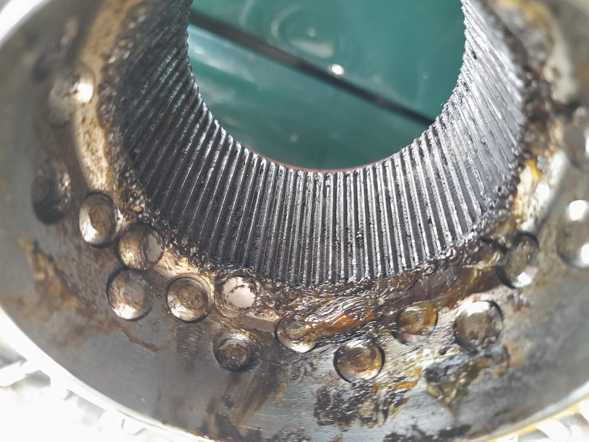

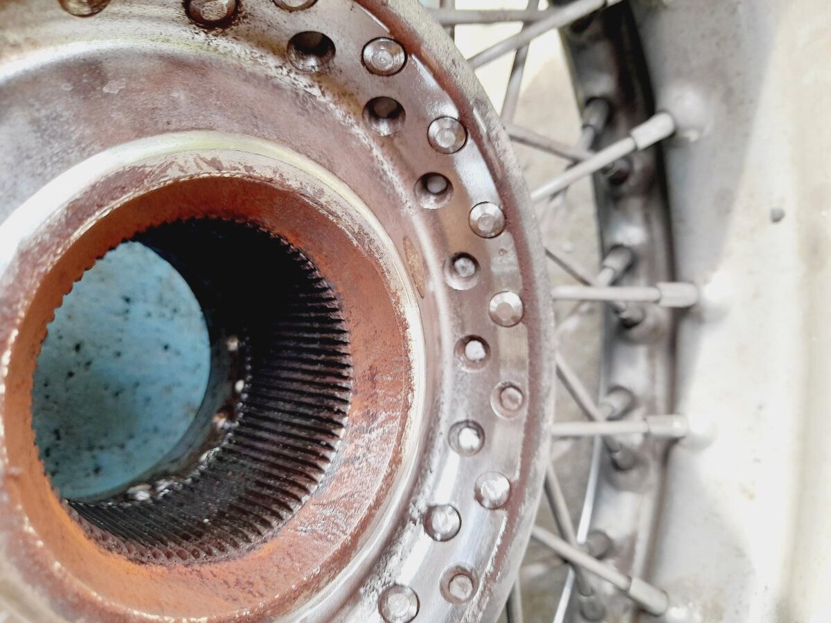

Phil Read Posted June 5 Report Posted June 5 What has cause this? when i removed the wheels the heads of some of the spokes dropped out, they have sheared off. They are just over 2 years old done about 7000 miles. Quote

RogerH Posted June 5 Report Posted June 5 Hi Phil the cone seating area looks dry and rusty - has it been wobbling and causing pulsing tension on the spoke heads. Roger Quote

Phil Read Posted June 5 Author Report Posted June 5 hi Roger seats were tight. I serviced the car before i went to Saltau and didn’t notice any problem. Since then i have done 1750 miles. I was servicing it again before I go to Le Man when the heads of the spokes dropped out. I check the tightens of the spinners regularly with a bash of the lead hammer. Quote
Ralph Whitaker Posted June 5 Report Posted June 5 Just had another look at the pictures and I see there are broken spokes on the outer part of the hub too that I missed the first time. I wonder if it was a batch of brittle spokes. Ralph Quote

Phil Read Posted June 5 Author Report Posted June 5 Just now, Ralph Whitaker said: Just had another look at the pictures and I see there are broken spokes on the outer part of the hub too that I missed the first time. I wonder if it was a batch of brittle spokes. Ralph Yes both outer and inner spokes have failed on 3 out of 4 wheels. It has been suggested that they had not been tensioned correctly and evenly when manufactured/ Quote

RogerH Posted June 5 Report Posted June 5 5 minutes ago, Phil Read said: I have just been told by an engineer i know that stainless steel is not an ideal material for spokes, Hi Phil, that is an easy get out. What in fact is ideal? Most plain steels do not like Chroming and most customers long for shiny spokes. Stainless Steel is more than adequate to be used in our lightly loaded wheels. Poor adjustment is a sensble cause for your problem as this would easily cause a pulsating tensile load. Roger Quote

RobH Posted June 5 Report Posted June 5 What is that brown stuff that Roger mentioned, on the cone seat in the last photo Phil? Is it grease? Quote
