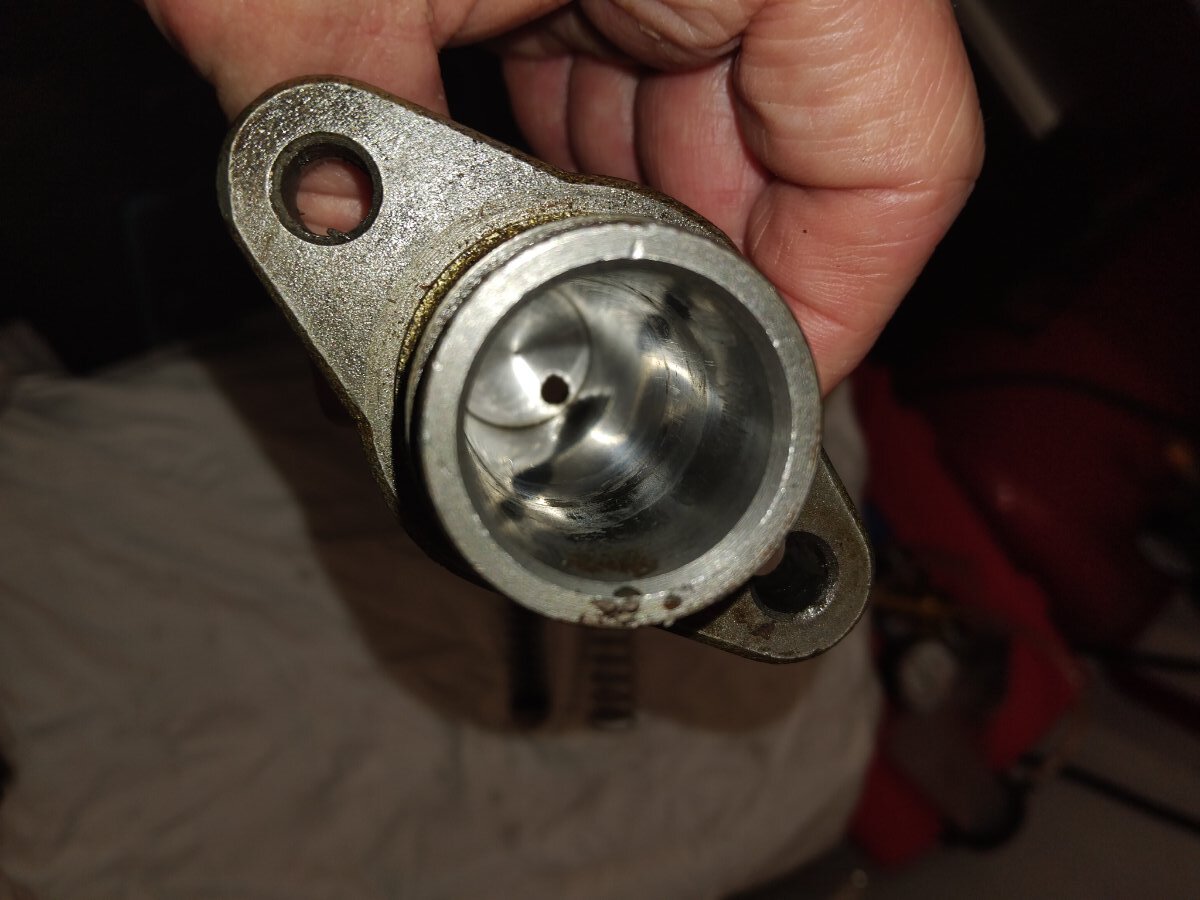

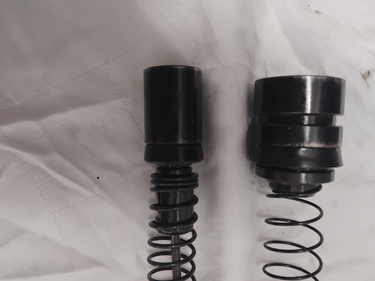

Richard71 Posted June 10 Author Report Posted June 10 I've removed & stripped down both the master & slave cylinders. See attached photos, I'm no expert on these, but the seals & pistons appear to be in good condition but the bore of the slave cylinder shows signs of water damage, no ridges. When I removed the slave cylinder, there was a small amount of fluid gathered behind the dust cap, is that normal? The bore of the MC is spotless. Any opinions welcome. Richard. Quote
stuart Posted June 11 Report Posted June 11 16 hours ago, Richard71 said: I've removed & stripped down both the master & slave cylinders. See attached photos, I'm no expert on these, but the seals & pistons appear to be in good condition but the bore of the slave cylinder shows signs of water damage, no ridges. When I removed the slave cylinder, there was a small amount of fluid gathered behind the dust cap, is that normal? The bore of the MC is spotless. Any opinions welcome. Richard. That slave is scrap Im afraid, any fluid outside the bore shows it, that`ll be why you cant get a good pedal. Stuart. Quote
Richard71 Posted June 11 Author Report Posted June 11 5 minutes ago, stuart said: That slave is scrap Im afraid, any fluid outside the bore shows it, that`ll be why you cant get a good pedal. Stuart. Replacement arriving from TR Shop this afternoon. 👍. Quote
