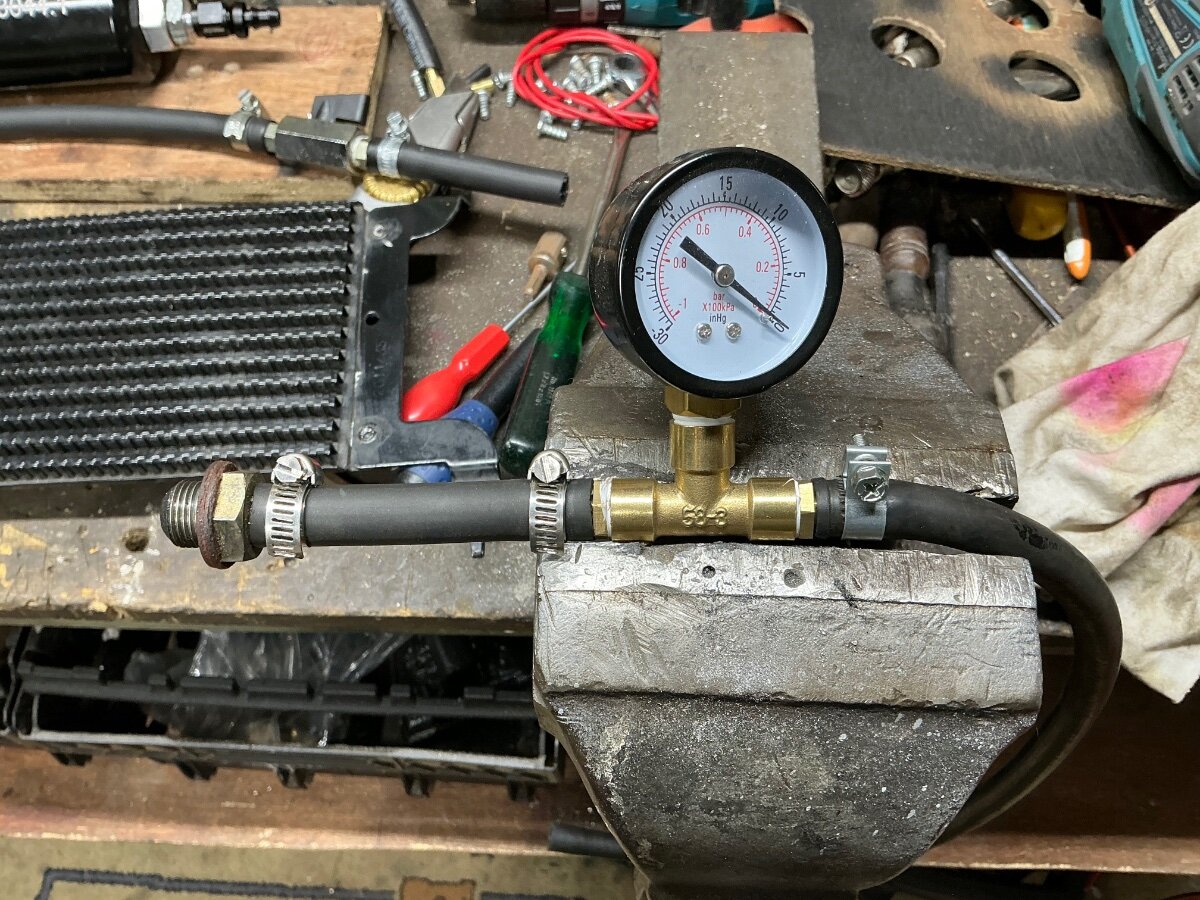

TR NIALL Posted June 13 Report Posted June 13 2 hours ago, Kevo_6 said: Sorry Waldi, not with you. Which do you use, the metering unit or brake servo/booster? Cheers Kev. If it’s the Tongue Test it’s the one from the Manifold to the MU. Quote
Kevo_6 Posted June 13 Author Report Posted June 13 (edited) 21 minutes ago, TR NIALL said: If it’s the Tongue Test it’s the one from the Manifold to the MU. Done the tongue Niall and all good there. It’s for checking overall vacuum. Edited June 13 by Kevo_6 Quote
TR NIALL Posted June 13 Report Posted June 13 13 minutes ago, Kevo_6 said: Done the tongue Niall and all good there. It’s for checking overall vacuum. You’ll have to get a T piece fitting for the pipe from the Manifold with a Gauge attached and read Vacuum from there. Quote
Mike C Posted June 13 Report Posted June 13 I just put a vacuum gauge directly on the brake booster hose, the brakes won't be used while the car's stationary. Quote
TR NIALL Posted June 13 Report Posted June 13 Something like this maybe,never tried it but presume it should work. Quote

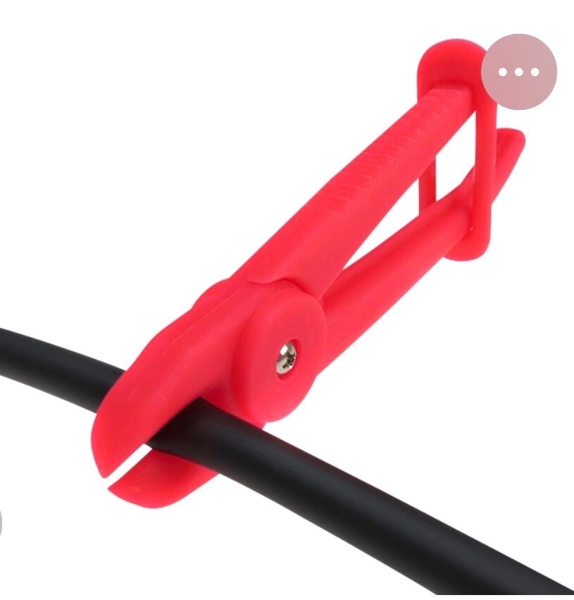

Waldi Posted June 17 Report Posted June 17 Hi Kev, I diid read this topic again. I do not think a low fuel pressure can cause running rich since less fuel will be injected with each pulse, but the low pressure is not ok. The original PRV is not designed by Lucas to fully close, there will always be some flow, but if the shuttle (plunger) stays in a “cracked open” position, this will result in low fuel pressure. I once had this after the winter. I opened it, did not see any dirt, polished the internals with car wax (not with abrasive products as this would increase wear and unwanted leakage). All was fine since then. And I added a fuel stabilizer every fall (tip from MikeC). To check the leakage, you could clamp the PRV return hose with a hose plier (just a few seconds), and see if the pressure rises. I use a plier like shown in the piccy. Make sure the hose is ok and properly connected to the PRV outlet pipe. The running rich issue on your car will likely be something else, but the pressure should be corrected anyway (first). My humble opinion. Waldi Quote
