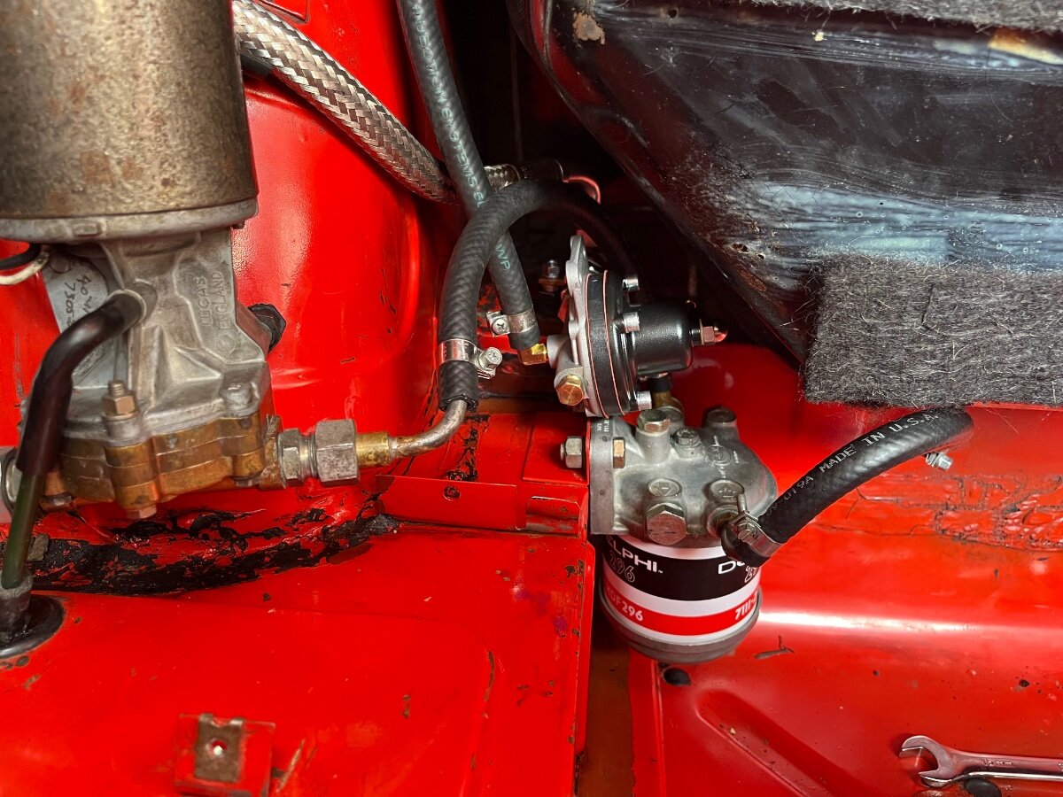

Steve-B Posted June 17 Report Posted June 17 (edited) Kevo, glad every thing that came out of the lines was clear! For my money, Revington's is the one a lot have gone to, is very adjustible and easy to fit a pressure gauge onto: https://www.revingtontr.com/product/rtr4456k/name/fuel-pressure-regulator-kit-tr5-6pi Edited June 17 by Steve-B Quote
Chris Hale Posted June 17 Report Posted June 17 10 minutes ago, Steve-B said: For my money, Revington's is the one a lot have gone to, is very adjustible and easy to fit a pressure gauge Why are you attaching a pressure gauge to the PRV. Your suppose to checking the pressure at the metering unit Quote

Kevo_6 Posted June 19 Author Report Posted June 19 (edited) On 6/17/2026 at 3:22 PM, stuart said: A quick net search will turn that regulator up a lot cheaper. Stuart. Hi Stuart, I’m struggling to find a cheaper Malpassi fuel regulator with the correct fittings, the best I can find is £172 inc delivery. Is there anywhere/company you can point me in the direction of. Many Thanks Kev. Edit: I have found plenty of Malpassi regulators at very reasonable prices but I’m not sure what is the correct model I require, the fittings etc I have found. Edited June 20 by Kevo_6 Quote
Kevo_6 Posted June 23 Author Report Posted June 23 (edited) I have fitted the Malpassi regulator and all seems well, fuel pressure is a tad under 100psi but the car started on the first turn. The battery was a bit low. I started balancing the butterflies and then I ran out of fuel. Far too hot to do any more. I’ll get some fuel tomorrow and finish off. I’ll let you know how the Italian tune up goes. Cheers Kev. Edited June 23 by Kevo_6 Quote

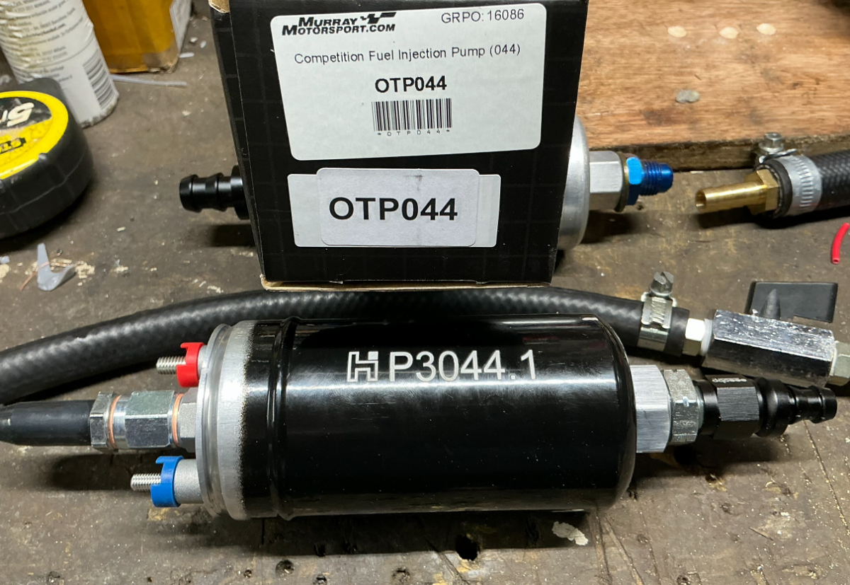

Kevo_6 Posted July 1 Author Report Posted July 1 8 hours ago, TR NIALL said: Is it the Original Lucas I presume if so sounds like it’s due another Recon or maybe switch to the Bosch equivalent. I emailed Glencoe who now do a replacement for the Bosch 044 and they recommended the one pictured below should be available from them for about £90. Yes it’s a Lucas pump Niall, still not sure which way I should go but that pump is interesting, i shall look into that. Kev. Quote
Chris Hale Posted July 1 Report Posted July 1 This is the Bosch equivalent that I use https://www.westwalesrallyspares.co.uk/bosch-injection-fuel-pump-909?search=Fuel pump worked fine in the South of France a couple of weeks ago in temps in the mid 30s Quote

Kevo_6 Posted July 1 Author Report Posted July 1 7 minutes ago, Chris Hale said: This is the Bosch equivalent that I use https://www.westwalesrallyspares.co.uk/bosch-injection-fuel-pump-909?search=Fuel pump worked fine in the South of France a couple of weeks ago in temps in the mid 30s Thanks for your recommendation Chris, much to think about. Quote
Chris Hale Posted July 1 Report Posted July 1 (edited) If you go down the Bosch type route my advice would be to mount it in the rear wheel arch rather than in the boot/spare wheel well Edited July 2 by Chris Hale Quote
