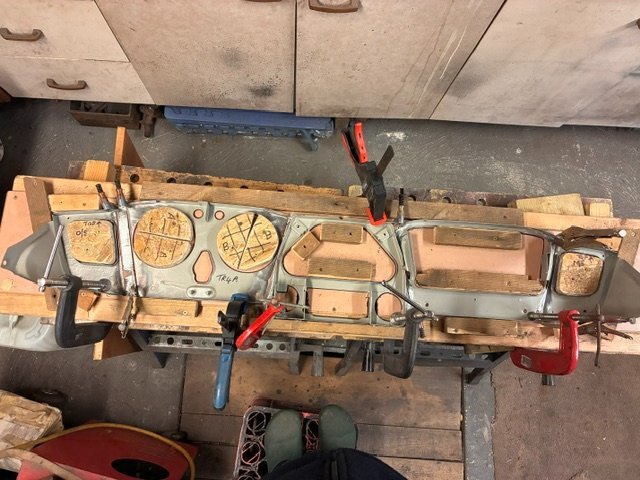

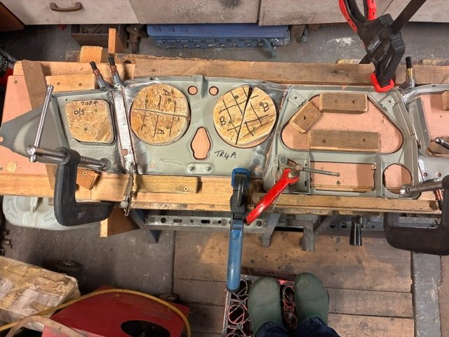

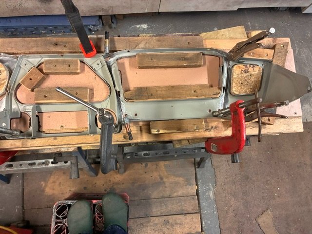

Hi all - finally got round to "doing" my various metal dashes ( mostly LHD units) accumulated over many years.
The first photos show the jig I made, based on an original RHD TR4A unit, and the others show the first chopped LHD unit all prepped and ready for welding into a RHD unit
I will have two TR4, three TR4A  and one TR5/6(CP) once finished, hopefully in the near future. They will be blasted and primed before sale.
These will all be surplus to my own requirements, so if anyone could be interested in a unit, please get in touch - I anticipate they will be in the £250-£300 ball park
Cheers Rich C-R

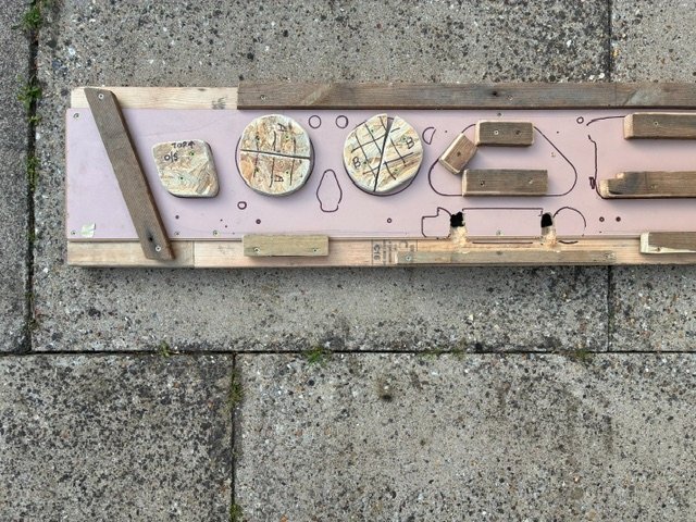

My method may be crude but I reversed the wooden part of the dashboard and used that as a template.
