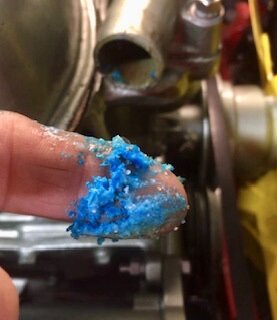

New engine. Never been run except to tune after total overhaul
New blue antifreeze been in 1 month.  The container says it is under 6 months old   Engine has been started and run plus basic tuning   All new radiator etc too
Removed thermostat cover to fit thermostat of different temp and found the crystals in the outlet cover and thermostat and top hose.
Any ideas?

Looks sorta like the dried red Toyota coolant from a tiny seep on my older Toyota pickup.
Is the deposit resoluble in water?  I’d guess it is, and is somehow related to evaporation.  If it isn’t resoluble, it sounds like some sort of chemical incompatibility leading to the blue precipitate and is probably a bugger concern.
Is there any chance an acidic low-pH or alkaline high-pH cleaner was left in the water passages during boilout?

the water used with the blue antifreeze was from a condenser used to dehumidify the garage.  ‘That surely must be not really be water as we know it, Jim’.
It tastes horrid!
Edited by BlueTR3A-5EKT
Note the distinct red deposit showing where a slow leak was evaporating Toyota red coolant from a radiator tank (replaced last year) on one of my Toyota trucks.  There was nothing wrong but this slow leak and the dried red crust.
The blue stuff looks similar, but a root cause for why so much deposit would evaoporate inside a closed system is not at all clear.

I’ll have to check where he got the blue antifreeze and it’s make.  Thanks Roger.  Another thing is sent to try us
Regardless of its make up, on a fresh built engine with all waterways clean and dry etc to start it still shouldnt be doing that. Basic chemistry would suggest thats due to evaporation but it shouldnt be able to in a closed system unless theres a huge air gap.
Maybe worth a test by boiling some up on the cooker until it's all evaporated and see what the residue looks like.
