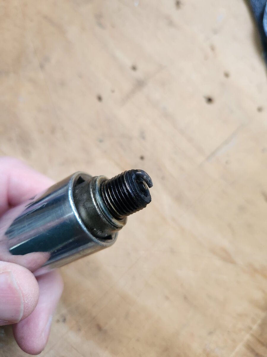

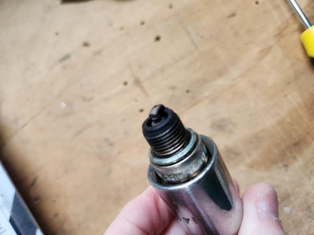

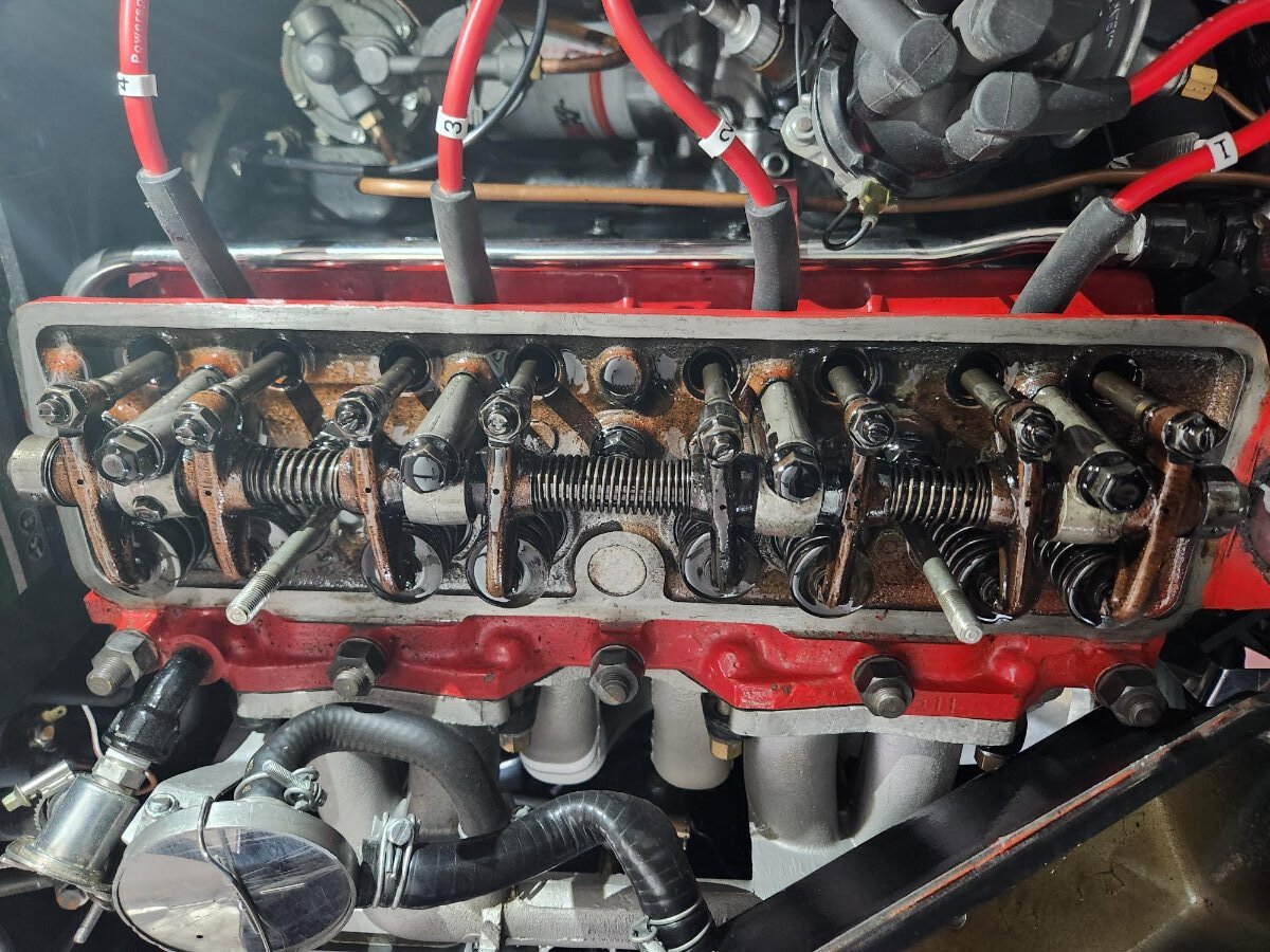

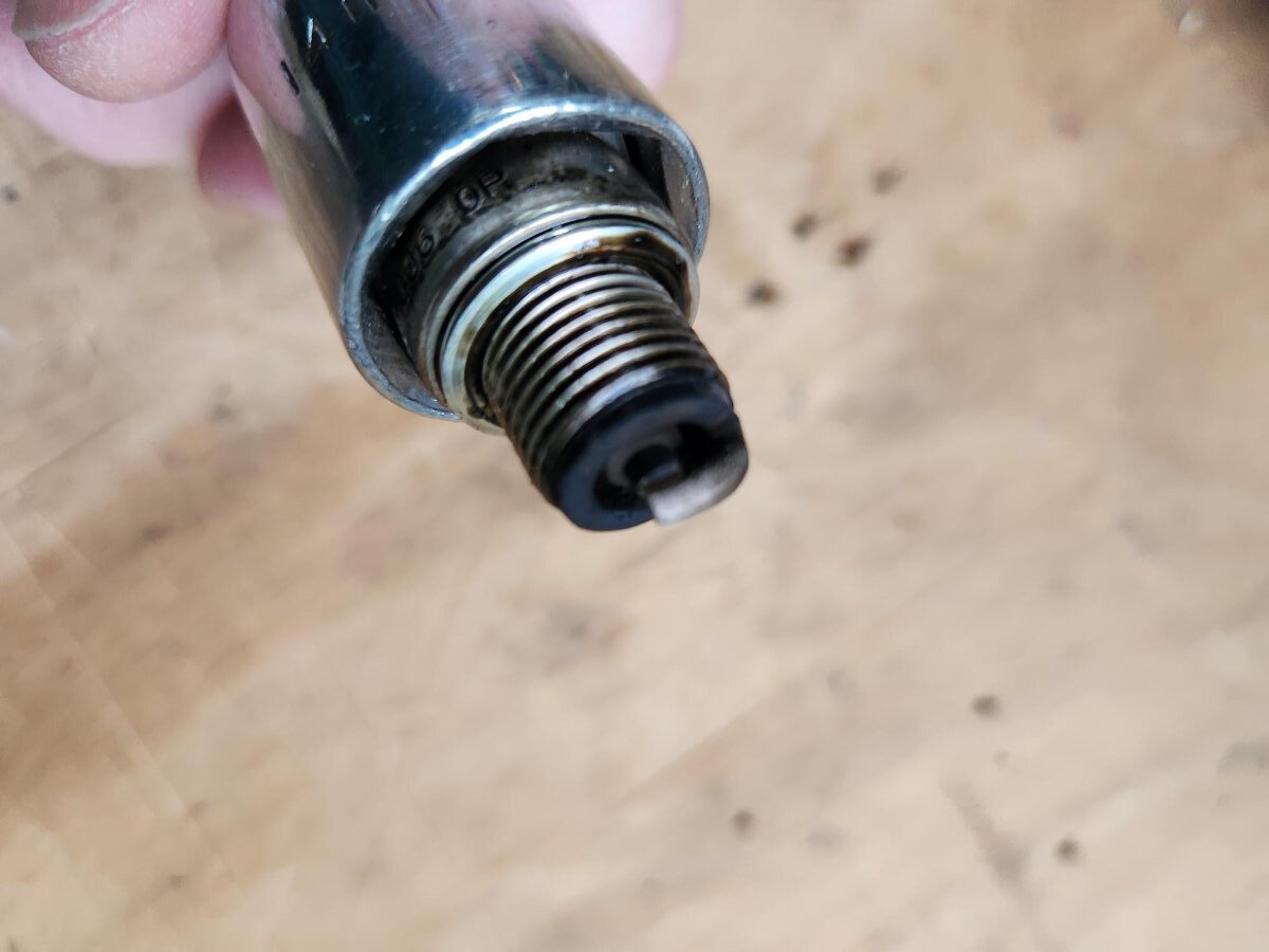

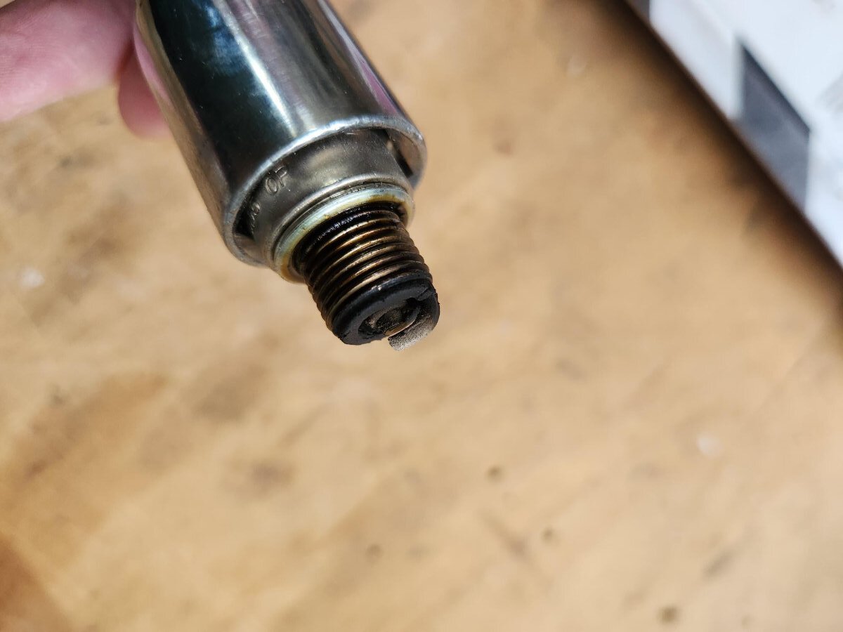

qkingston Posted June 19 Author Report Posted June 19 OK so the results are in: Compression test: #1 189psi, #2 184psi, #3 190psi, #4 190psi Spark plug tips all lok ok? base a little sooty?? Rocker cover off, plenty of oil, no mayonnaise Dont have the kit to do a leak down test yet, but working on it. Any thoughts? Quote
Chilliman Posted June 19 Report Posted June 19 Nothing wrong with those figures, still looks like valve guides to me. I started off the season chucking clouds of oily smoke out the exhaust & fitted a set of guide seals and all good ever since. Quote
qkingston Posted June 19 Author Report Posted June 19 Thanks John, I think its pointing that way Regards David Quote
