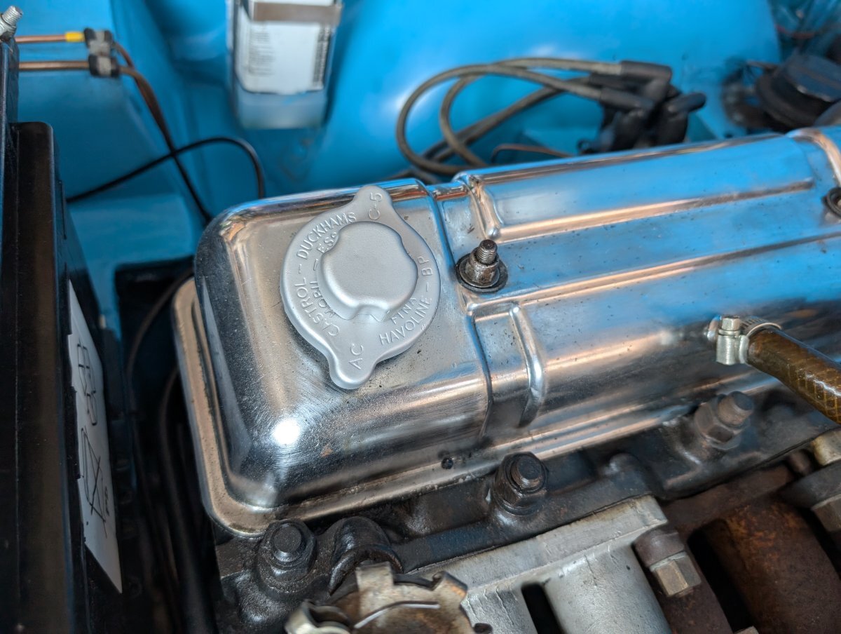

Z320 Posted June 22 Report Posted June 22 David, some photos of your PCV valve could be usefull. On my photo you see the rubber membran. The coned valve pin is fixed on the steel disc and may glue there by oil without problem. But the rubber membran must not glue in the steel disc cover. Quote

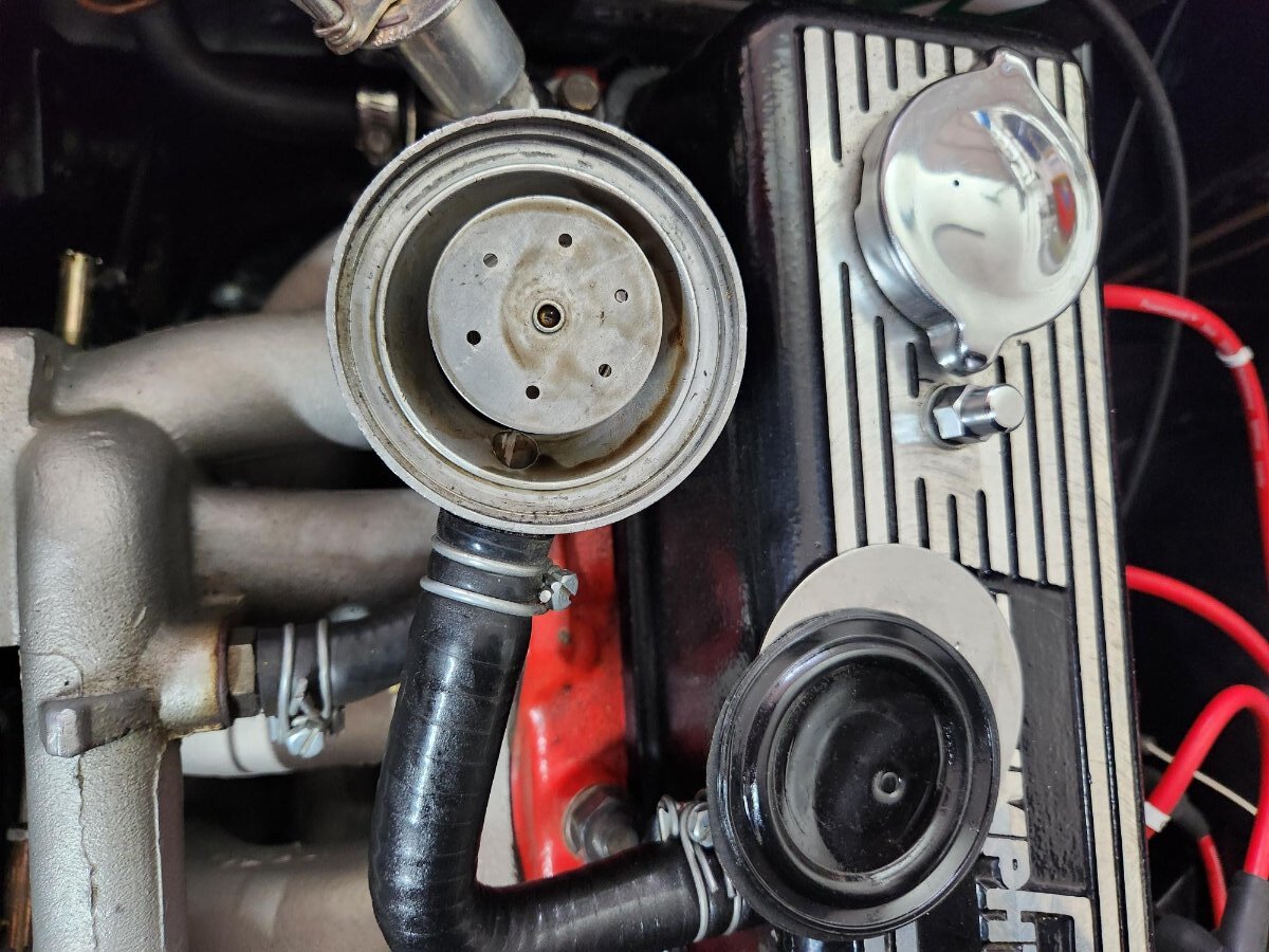

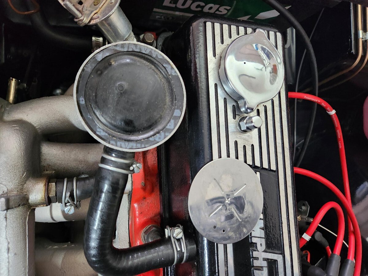

qkingston Posted June 22 Author Report Posted June 22 A couple of pics of my PCV, in the 1st one, the metal disc I was referring to is on the rocker cover. Does that help at all? David Quote
Z320 Posted June 22 Report Posted June 22 (edited) Hi David, on the 2nd photo, why does the steel shim with the valve pin not flip out? There must be a spring between. I could not make such a photo. And you have an aluminium cover fitted, very likely without oil seperator baffle, not at all like on the original steel cover. This allows more oil going to the PCV valve (to be seperated there), perhaps too much? Ciao, Marco Edited June 22 by Z320 Quote

qkingston Posted June 24 Author Report Posted June 24 On 6/22/2026 at 5:09 PM, Z320 said: Hi David, on the 2nd photo, why does the steel shim with the valve pin not flip out? There must be a spring between. I could not make such a photo. And you have an aluminium cover fitted, very likely without oil seperator baffle, not at all like on the original steel cover. This allows more oil going to the PCV valve (to be seperated there), perhaps too much? Ciao, Marco Hi Marco, yes there is a spring underneath the Valve pin. The cover plate is the only one I could find when I fitted the PCV (mine was missing - removed by PO), does that make a difference? Also I have fitted a replacement diaphragm and the previous symptoms seem to have disappeared!! Would that make sense? Also the vented oil filler cap (as seen in the photos above) is the only one I could find that fitted the Triumphtune rocker cover. I did get a refurbished original filler cap from Rich C-R, but the fitting was different and I had to return it . I assume the vent hole in the filler cap I have is adequate to allow the crank breathing to work properly?? Regards David Quote
Lebro Posted June 24 Report Posted June 24 25 minutes ago, qkingston said: Hi Marco, yes there is a spring underneath the Valve pin. The cover plate is the only one I could find when I fitted the PCV (mine was missing - removed by PO), does that make a difference? Also I have fitted a replacement diaphragm and the previous symptoms seem to have disappeared!! Would that make sense? Also the vented oil filler cap (as seen in the photos above) is the only one I could find that fitted the Triumphtune rocker cover. I did get a refurbished original filler cap from Rich C-R, but the fitting was different and I had to return it . I assume the vent hole in the filler cap I have is adequate to allow the crank breathing to work properly?? Regards David The cover plate for the PCV looks correct, with the cross in the center, Also, a vented oil filler cap is correct, it's to let fresh air into the engine. Only works as it should with no snorkle breather. Bob Quote
