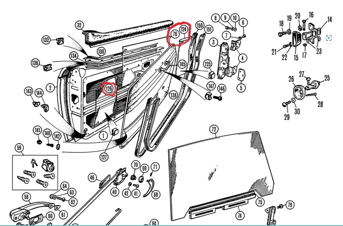

However, I'd like to ask for a few tips. My door curtains are long gone, with the doors & mechanisms in a serviceable state. I don't want to remove the glass, but is there a way I could fudge curtain replacements? I have a vague scheme to cut a section of bin liner, glue a plastic strip & somehow clip on with bulldog clips? Or ...?

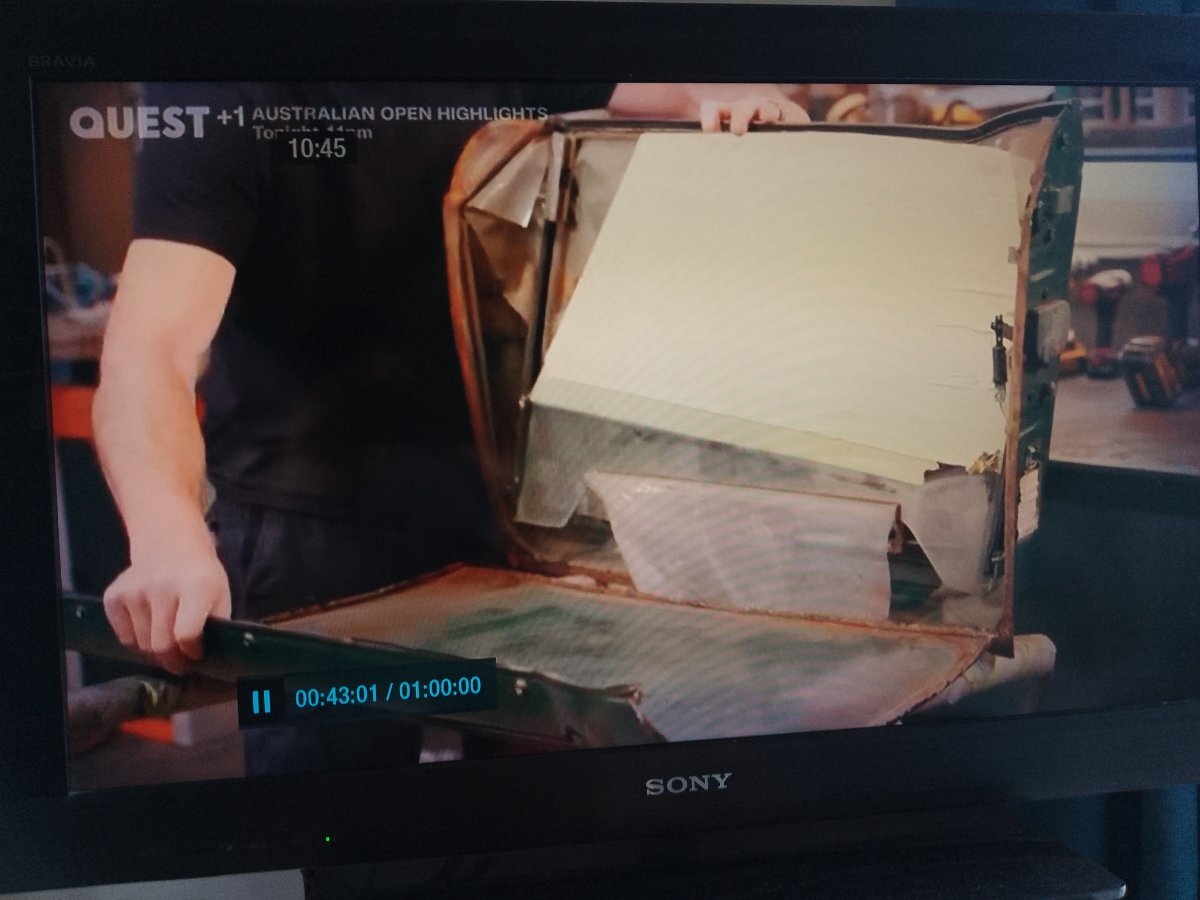

Attached is the door diagram with the curtains as parts 76, 124 & 126, and a snap from the TV where Ant Antstead of Wheeler Dealers was replacing the door skin of a '4. The picture, which is a bit unclear, shows (I think) the curtains at the bottom of the door. The large light coloured area is I think card or similar to protect the glass from the skin removal operations. We are looking at the door from the outside in.

Think it's been said before. Just stick a piece of polythene to the inside of the door card. The drip sheets don't stop water coming into the door. Are they there to prevent water getting on the winder mechanism ? Just make sure its  well greased  I never fitted any on my 4a and it's  fine inside the doors
Dale
