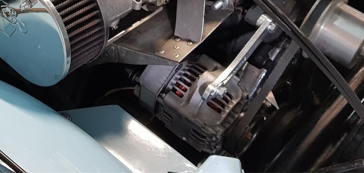

North London Mike Posted June 23 Report Posted June 23 1 hour ago, PaulAnderson said: I bought a 40A Nippon Denso unit myself, purchased from someone but it ultimately came from Bastuck , here on their shop. There’s no worries about the diodes overheating like you can get on others ( minimised with a heat shield - unnecessary with the Nippon Denso unit) and it’s been faultless for years. +1 for the 40A Nippon Denso, good solution for the heat soak problem for the 4 pots fitted with Lucas units (note the Roger Hogarth heat shield fitted when I originally had a Lucas unit) Quote
