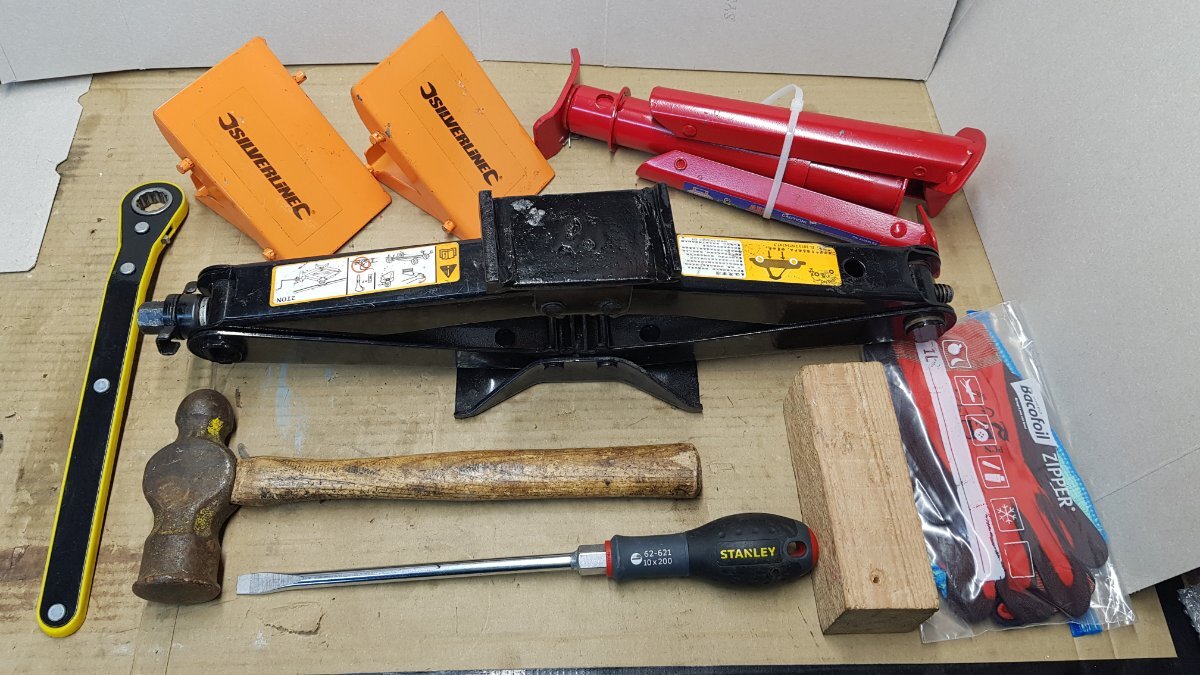

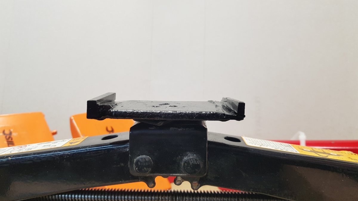

North London Mike Posted June 25 Report Posted June 25 This is similar to mine, small enough to fit under the TR chassis and also pack into the TR (my preferred spot is on the floor behind the passenger seat), in a suitable bag with some other kit (chocks, brace, ratchet drive etc) Not electric, but less bulk and with a socket set and extension plenty of torque to get it lifted. Final mod was to remove the lifting block and weld in a modified bracket designed to take the chassis width. Whilst you're there, think about a collapsible axle stand https://www.amazon.fr/-/en/71502-Diamond-Handle-Mechanical-Ratchet/dp/B01LETDSWM/ref=pd_rhf_ee_s_pd_sbs_rvi_d_sccl_2_14/520-5243473-8928269?pd_rd_w=YI1mh&content-id=amzn1.sym.be9bed83-67ee-4372-ab45-33731bdebce9&pf_rd_p=be9bed83-67ee-4372-ab45-33731bdebce9&pf_rd_r=F81466B1F0E66JB30913&pd_rd_wg=TfPZN&pd_rd_r=05325b37-17ad-45ab-b1ee-ed275bb06c87&pd_rd_i=B01LETDSWM&psc=1 Quote

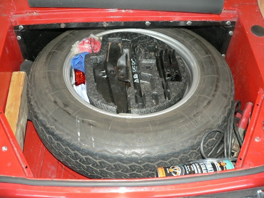

Bfg Posted July 1 Report Posted July 1 Space is always the issue for me, and so for the number of times I hope to use it, I went for most convenient storage rather then electrical assistance. The kit contains the low profile scissor jack (which fits under car or camping trailer) and its ratchet handle, as well as two fold out wheel chocks, and the telescopic-handled wheel-nut spanner (again for the trailer). There's space under and around the expanded polystyrene packing for the emergency flashing light. rags and hand cleaner, spare (fat-type) tyre valve, an LED torch, and a number of other bits n' bobs. In the wheel well, aside from jump leads, I also carry an emergency tyre inflator (foam), the lump hammer & timber block (for the wire wheel spinners) and a block for soft ground and for against the chassis, as well as a rubber mat to kneel on. Quote
