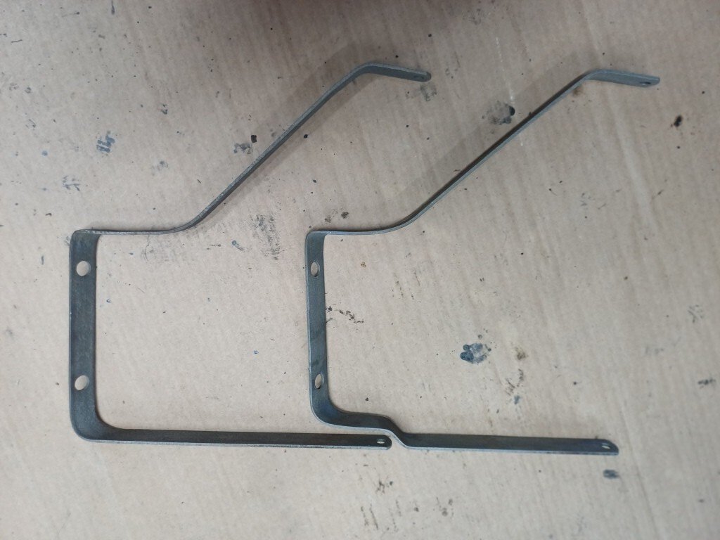

Tim T Posted June 25 Report Posted June 25 I have a choice of 2 brackets to use on my TR5 project car, as in the photo. The one with the 'kick' in the straight side is, I believe, correct for the a 5, but what is the other one. Does it matter? Is it just one of Triumphs idiosyncrasies? Many thanks Tim Quote

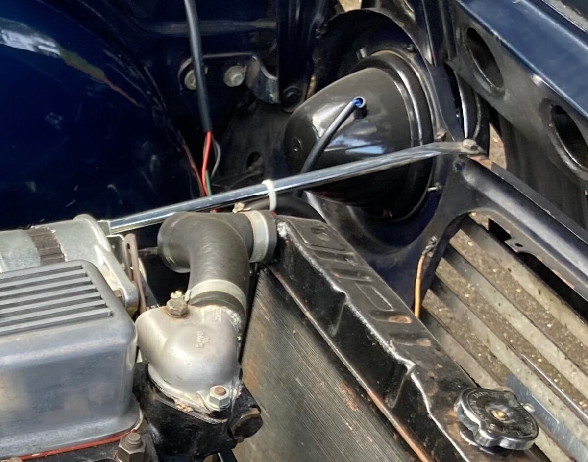

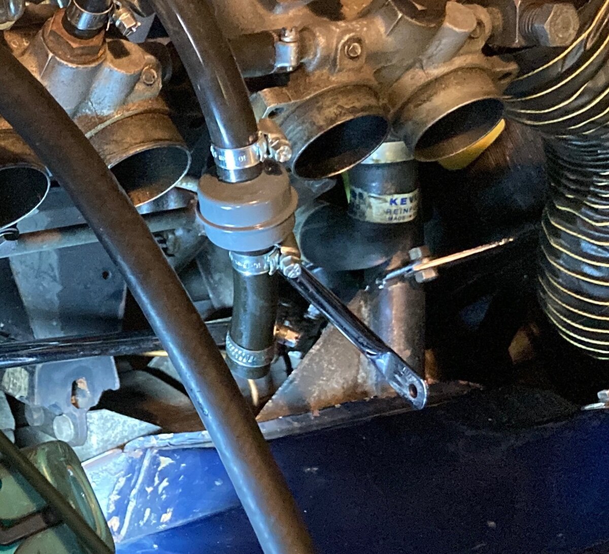

Peter V W Posted June 26 Report Posted June 26 Tim, Not easy to get a good photo. The chrome finish is not standard. Peter Quote
Tim T Posted June 26 Author Report Posted June 26 Wow! That’s very different but very smart. Cheers, Tim Quote

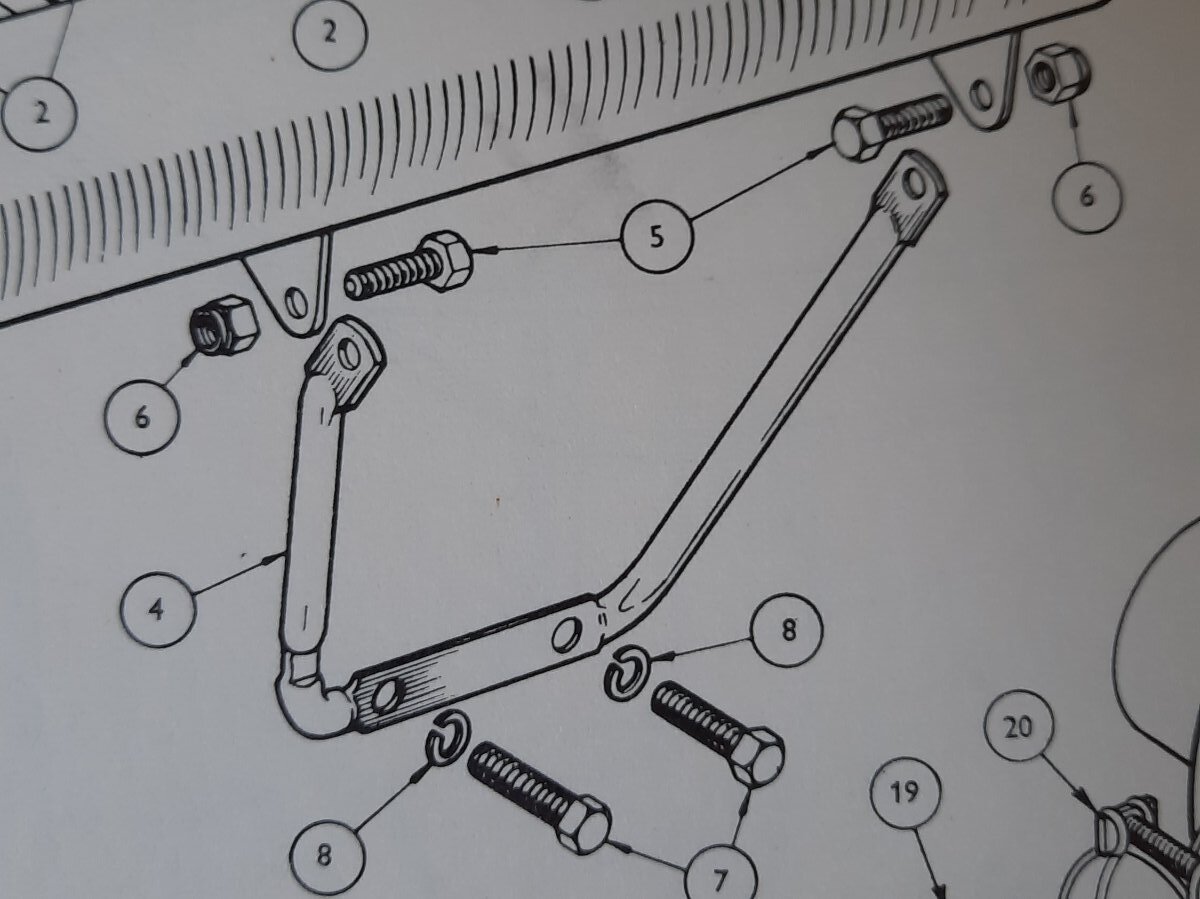

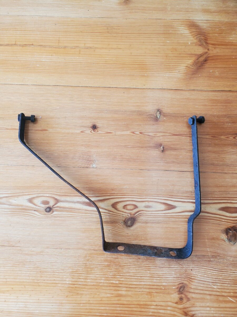

Tim T Posted June 26 Author Report Posted June 26 That is the first time that I have seen a tubular bracket, yet the drawing in the original parts book seems to suggest a tubular construction. In fact, I have 3 of the brackets as in the photos. Cheers, Tim Quote
jerrytr5 Posted June 26 Report Posted June 26 Why would you even want it? Almost impossible to fit unless you have the hands of a child and serves no purpose. Jubilee clips on the inlet ports hold plenum fine. At least mine has never fallen off in the last 45 years without it. Jerry Quote
Peter V W Posted June 27 Report Posted June 27 Tim, Looks like Jerrytr5 has the correct tubular bracket, surplus to requirements. Not used for 45 years. Surely he would let you have it for free? Peter Quote
Tim T Posted June 27 Author Report Posted June 27 1 hour ago, Peter V W said: Tim, Looks like Jerrytr5 has the correct tubular bracket, surplus to requirements. Not used for 45 years. Surely he would let you have it for free? Peter 🤣 I have never ever seen a tubular one. My project is definitely not a concours effort so I will go with one of the brackets that I have. Thanks for all your answers anyway. Cheers Tim Quote
jerrytr5 Posted June 27 Report Posted June 27 No tubes in mine. Guess design was changed during production. Mine is a '68 car not '67. Jerry Quote
Dave I O W Posted June 27 Report Posted June 27 Mines a tubular bracket, Car built on the 12th January 1968 Quote
Tim T Posted June 27 Author Report Posted June 27 (edited) Project car was built on 19th September ‘68, ie last day of production. Road car July ‘68. Both with ‘flat’ brackets. Tim Edited June 27 by Tim T Quote
