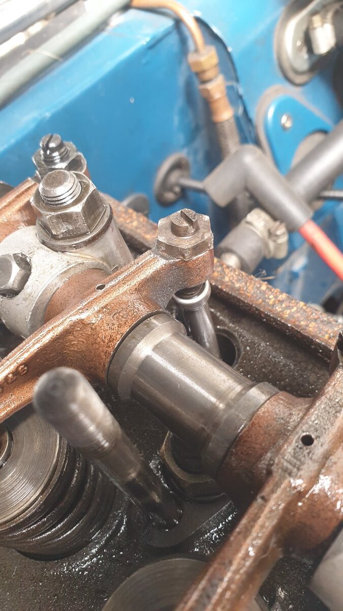

Just giving the car a quick check over - compression tests, plug cleaning & colour check, then I thought I would check the valve clearances.

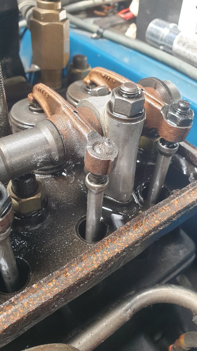

All going well until one of the locking nuts would not tighten up. The adjuster screw had sheared just below the nut. (probably overtightened by me)
So, Has anyone got a spare 4 pot adjuster to hand before I have to order 8 at £32 + postage (from Moss) or £10.25 including postage for 1 from Rimmers

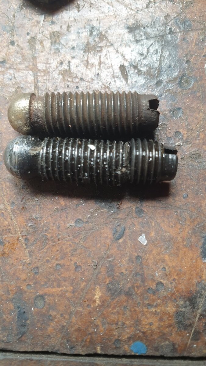

The offending part.
Well, 2 would be good !
Thank you very much.

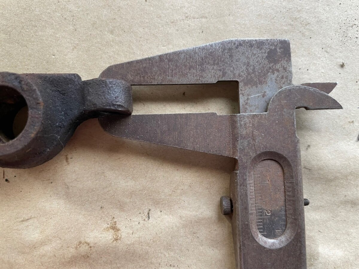

hmm a bit shorter than the one I took out, not sure if I have enough thread. Will carefully assemble to check. My shaft, & rockers came as an assembly from The TR shop. So not NOS.
Bob
They may well have come from a low port engine as well I dont know if that makes any difference, definitely original though.
Measurement at the adjuster end in the rocker they came off is 3/8”
Stuart
I'm sure it's because it would be an aftermarket shaft assembly. All good though.

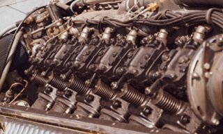

There are at least 2 different length screwed adjusters used on Triumph cars.   I went through this when I got roller rockers and the supplied adjusters were too short.
Another trick is to fit the lock nut under the arm instead of on top.   That gains a nuts thickness of adjustment    As can be seen employed here on no 1 on my friends 27 litre aero engined car.
