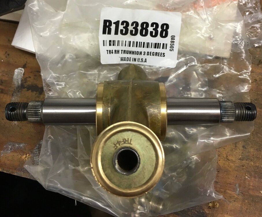

RogerH Posted July 2 Author Report Posted July 2 Hi folks the TRunnion turned out to be a right little devil. The S/S SuperPro S/S sleeves were seriously welded to the bolt and somebody put SuperGlue on the bolt to TRunnion hole. It was solid. The Vertical Link was stuck in the TRunnion. I could rotate the VL apprx 20' each way and no more. So, I purchased a used OEM TRunion that had an excellent fit on a used VL plus a new bolt and Superflex bushes and S/S sleeves Later in te day (today) I managed to get the VL off the TRunnion by cutting the trunnion in half. The VL threads were coated in a black dry substance that needed serious wire brush cleaning. Once clean I could see that the plain portion of the thread shank was corroded - no bad pitting but and even coat of deepish rust. Worse still the threads had been partially eaten away. So what went wrong Just before Covid the left lower wishbone attachment stud failed and resulted in a bent VL. A new VL was fitted and the assembly worked very nicely. But I did nothing to the off side suspension with regard servicing. Roll on another 6 years and the OffSide has not been serviced properly for 10+ years. The grease solidified, the steel started to rust and in general it became a dogs breakfast. Tomorrow I shall get a replacement VL and re-assemble the suspension. Question - what is the best grease to put the TRunnion Aren't cars fun. Roger Quote

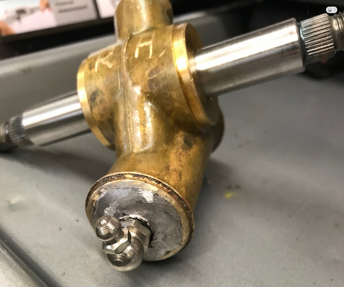

BlueTR3A-5EKT Posted July 2 Report Posted July 2 I have been a user of EP140 for some time. As stated. Pump in until it oozes out. I silver soldered the steel caps in the bottom of the trunnions when I put the suspension on back in 2004. That stops the oil leaking out or worse still the cap popping out when the grease/oil pressure gun is applied. Sounds like you need a planned maintenance procedure Roger. Quote

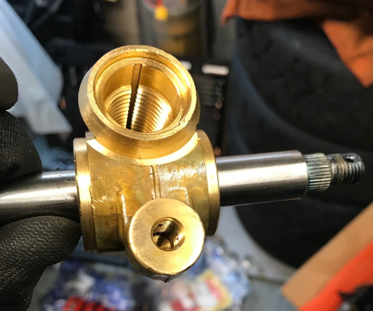

Hamish Posted July 3 Report Posted July 3 (edited) When I introduced some castor into my 3a suspension I sealed the bottom of the trunnions with solder. So I had grease / oil options in the future but I have only used lm grease liberally pumped until the clean grease squidges out and whilst I haven had them apart in the 6 years it seems to be ok. note the groove up the thread in the trunnion that is supposed to distribute the lubricant of choice oh yeah - it’s not the separate bolt type trunnion Edited July 3 by Hamish Quote

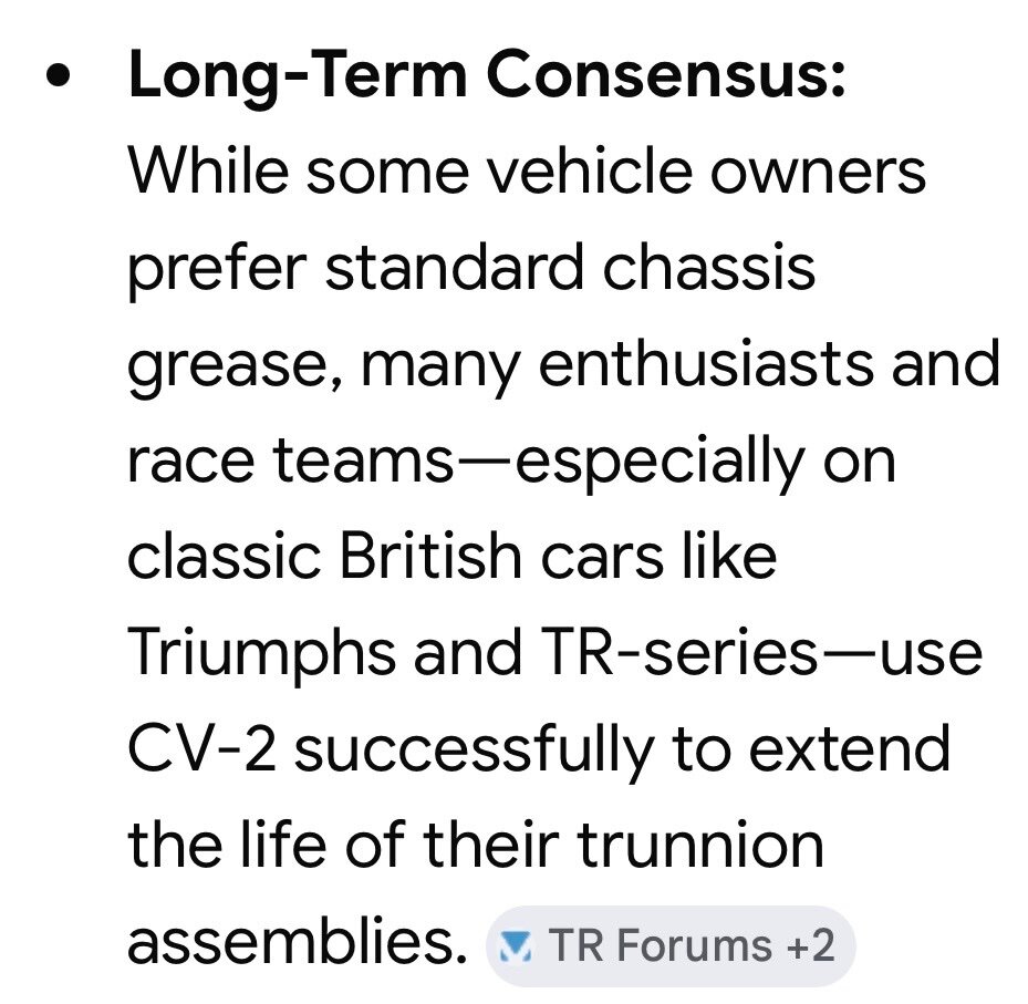

PriceLes Posted July 3 Report Posted July 3 I was going to buy Penrite semi fluid grease for the rack and pinion and see it is also OK for the trunnions but found this in a search and happen to have pot on the shelf? Quote

Lebro Posted July 3 Report Posted July 3 Following this thread, & having some spare time, I jacked up the front, & greased the outer wishbone ends (no problem), the offside trunnion (no problem) tried to grease the nearside, & although I had soft soldered the base to the body, it sprung a leak, & most of my applied grease shot out sideways. Some did make it through to the top, but I think before the Malvern trip I will take that side apart, & re-solder the base. Bob Quote
Hamish Posted July 3 Report Posted July 3 8 hours ago, PriceLes said: I was going to buy Penrite semi fluid grease for the rack and pinion and see it is also OK for the trunnions but found this in a search and happen to have pot on the shelf? That’s a proper google AI summary Quote
