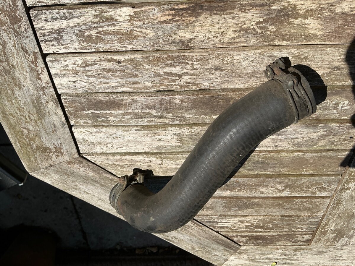

4 minutes ago, Peter V W said:
David,
Alan is correct, black hoses on TR5.
So I’ve had a look at my old original top hose, stored for many years and attach
a photo.
Peter

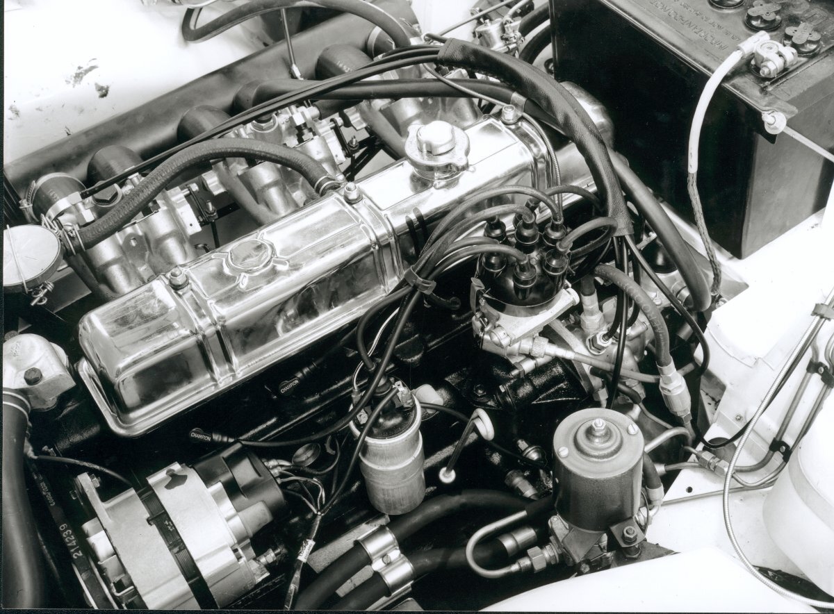

Roy, the TR5 press release pack images and the TR5 brochure show the servo hose as the only hose with a yellow stripe. Attached for info is a factory image of one of the press car engine bays, this shows the yellow stripe on the hose (in black & white). For those interested it is negative number 71947 taken  on the 27th September 1967. Some of the other details in the image might be of interest to those concours car owners.
Derek
Interesting to see the PRV inline on the tank return from the metering unit and also that a PCV is also fitted in the same place as it was on my TR250 when I bought it and that it has an oil cooler fitted too.

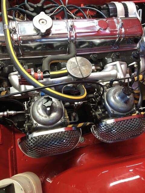

This is how it was originally fitted (First picture) it didnt really do anything more than dump engine condensate down the front of the engine, obviously not how Triumph had them fitted originally and then after I had rebuilt all the linkages and generally sorted all the engine out I fitted it as per the second photo and it worked really well there.
Clever.
PCV tipping downwards in line between engine and inlet manifold and that is ‘T’d at the manifold with a non return valve to the servo.   Good reinterpretation.
