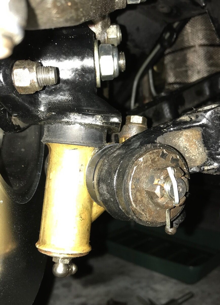

RogerH Posted July 5 Report Posted July 5 2 hours ago, Hamish said: No Peter if they are still supple use them I used your type that last time I rebuilt mine. Hi Hamish looking at your split pin tails. Try keeping them short (ish) If you were to run your hand around the wishbone attachment you may well come to grief The tail running down the side of the nut need only go as far as the washer and the one across the top going to the centre of the bolt. Or invest in Elastoplast Another area of concern is the plastic tie strap. When one cuts off the unused tail make sure it is flush with the locking device. These ends can be very sharp Roger Quote
Hamish Posted July 5 Report Posted July 5 (edited) 2 hours ago, Lebro said: Is that a 3° castor trunnion Hamish, if so where was it from. Mine (from the TR Shop) did not come with split pin holes, but used nylock nuts instead. I would have prefered the split pin type. Bob. Bob my records suggest it was 2020 ( doesn’t time fly when your are getting old) and they were a Black Friday sale from Rimmer. 35 minutes ago, RogerH said: Hi Hamish looking at your split pin tails. Try keeping them short (ish) If you were to run your hand around the wishbone attachment you may well come to grief The tail running down the side of the nut need only go as far as the washer and the one across the top going to the centre of the bolt. Or invest in Elastoplast Another area of concern is the plastic tie strap. When one cuts off the unused tail make sure it is flush with the locking device. These ends can be very sharp Roger thanks Roger noted Edited July 5 by Hamish Quote

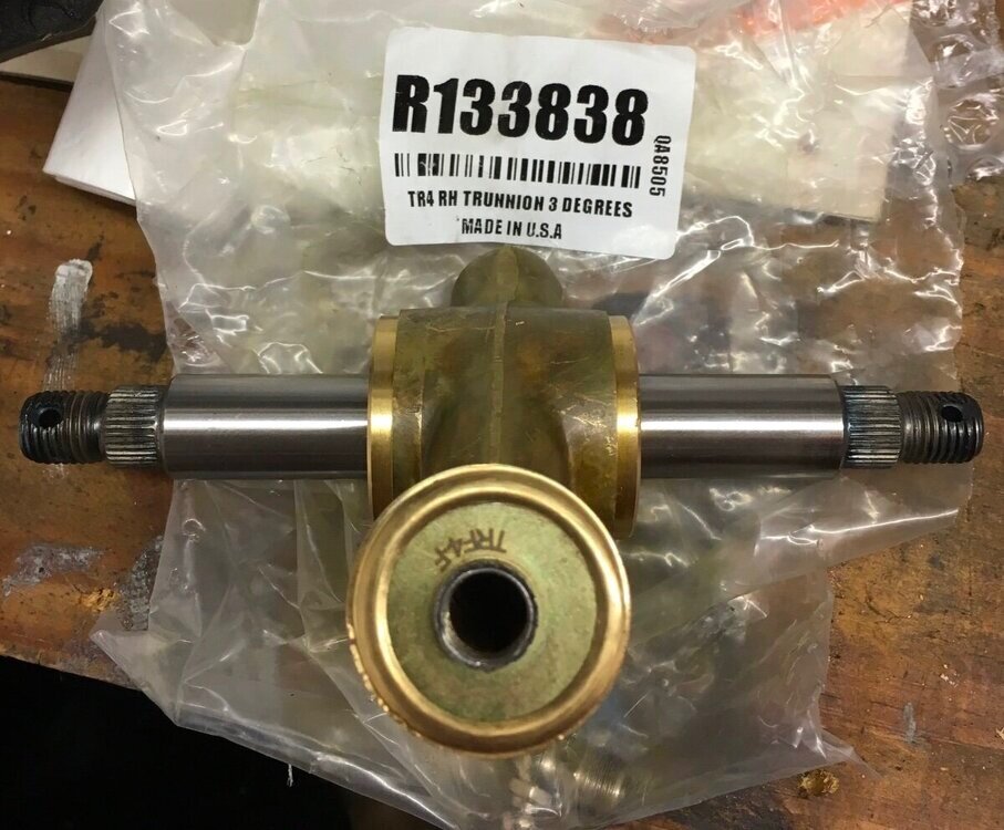

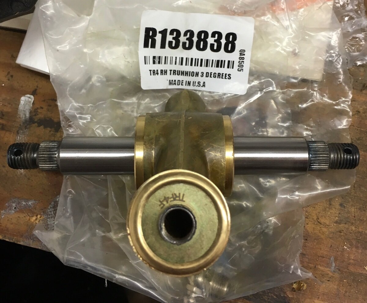

BlueTR3A-5EKT Posted July 5 Report Posted July 5 Roadster Factory then for TR2-3-4. TRF stamped on the grease cap. Quote
