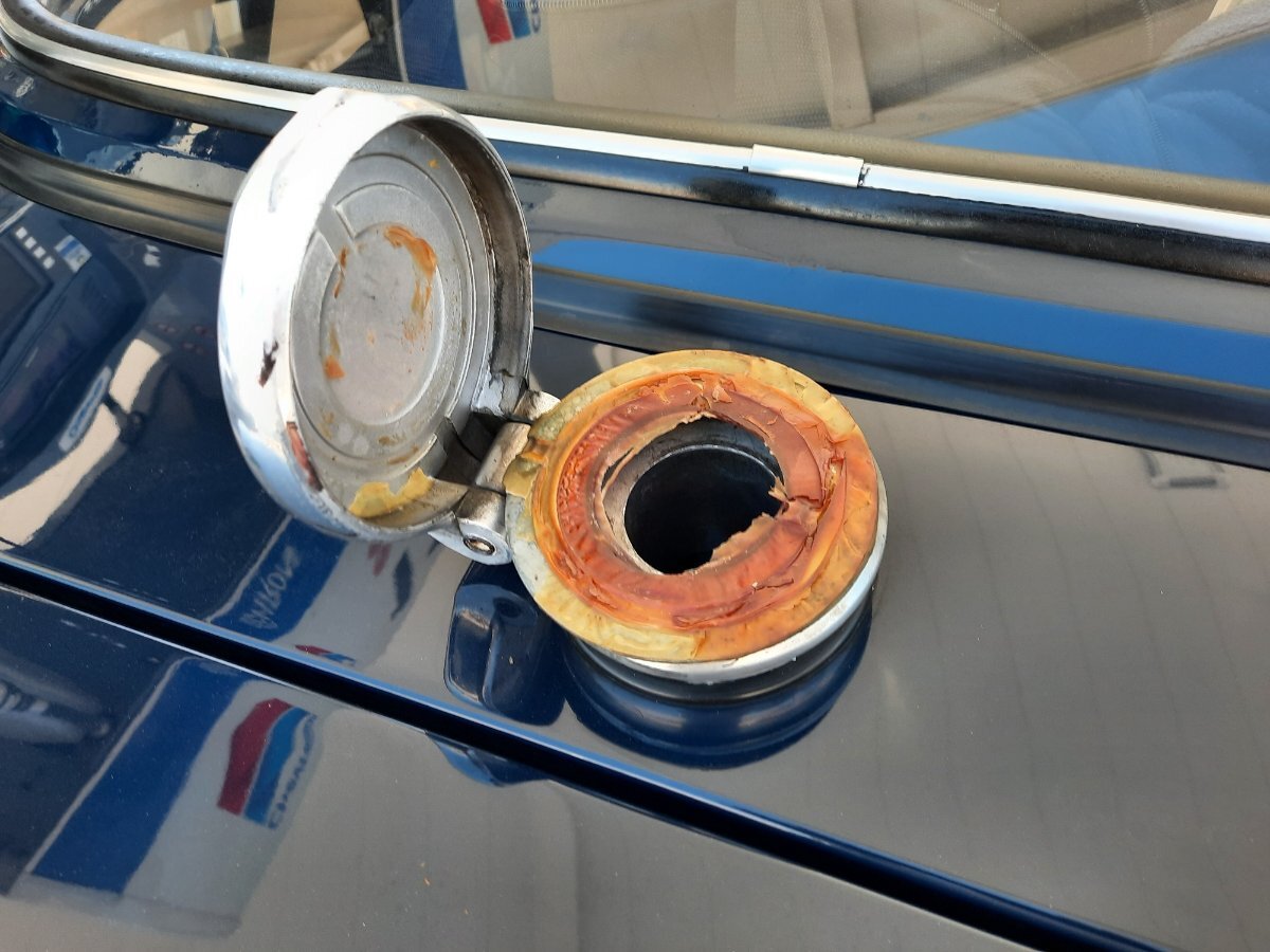

We have just returned from a 1400 mile trip to the 'All Triumph Drive In' in Madras, Oregon. The air temps were in the high 30s during our trip, metal bits were considerably higher. On the last day I went to fill up with petrol, I found that the glue? holding the magnet in the cap had lost its bond, it wasn't soft, in fact it was crispy but no bond. I was wondering if anyone experienced similar during the recent high temps in the UK?
Any thoughts on the best adhesive to use resetting the magnet.

I repaired the magnet on my TR250’s fuel cap about five years ago with a good quality two-component epoxy, @graeme.. I used a filled epoxy to minimize any shrinkage in the adhesive as it cured, but truly any grade should work with well-cleaned surfaces.  The epoxy cured with the cap closed to ensure the toroidal magnet and the steel closing surface were flat and parallel.  One can see a bit of the epoxy extruded from the edges of the magnet here;
The cap is on my office bookshelf now living an easy life, not on a car, but the repair has held perfectly.

Hi Graeme,
for me it looks like the magnet has been fixed with PU glue.
And this has failed because of its age and heat. I would try to glue this with a 2 components glue.
Ciao, Marco

Thats a 250 very early US 6 fitment only and as stated thats a glued repair and I wouldnt have said original.

I’d have guessed original adhesive, Stuart. My TR250’s cap looked similar — sort of an ambered brittle film — and I’ve had the cap almost fifty years.

Thanks for the epoxy suggestions, I will try that.
