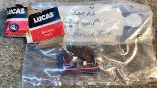

BlueTR3A-5EKT Posted July 4 Report Posted July 4 Did you get carbon brushes with the kit? if not I have a NOS Lucas set with baseplate and screws. £15.00. Including 2 nd class postage to UK. I also have the plastic drive coupling which I’ll throw in Quote

BlueTR3A-5EKT Posted July 4 Report Posted July 4 (edited) 34 minutes ago, Kevo_6 said: I bought this kit https://triumphspecialtuning.com/product/lucas-petrol-injection-fuel-pump-repair-kit-triumph-tr5-pi-tr6-pi-and-2-5pi/ So I assume so, if not I’ll have them off you. Cheers Kev. Looking at the photo on the web page. Yes that kit has the two carbon brushes loose, so you have to solder into place on your old baseplate to your existing wiring. Edited July 4 by BlueTR3A-5EKT Quote

k_raven_smith Posted July 5 Report Posted July 5 Only use oil not grease. That base plate was originally for a wiper motor not a pump motor. The brushes are of a softer carbon. Quote
Kevo_6 Posted July 5 Author Report Posted July 5 40 minutes ago, k_raven_smith said: Only use oil not grease. That base plate was originally for a wiper motor not a pump motor. The brushes are of a softer carbon. Thanks Neil. Quote
BlueTR3A-5EKT Posted July 5 Report Posted July 5 Thanks Neil. I had that conversation with Ken Mills 45 years ago when sourcing carbon brushes for Lucas pumps. i thought 3 brush base plates were for wiper motors not the 2 brush base plate I have. Quote

super6al Posted July 7 Report Posted July 7 Hi Kev Those rebuild kits are poor quality & expensive in my view. The screws provided are self tapper while the Lucas ones are threaded. The carbon brushes don't fit in the holding slots as the copper wire enters 90* to the brush (Lucas ones have the copper wire perpendicular to the brush). To cap it off the viton seal was missing from mine. You can buy all the above from Amazon or Ebay for a few quid . Alan Quote
