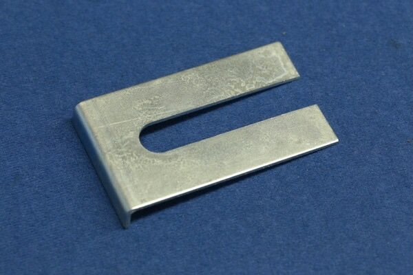

Steve 286 Posted July 5 Report Posted July 5 To add camber I would fit more shims behind the bottom wishbone brackets Quote
BlueTR3A-5EKT Posted July 5 Report Posted July 5 I specified a batch of vertical posts machined to set the stub axle at a different angle to change the camber. The first set are in my TR3 and work fine. I have no idea if Moss continued with the small batch production for the performance inspired owners. Quote
Casar66 Posted July 5 Author Report Posted July 5 (edited) 9 minutes ago, Steve 286 said: To add camber I would fit more shims behind the bottom wishbone brackets Ok, I do understand, with that you add "negative camber", right? Means, without adding or losing shim or bending (the vertical link due e.g. a crash) the camber can not change? Edited July 5 by Casar66 Quote
Steve 286 Posted July 5 Report Posted July 5 Yes that is right to get more negative camber you add shims with modern tyres I try to get 1 to 1 1/4 degrees negative camber both sides the shims are easy to make yourself if you undo the nuts going through the chassis from the bottom wishbone bracket you can pull the shims out or add more in so no need to totally disassemble Quote
Steve 286 Posted July 5 Report Posted July 5 I forgot to say always put the same amount of shims on the same side front and back wishbones Quote
Casar66 Posted July 5 Author Report Posted July 5 This sounds logical to me. Can I use just ordinary washers as shims? Quote
PodOne Posted July 5 Report Posted July 5 2 hours ago, BlueTR3A-5EKT said: Racetorations do a rose jointed adjustable top wishbones set. No welding required https://www.racetorations.co.uk/product/rose-joint-adjustable-upper-wishbone-kit-tr2-6/ No just a second mortgage 😂 Quote
Steve 286 Posted July 5 Report Posted July 5 I would make shims as they are slotted so you can slide them in place if you take one out you can use it as a template Quote
Steve 286 Posted July 5 Report Posted July 5 Here is a picture of a shim you could use washers but you would need to remove the wishbone bracket to fit them i wouldn’t recommend using washers Quote
