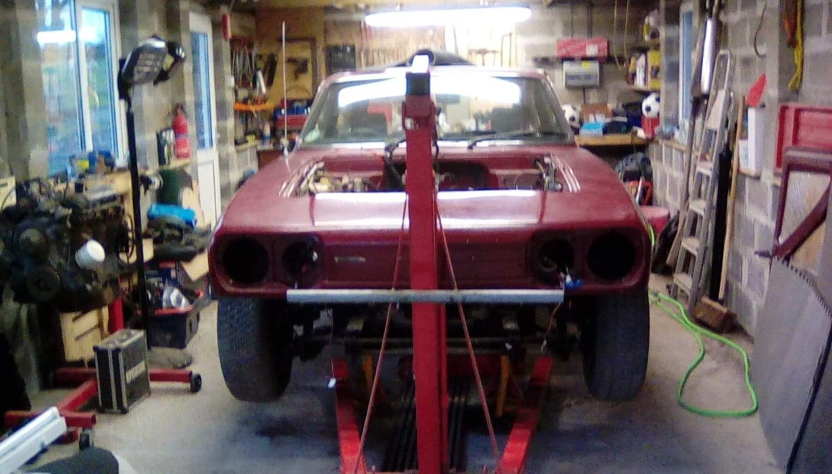

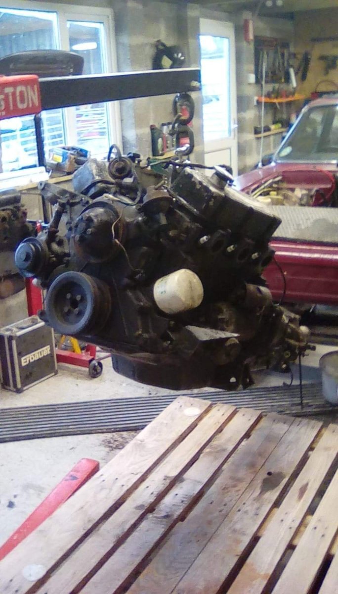

Trev Good Posted July 9 Report Posted July 9 (edited) 2 hours ago, StevecTR4 said: Hi Andy, What area of Lincolnshire are you in. I have used SGS engineering for a few bits including engine crane, stands etc. Finding good competitive service. Most of this type of equipment on the market seems to be from the same source with different stickers. The width of the legs needs a little planning but can be overcome. With wheels removed from the car it comes down to having space and a good surface to roll the crane back. Especially with gearbox still attached. Elevating the rear of the car may help with clearance. Be mindful that the rating of these cranes with extending jib is reduced as it reaches further out. There seems to be low profile versions available that may slide under a TR easier. However academic if the wheels are off. Steve I've always left the crane/engine and gearbox in situ and wheeled the car out from under on all that I've worked on. Photo shows my Scimitar v6 and gearbox being lifted, when the first lift over the steering rack completed, I lowered the car back onto it's wheels and raised the engine hoist higher then pushed the car back. Edited July 9 by Trev Good Quote

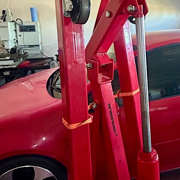

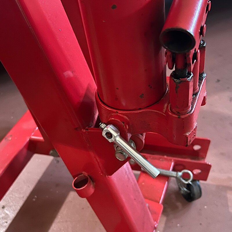

PriceLes Posted Monday at 12:00 AM Report Posted Monday at 12:00 AM (edited) I have no idea what the other guy is waffling on about, I did post the stored ( Ram closed bar a few mm so the body does not contact the frame) footprint as 800x700. The only real mod needed was making an arm for the bleed screw so it could be lowered with some precision. As far as preserving things needed or not, it is simply part and parcel of having machines tools (lathe, mill,CNC mill) so a carry over. By Jove, the bottom section of the ram is stained and probably rarely seen the light of day. An oil change for sure. Edited Monday at 03:31 AM by PriceLes Quote
