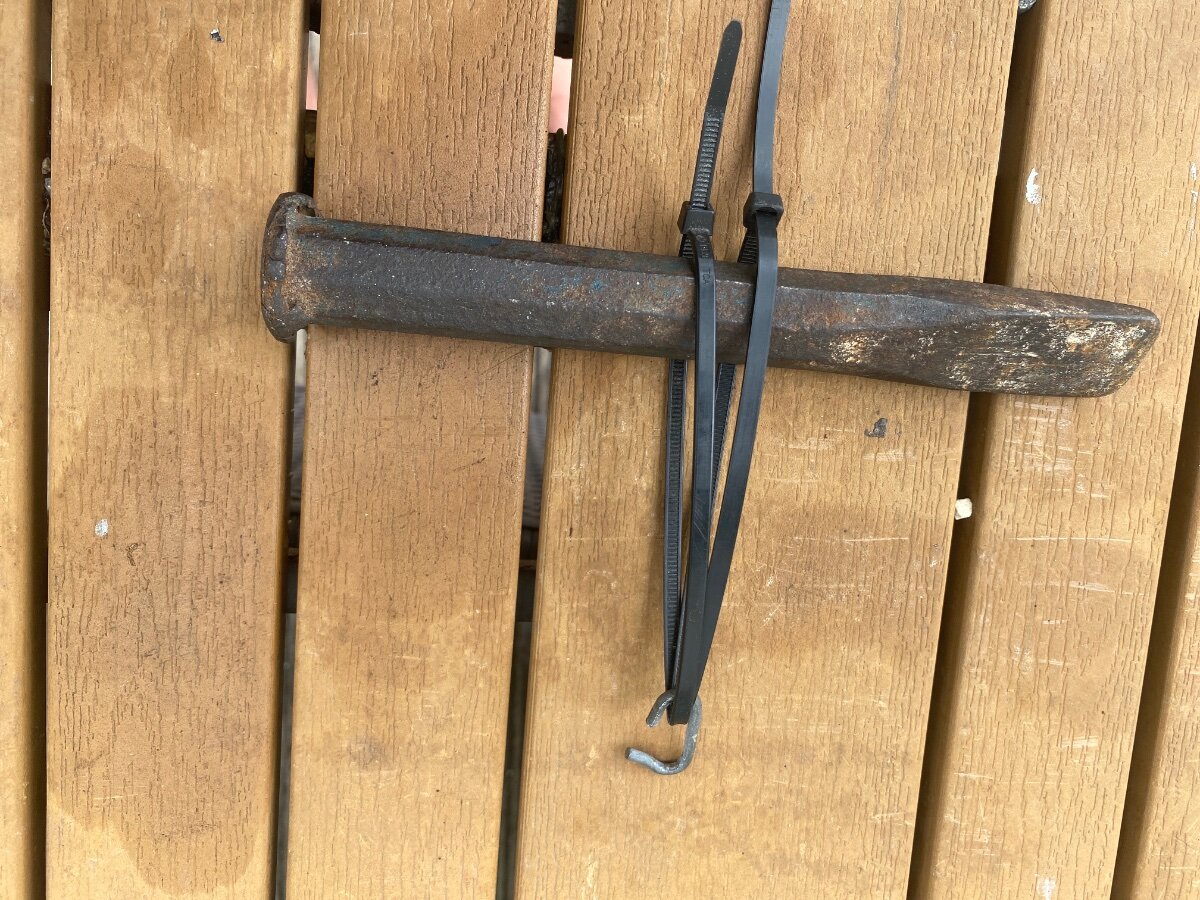

roy53 Posted August 18 Author Report Posted August 18 Well all sorted thanks to a YouTube video musing a steel bar 2tie raps and a seat hook to pull the seat hook to the frame. Quite tough though 10 mins 2 seats and money saved Quote
