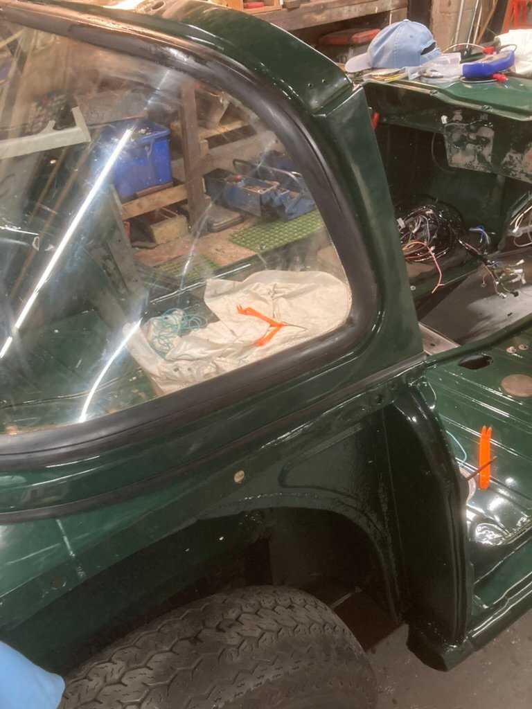

Managed to get my Surrey top rear screen , following instructions from Stuart who I met at the Car fest in Malvern
Made considerably easier by the use of lubricant from a company you may know Durex
Thank you Stuart
