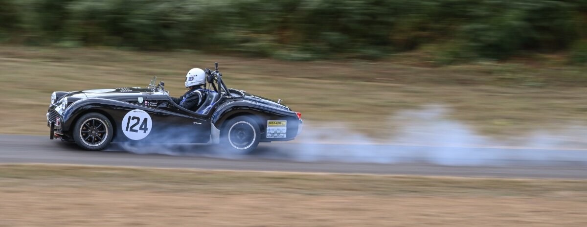

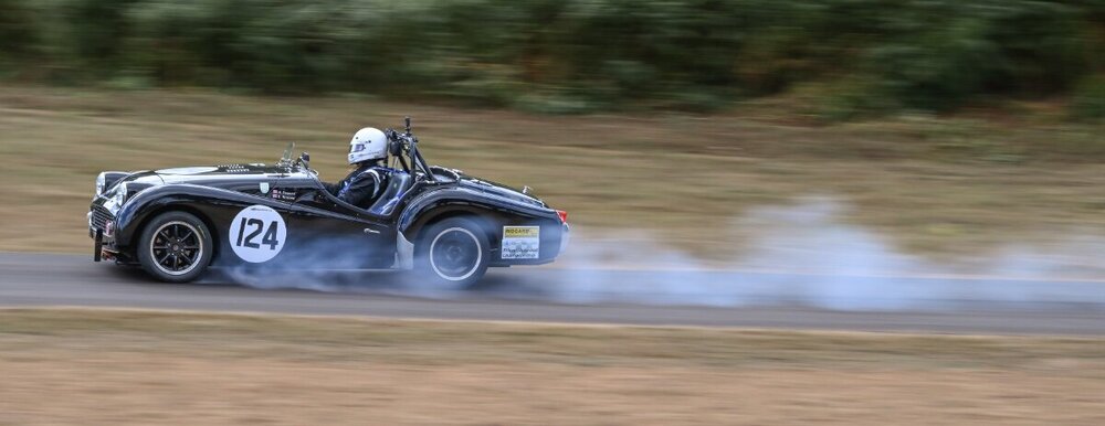

Hamish Posted August 25 Report Posted August 25 (edited) Whilst mine is a 3a the brakes are very good with the right pads. I run very sticky tyres so should be hard to lock with poor brakes. someone kindly shared this picture of me braking a bit too late at Loton park hill climb. Edited August 25 by Hamish Quote
