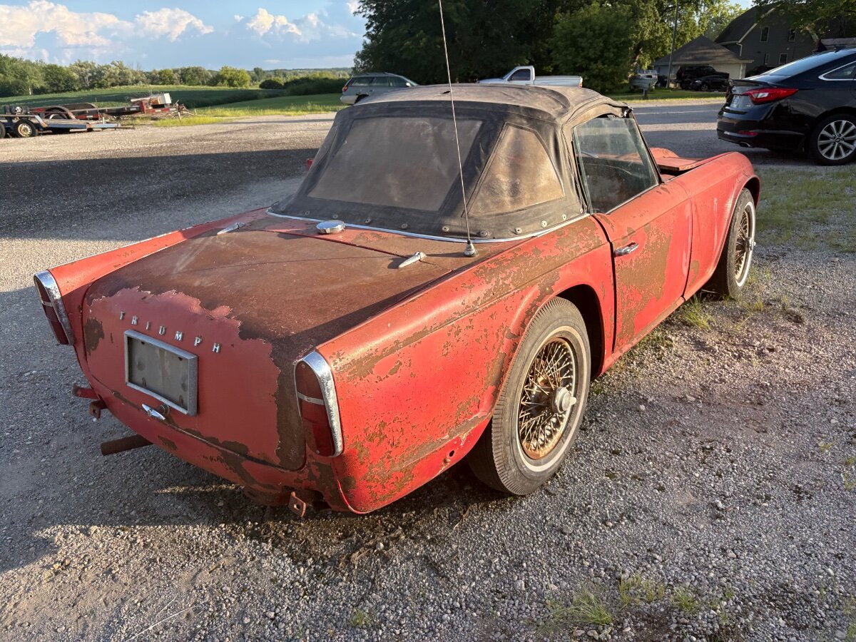

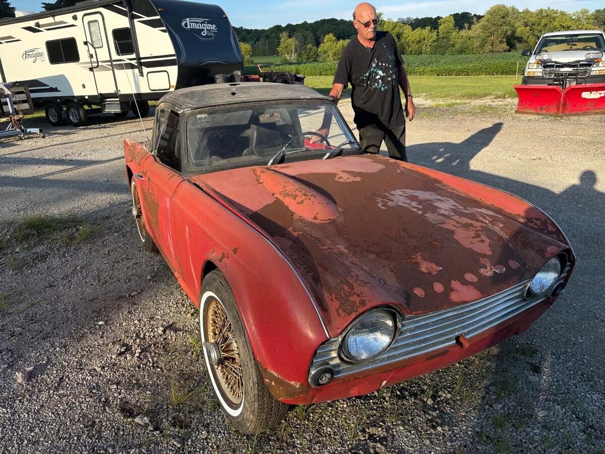

From the pic you would think it’s a rust bucket but it spent 30 years parked in a leaky barn after the engine quit. It’s had two poor repaints,too. Started out as baby blue, then white now red. The paint is flaking off like that on an old house.

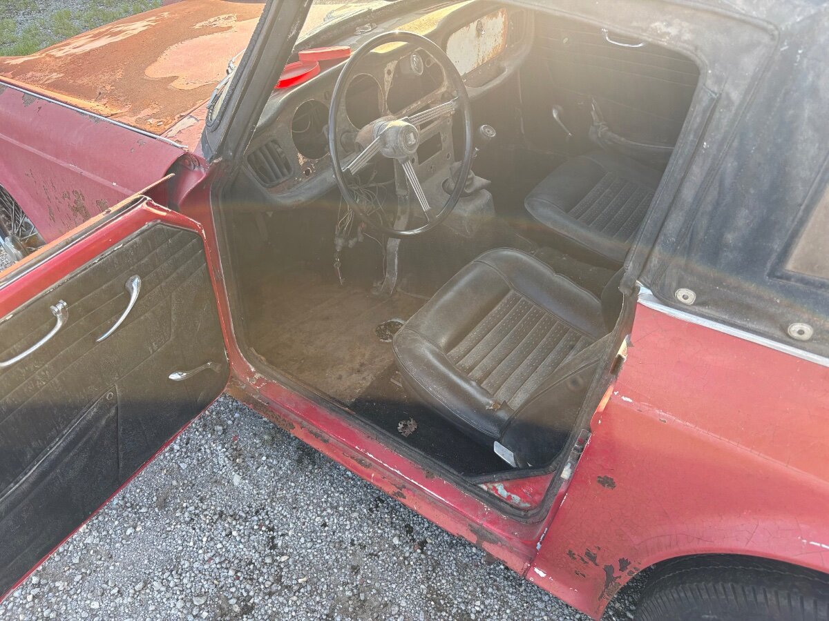

Good project, Marvel mystery oil down the bores for a month and see if that frees everything up, looks like it’s got either TR250 or TR6 seats. Hopefully it comes with a set of dash clocks.
