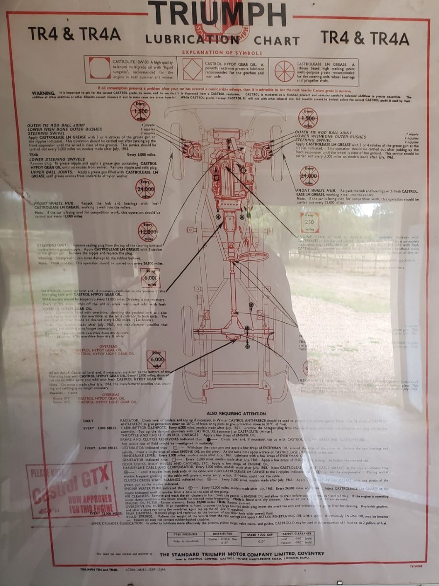

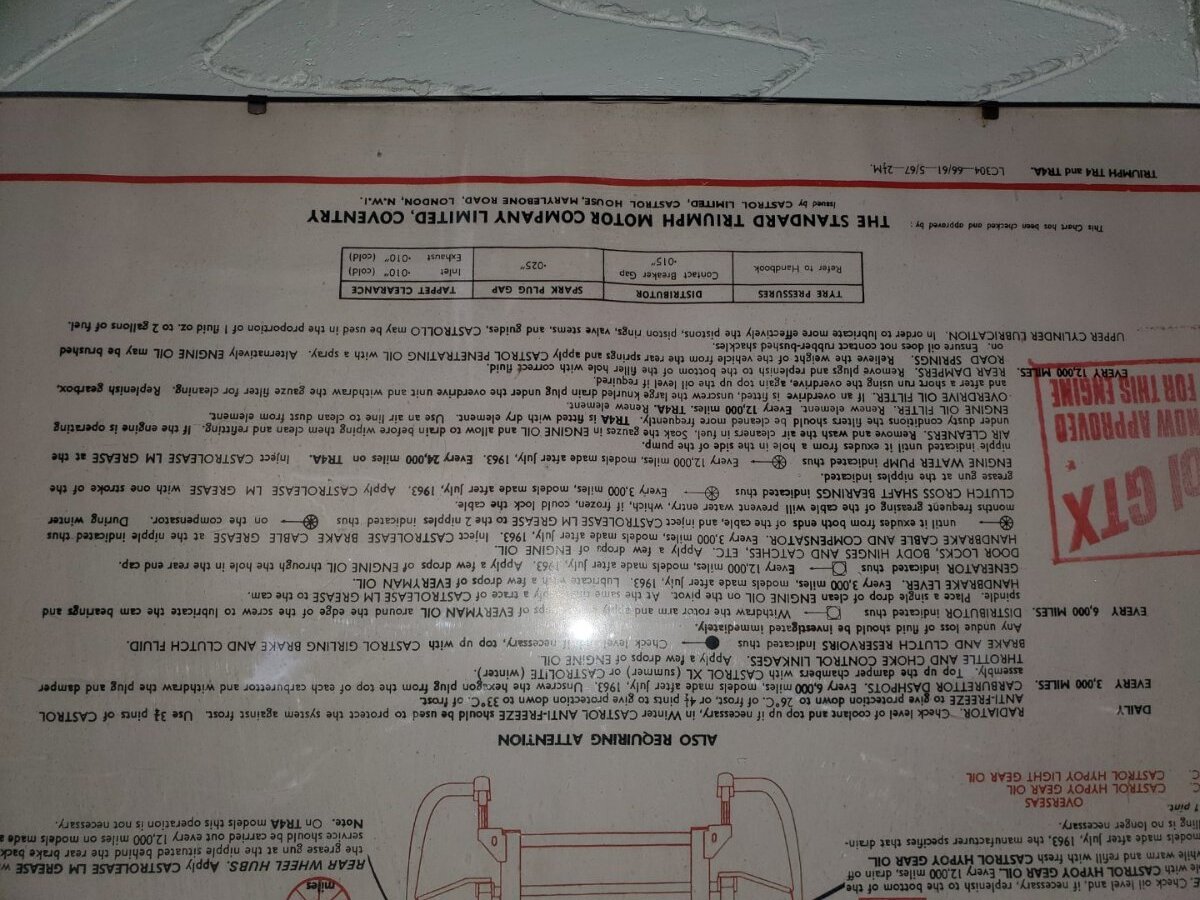

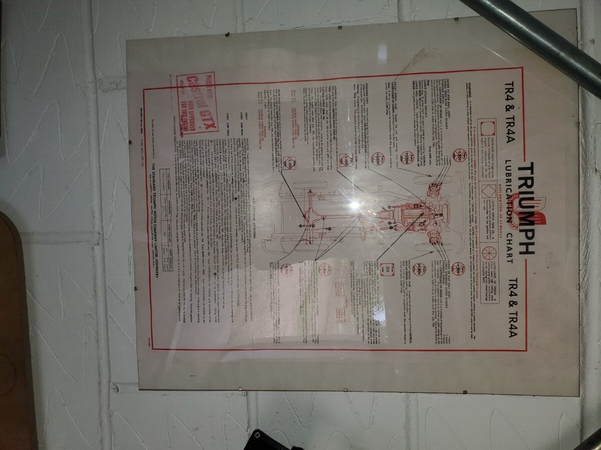

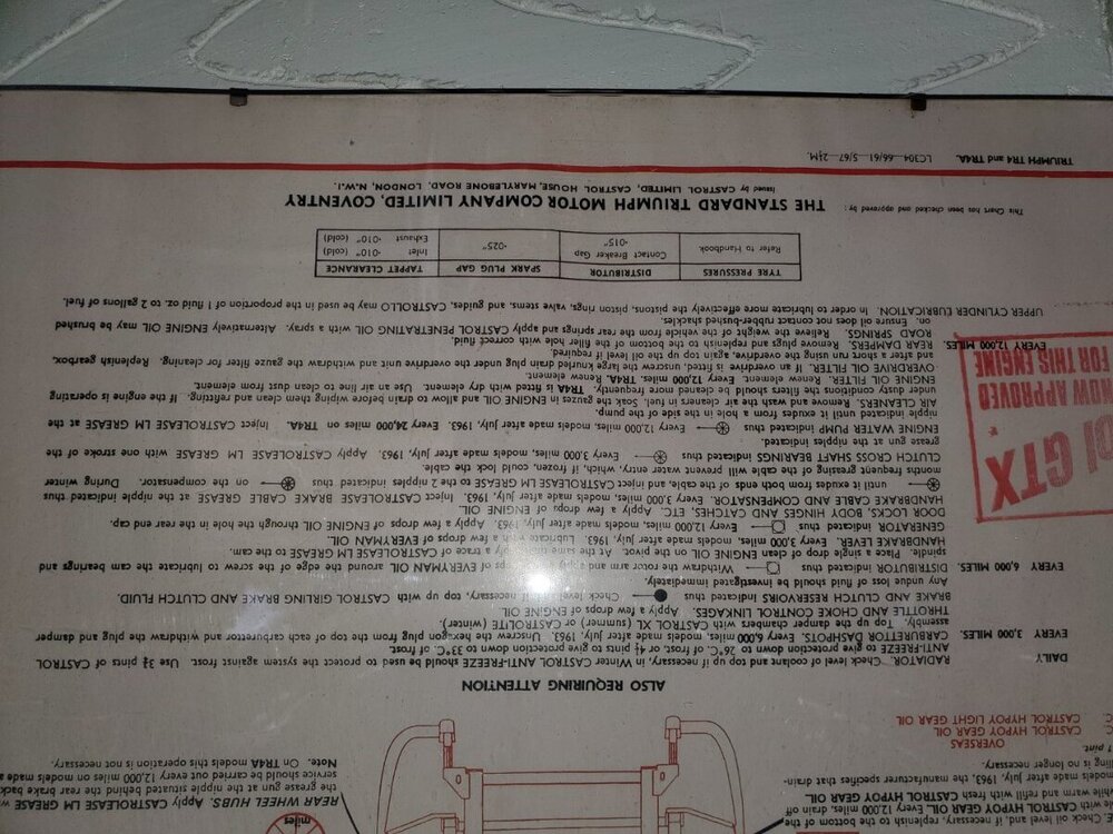

jerrytr5 Posted September 2 Report Posted September 2 This help? Baffling why the software chooses to invert images. Jerry Quote

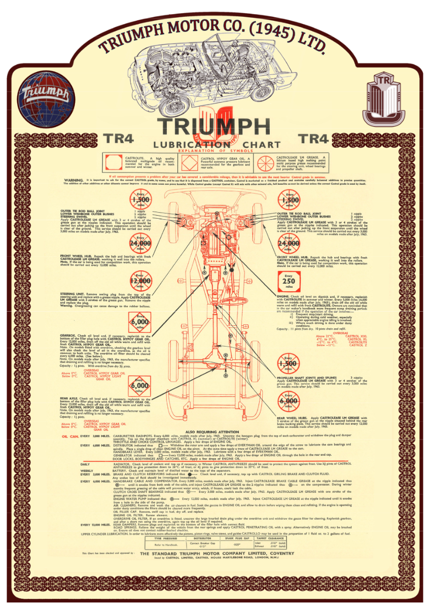

earckens Posted September 3 Author Report Posted September 3 9 hours ago, jerrytr5 said: This help? Baffling why the software chooses to invert images. Yes it does! I lThanks for that pointer, I looked up that chart on internet and found the below on the Swedish TR4 forum: Quote
Dale Moore Posted September 3 Report Posted September 3 We have all the lubrication charts on a pinned topic here Unfortunately the links to the Tr register shop for the pdfs doesn't work anymore Dale Quote
